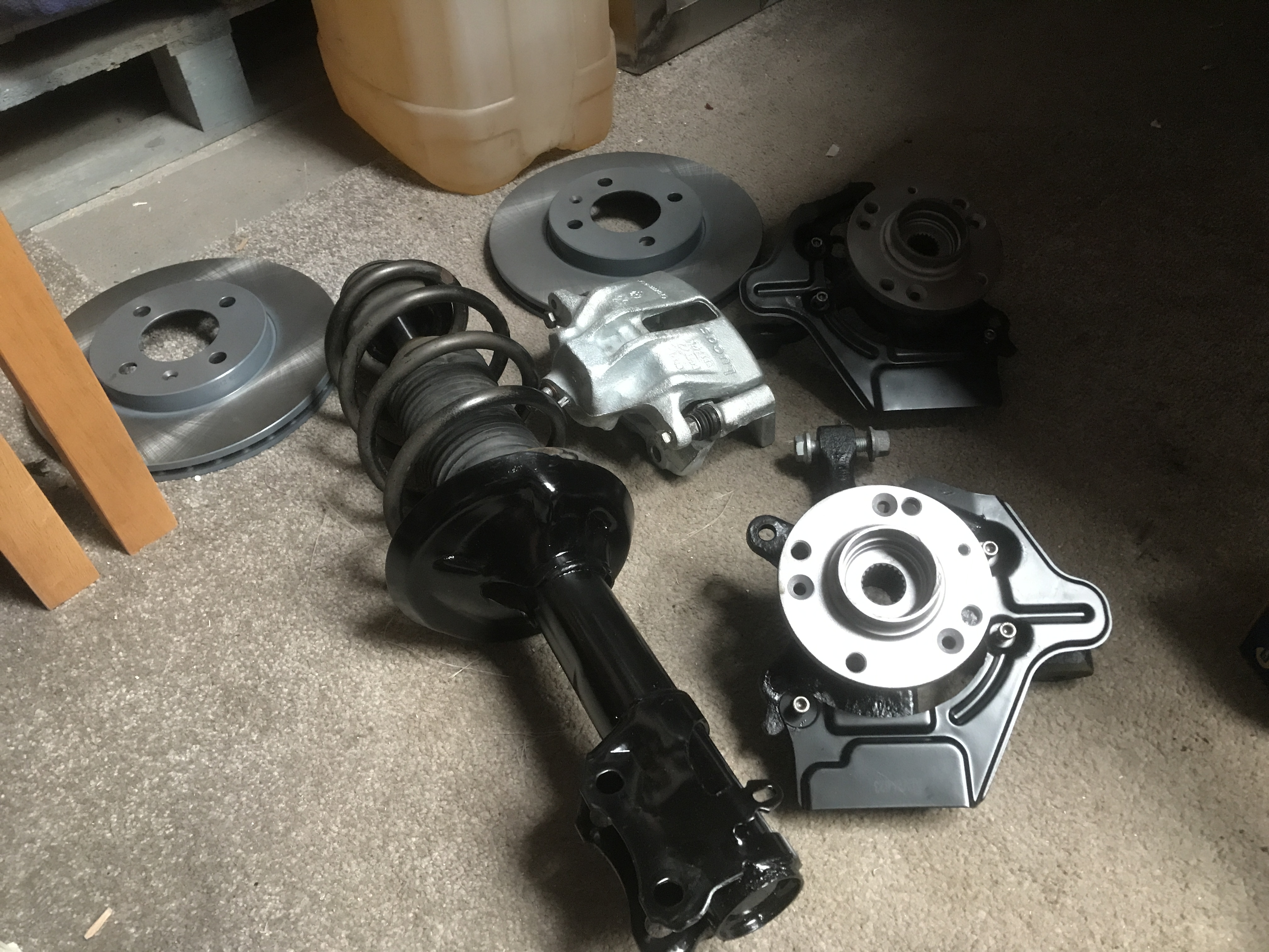

Back home to the ‘Repair Shop’ECBAD943-1620-4B83-8F1B-3A52C6BFE538.thumb.jpeg.7b8e4187e4ac5b07f39b45a99154842c.jpeg
So all back home again inc a strange ‘little cylinder barrel’ obviously not for ’Rossa’...
These will all be 2k black satin after I’ve de-pitted and made good except for the calliper which will go zinc.
‘One step closer’ not really, more like three! 27744372-6C32-4E83-AB1E-2985340FBD85.thumb.jpeg.c1c09f21e92ad3925d5655f93bb5651d.jpeg Prepping for a bit of paint...6904C446-F407-4ECE-8EF8-77F09AAB70B7.thumb.jpeg.901e6d3892a46981ea567f966bb9f6bc.jpeg
My DIY zinc plating is getting better
Hub well on its way........
The alternative spring compressor!
And today is FITTING DAY!
