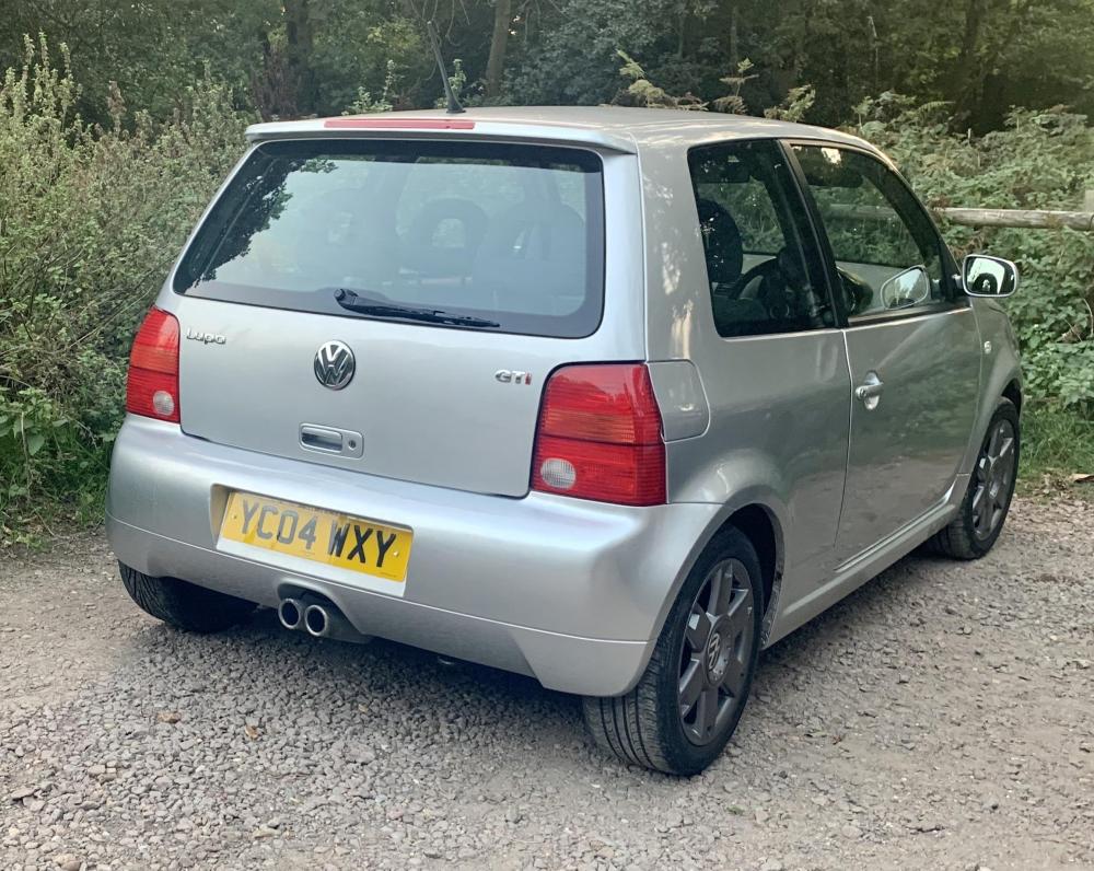

bernd 30 Posted September 17, 2020 Author Report Share Posted September 17, 2020 I get what you're saying. It's also expensive to have enough space in Reading where you can put several cars though... He's home btw. Very Happy boy now! 1 Quote Link to post Share on other sites
mk2 328 Posted September 17, 2020 Report Share Posted September 17, 2020 That is V nice. You are now part of a small elite group. There aren't many GTis left in the Uk. Please look after it Is it the 5 or 6 speed gearbox version? Guessing 6... Red & black stitched interior. 1 Quote Link to post Share on other sites

bernd 30 Posted September 17, 2020 Author Report Share Posted September 17, 2020 Cheers guys! I am chuffed to bits! @mk2 yeah red and black interior, 6 speed gearbox. So, situation report: Bloody hell that little thing is fast! The intake roar is absolutely hilarious. The xenon floodlights are seriously impressive. On the way home from the dealer I noticed that at speeds just slightly above the national speed limit on the motorway a lot of vibration was happening. That was better after I put the right amount of air in the tyres, but I reckon a new set of tyres is probably called for rather sooner than later. There is a squeaky belt situation going on that will need investigating and sorting out before we're off to Scotland in 3 weeks time. Occasionally a noise that sounds almost like a phone dialling tone is happening. Absolutely no idea what that could be?! Few minor things, e.g. of course it needs new wiper blades, the central locking re-locks the car again after 2 minutes or so even if the driver's door has been opened but the engine hasn't been started and somehow the window switch has been wired the wrong way round so the driver side switch opens the passenger side window and vice versa. (that last one is quite funny actually) I am gonna give it a good service anyway as I don't trust anything I've been told by used car dealing cowboys, especially when they include a Eurocarparts invoice for the wrong grade oil as documentation that they've done a service. I mean, what? why? And I'm sure someone can point me in the direction of the threads to read for fixing these things. I am quite looking forward to doing a bit of tinkering... 1 Quote Link to post Share on other sites

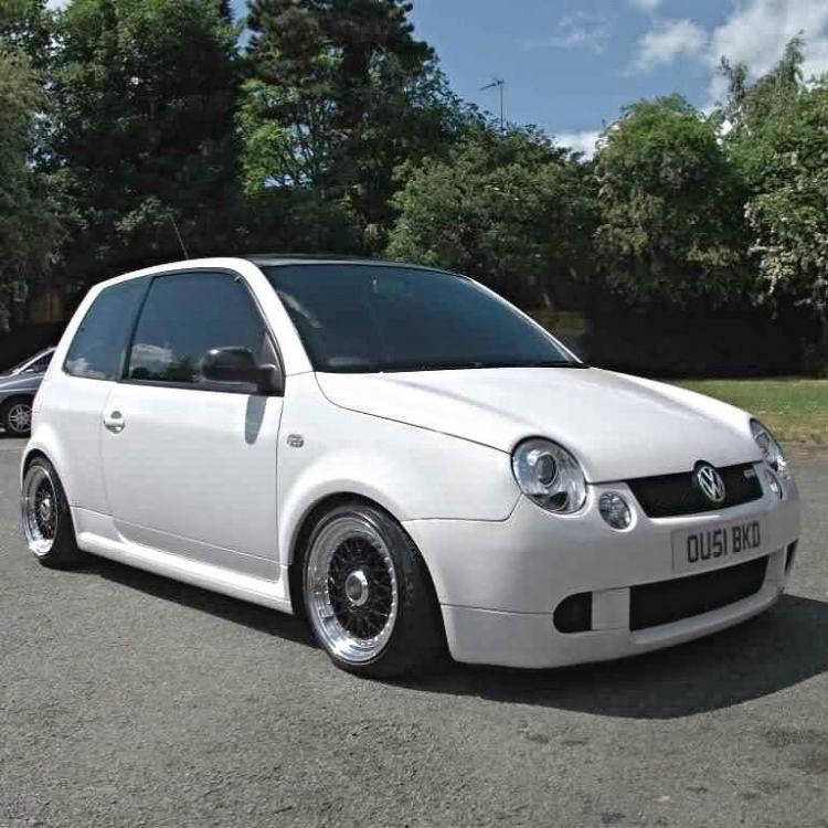

Dom's dub GTI 2 Posted September 19, 2020 Report Share Posted September 19, 2020 Hello mate looks a lovely car! I’ve just started to look for another GTI after 10 years since I had one. How much did you pay for that if you don’t mind me asking. Here’s a photo of my last one (I’ve owned about 5 in the past) 1 Quote Link to post Share on other sites
bernd 30 Posted September 20, 2020 Author Report Share Posted September 20, 2020 Brilliant. @mk2 loving the advanced level geek information 😁. @Dom's dub GTI Is that a black roof? I do like a black roof! I paid £4000 for it. I thought that was reasonable given that it only had 2 previous owners and is completely oem spec. (Apart from the shoddy repairs of course.) I had a good poke around this afternoon and it looks like several people have just poured oil in the general direction of the oil filler neck, so obviously the aux belt was very oily indeed. A sprinkling of talcum powder later and no more noise. Hurrah. I like an easy fix. On the other hand side, this sort of sloppy carelessness does annoy me. Why not just use a bloody funnel? I also don't understand why all 4 wheel centre caps were put on without aligning them with the notch in the wheel. 🤬 My theory regarding the rattling dashboard is that Mr Lazy the mechanic had for whatever reason removed the middle section and presumably there's a bolt that's a bit awkward to reach and he couldn't be bothered to do it up again properly. I have ordered the german equivalent of the Haynes manual off Amazon and I will investigate. I've also ordered a wiper switch and a GTI lanyard for my keyring. And I've booked it in to have 4 new tyres fitted. I've decided on Hankook Ventus Evo 2's in 195/50 R15. I had them on the BMW and they're nicely grippy and not too noisy, and almost £30 cheaper than Toyo's. That should be all urgent matters being addressed for the moment and then we'll see how we go... Well, I'm thinking of paying someone to do the cam belt and water pump rather sooner than later. And replacing suspension bushes at some point... I might also take the cd changer out and replace it with a pocket. I'd like to hide a bluetooth receiver somewhere to work with the VW radio for listening to Spotify and potentially a wireless phone charger. I did have a similar setup in the BMW. And hopefully when the dog has a bit more practice he'll stop being extremely awkward and just jump in and on the backseat. (Mmmhh yeah, probably not) If this looks like I'm listing fault after fault, don't get me wrong. I'm very very happy with my little Lupo. It's as brilliant as I imagined it would be. It just needs a bit of TLC to make it better. 1 Quote Link to post Share on other sites
