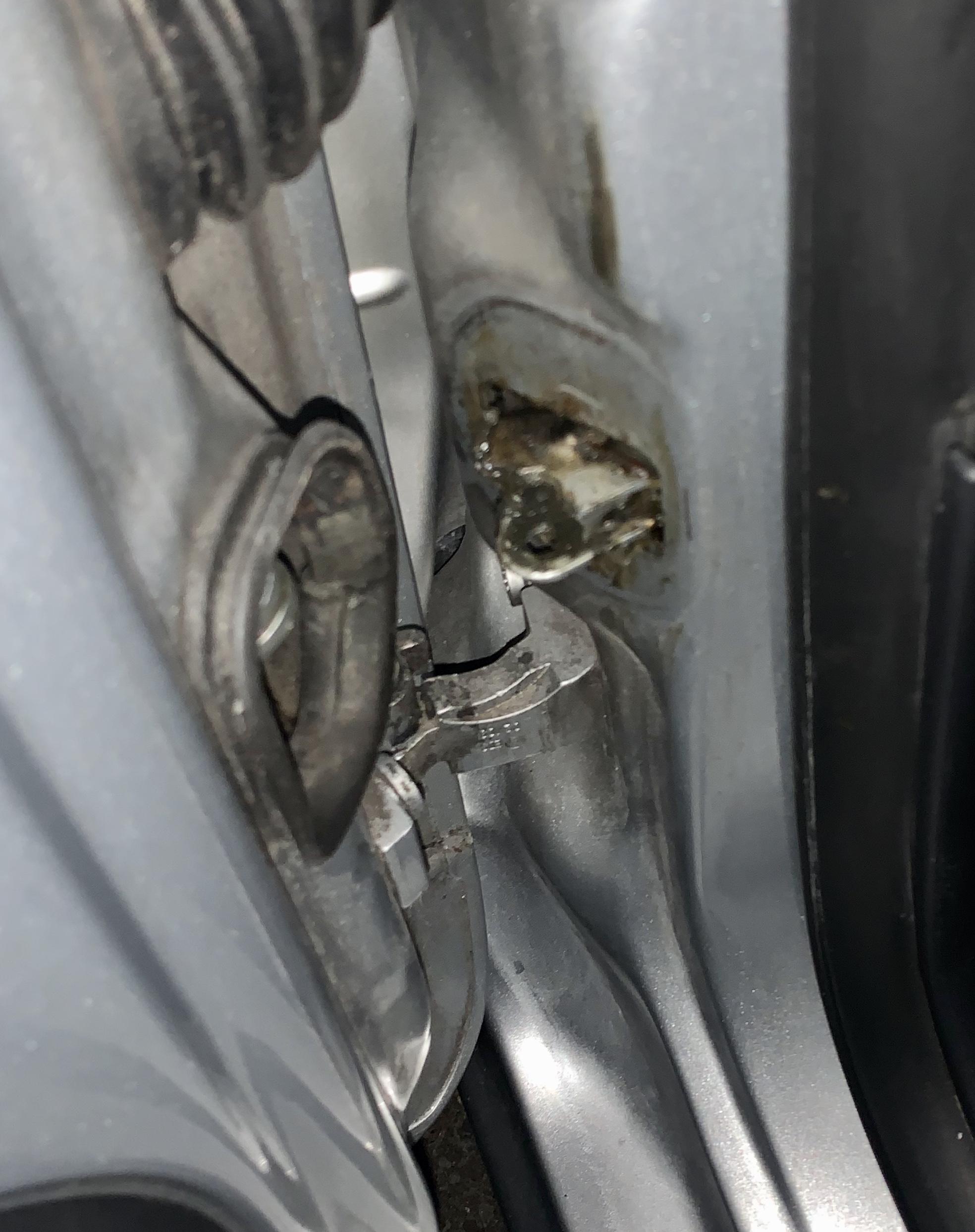

I can't make out if the top loop is only half there? Looks like the lower one is ok though. If the top is only half there, I'd just weld a bit of sheet steel back on, clean up the weld mess then touch up with some paint. Only trouble is that everything will need to be protected from welding and grinding sparks which destroy plastic, glass and fabric... almost a case of a full strip out just to fix it.
Ah, just had an idea- you could fanricate an L shaped bracket that matches the lower one. Then with two steel rivets, place it directly above the broken top loop. Not OEM, but would work?
Yeah, the top loop seems to have snapped in half. I like your second idea better, in fact I have been thinking along similar lines. I'm not really bothered about OEM or not, I just want to prevent the door falling off. I'll share when I've figured it out.

Having now looked at what you're referring to as the a pillar loop I can concede you're slightly ****ed unless surgery is an option.
It appears to be something which is put in place during construction and the only way is surgery to remove part of the inner skin.
Looks weld-able to me - suspect it will be a PITA to do.
Likely it will need the door taken off,  a donor part from a scrap yard - hack saw to get as much of the part as possible.
Cut back the damaged section to a straight line of not stretched metal just past the damage:
and weld the replacement section back on - the good news is the lower good part will help match up and align the replacement bit.
Right, I still haven't decided what to do with the door catch strap. I have been told that door hinges from an Audi A6 C6 are a straight swap, which would make the whole catch strap redundant, so I'm looking into that...

I've also done a temporary bodge on the broken door-strap-bracket using a M6 bolt, a washer, a bit of rawlplug, some heat shrink and a lock nut. That appears to be fairly stable, and it looks like welding the washer to the remainder of the bracket would solve the problem permanently. I am still looking into swapping the hinges for ones with integrated catch mechanism. I did have a rummage around the scrap yard and predictably they appear to be the same across the VW Audi range. I couldn't actually take one off though because of a lack on giant torx bits.

Yeah, for the first time the other day, I dismantled the door strap mech/pin. Just curious.... Anyway, it's not a straight forward pin or bolt thing.
For some really really wierd reason, vdub have decided to make that bolt a double threaded "pin". So the top of the bolt (or pin), just under the head has an M6 thread and the end of it has a few mm of M4 thread. So both ends of the bolt are threaded, with a smooth bit in the middle. What a stupid design! I get why they fail now. When you tighten it up, the top and bottom part have to be in lock step together or you get one turn out of thread. AND, if the space between the top and bottom bit is out, you'll mess up the thread. Mad. Why didn't they use a V notch with step, like you get on plastic engine fittings... I dunno (shaking my head here).
I can't think of an easy fix that will work quietly and reliably. I measured the strain on that pin, and it's huge. Like momentary 250kg. A regular bolt wont do it. Ok, so maybe a 10.3 strength bolt, but yiu still need a smooth rod section, or the thread will simply eat away at the new loop. Heat shrink or other inserts would be a complete waste of time with such a high loading.
That overspray- sounds like a side swipe that was fixed in the car's early life?
It looks like you answered your own question there. I suppose if the bolt is threaded into both sections, that huge load is distributed evenly between said brackets... But yeah it was a pita to get the catch strap from the fully closed position to the fully open one. I had to use a g-clamp and lots of swearing. I think I’m still in favour of doing a hinge swap. I will borrow a giant torx bit from next door and make my way over to Wokingham again (or possibly eBay).
