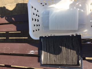

Started off replacing the air and cabin filter. Looking at the comparisons below, they don't look like they've been changed for a very very long time or ever!
