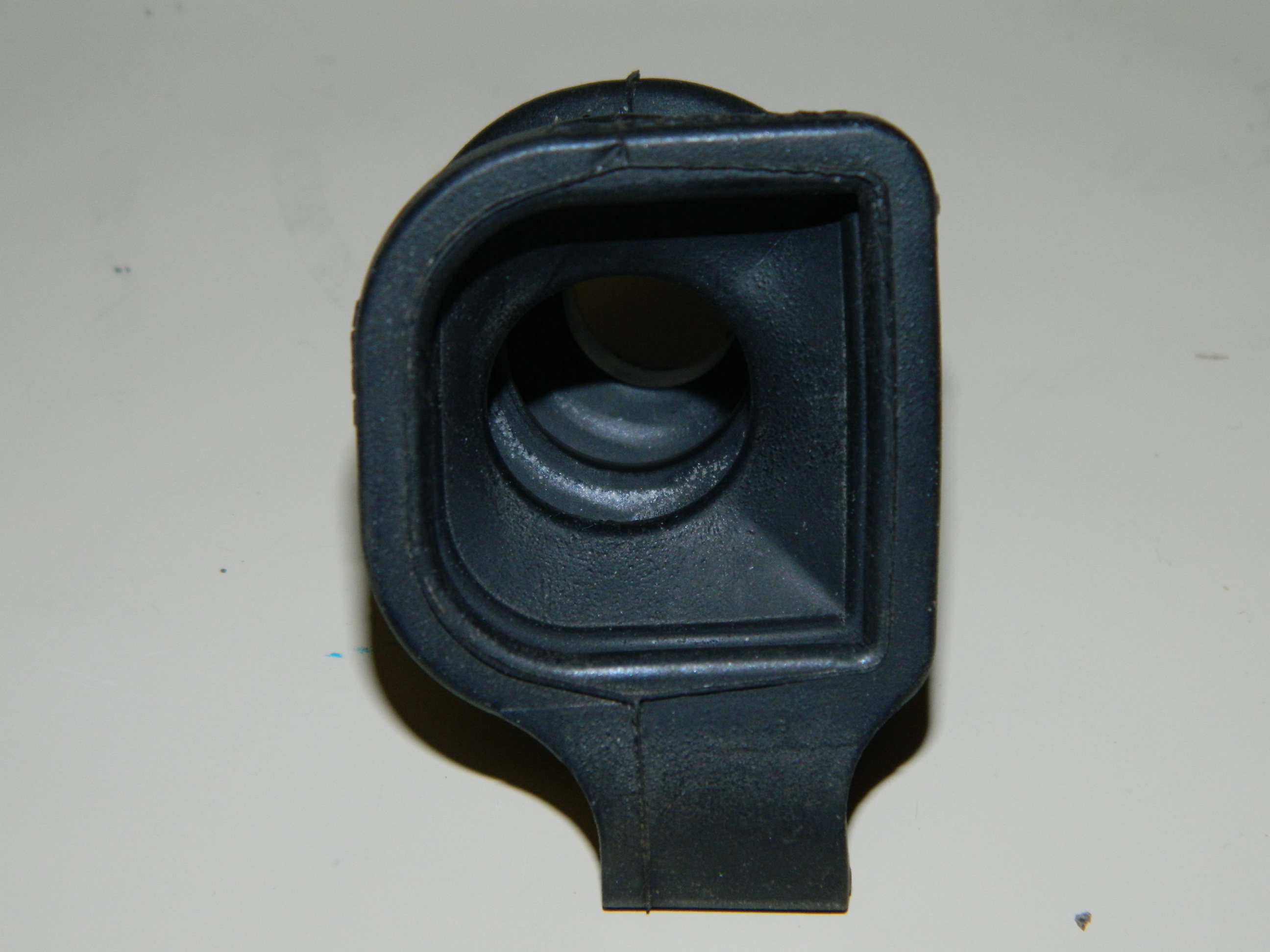

I have the very last EVER one left (according to vdub database)! Yay!
Now, I wonder if anyone has any good ideas how we can make a mould from this one without destroying it? I don't need to fit it just yet, so once we have a way of copying it out of silicone or polyurethane rubber, there will be more available for the world (ok, mainly Lupos with 085 gearboxes I'm guessing). I dunno much about mould making. Anyone?
Admire the last one ever...

The inside part of the mould I made with a steel tube and fibre reinforced epoxy resin (chemfix). Very smooth surface.
The two outside halves are made using sand and cement. Very strong but a few tiny air bubbles. I tapped the soft cement a lot to get most of the air out, but there are still some tiny holes. Maybe the beeswax will fill them. You can still see the part number in the cement! 👍🏻
