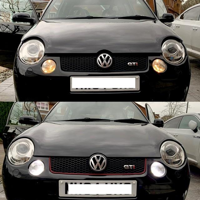

Ok so here is a photo of the car and the headlight mod.

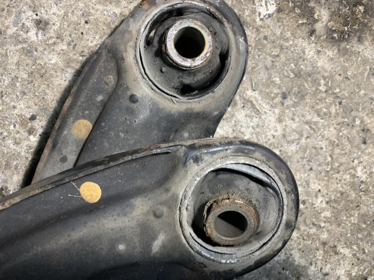

That being said, look at the state of the rear wishbone bush, I worry if this car had an MOT back in June with no advisories.

These bushes aren’t even seated in the arms; they were completely loose. Worrying they weren’t listed as an advisory as they’re just completely dangerous.
Edited by cj1
MOT rules are- so long as there's no "excessive movement" or "metal to metal" contact, it will pass. But yeah, I've pulled out control arm bushes where the centres just drop out, but still pass. Unbelieveable.
Apart from the bushes, those arms look like they're in great condition.
I always cut mine out with a jigsaw... One cut in the ali outer rim and they just drop out. Quick. Then to the local gearbox place armed with either a tub of roses chockies or a 6 pack of ale (depending on time of year) and they let me use their press.... :)
I would have expected the tester to have at least covered their arse by putting them as an advisory.
