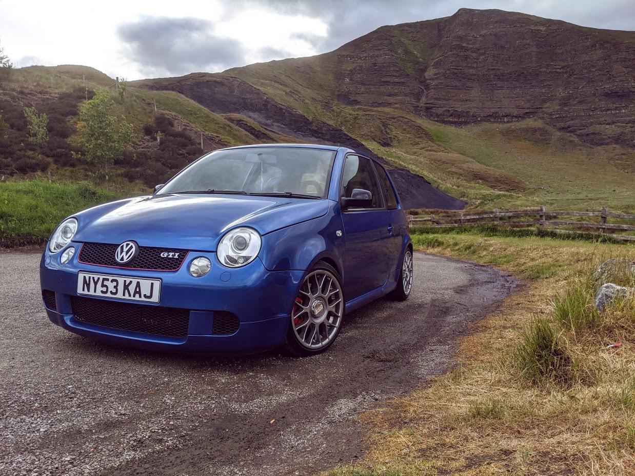

Few more pics from the last few weekends adventuring...
Freshened up the engine cover as it was looking a bit tatty. Also modified it so it would fit over the induction piping, much prefer the engine bay with the engine cover on. Still need to repaint the power steering reservoir bracket 🙄
