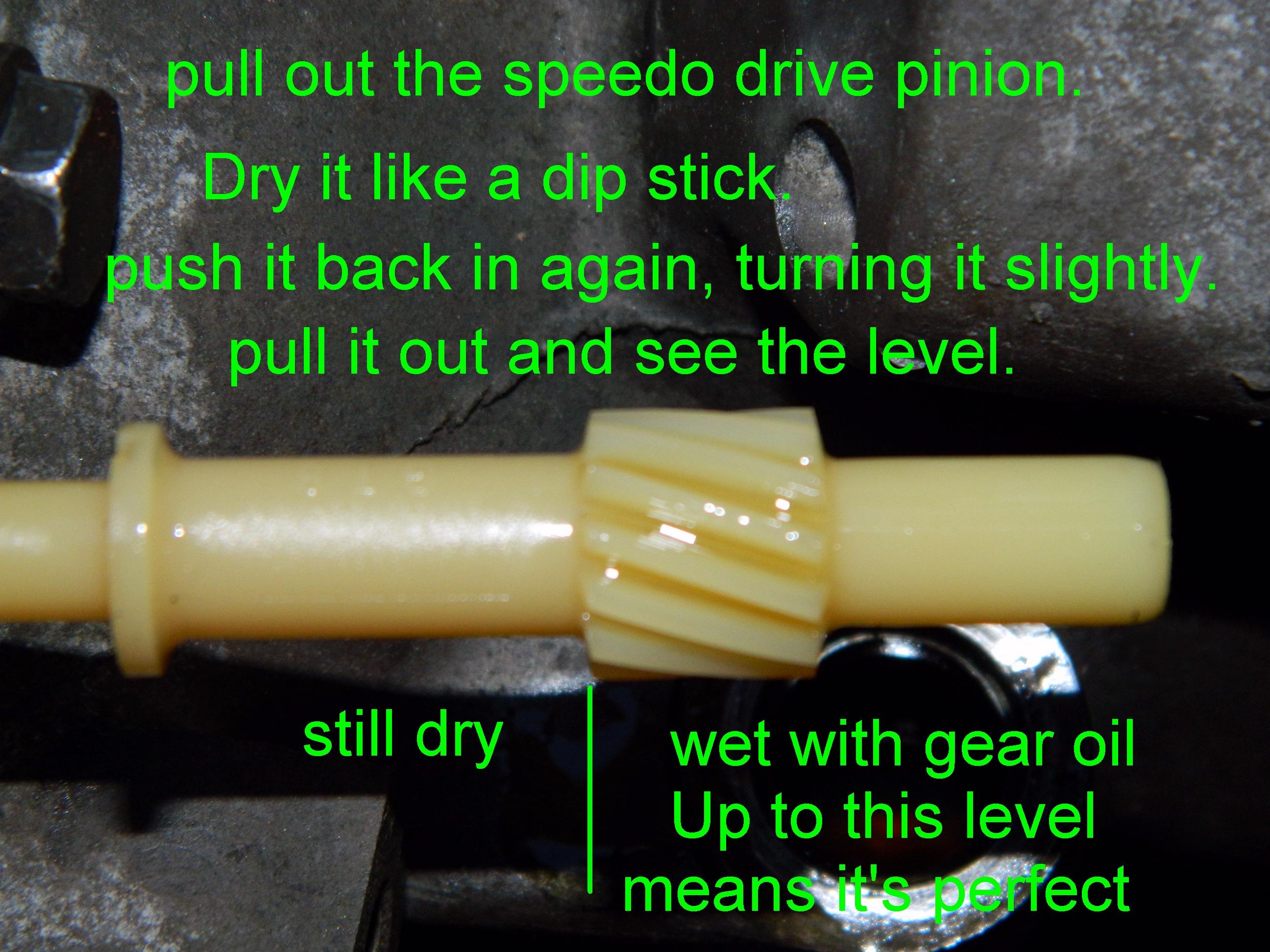

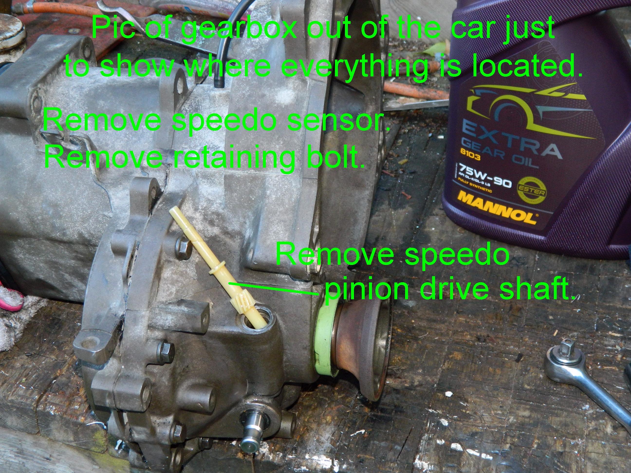

mk2 Posted September 25, 2025 Report Share Posted September 25, 2025 Thought I'd add an update to this ancient thread, as I've just had the last of my Lupo's gearboxes rebuilt (new seals and bearings just in case). This one had done 160,000 miles so far. No noises, smooth gear changes, all good; but for £120 for a rebuild kit and £50 cash and some beers to the local gearbox place, it's peace of mind for the next 150k miles... While out, I thought now is the perfect time to show how to do a gear oil level check, without even needing to get under the car. You can do everything from above through the speedo sensor hole (topping up too). Unclip the speedo pickup cable. "Carefully" unscrew the plastic speedo pickup sensor (I use a pair of mole grips). Using a socket, unscrew the retaining bolt, then pull out the plastic speedo drive pinion. See pics. Reverse to refit everything. It's worth cleaning around the pickup before starting to avoid any crud falling into the gearbox... Crud in gearbox = not good. Quote Link to comment Share on other sites More sharing options...
