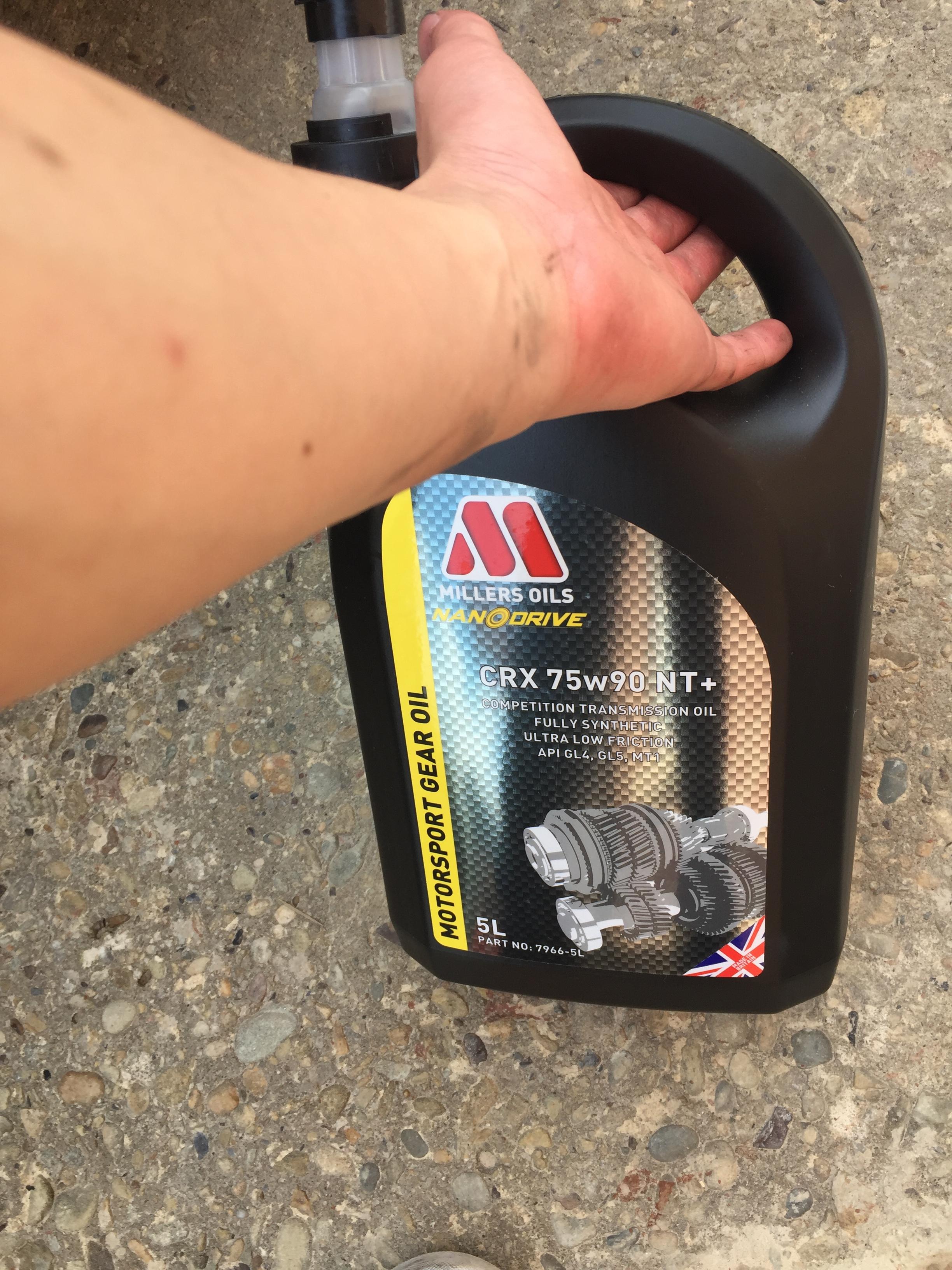

Adrian777 Posted June 13, 2020 Author Report Share Posted June 13, 2020 Gearbox Oil today! Used this stuff! If anybody is looking to buy Millers Oil for cheap, check out ID Workz, performance part shop local to West Yorkshire but sells Millers Oils a lot cheaper than Opie, etc. Anyways I had a good laugh/cry when I drained the box to find about 20ml of oil came out, there is an end cover sealant leak which will be addressed asap. Box feels and sounds a lot better now however. Quote Link to comment Share on other sites More sharing options...
