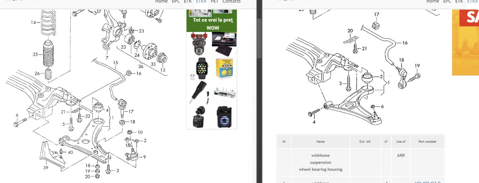

lupogtiboy Posted September 30, 2024 Report Share Posted September 30, 2024 If you need the wishbone bushes (number 2 in the picture below), these are the same as any Lupo, 6N0 407 181. Obsolete from VW now, but most decent motor factors will sell them. Quote Link to comment Share on other sites More sharing options...
Tudy Posted October 28, 2024 Author Report Share Posted October 28, 2024 I need the whole piece, the problem is that I can't find the 3L aluminum arm anywhere, only the 1L steel ones. I would like to make a conversion, I understood that you would need an engine frame, arms and stabilizer bar. Does anyone know if it can work? Thank you Quote Link to comment Share on other sites More sharing options...
mk2 Posted October 28, 2024 Report Share Posted October 28, 2024 There's no separate front bush (that bolt 4 goes through) on that drawing. I'm guessing that the whole arm assembly is different to the regular flavour? Quote Link to comment Share on other sites More sharing options...
lupogtiboy Posted October 29, 2024 Report Share Posted October 29, 2024 3L's (and the 4L FSI equivalent) are quite different in a lot of ways, these wishbones are made of aluminium if I remember correctly, same as the subframe. That's probably why you can't get the bush that bolt number 4 goes through on it's own... Quote Link to comment Share on other sites More sharing options...

mk2 Posted October 30, 2024 Report Share Posted October 30, 2024 I just noticed that the ball joint on that control arm is integrated into too. They must have stamped the whole thing together in one hit. Makes suspension alignment easier I guess. But the subframe HAS to be fitted super accurately compared to the regular steel type which is slotted and has big washers. Just a mm out and the whole car would be crabbing. I wonder why they opted for that system compared to the regular steel type they use on most other vdubs (and regular Lupos)? Can't be weight, as it'd save only two or three kg at best. Ali being a lot weaker than steel means the structure has to be a fair bit thicker. Anyone? Quote Link to comment Share on other sites More sharing options...

mk2 Posted November 2, 2024 Report Share Posted November 2, 2024 Isn't it just. So just to save about 2kg and provide a wider track!? Next time (if ever) I drive a 3L, I'd better remember to not eat that curry to make that weight saving count! And defo not brim it when refuelling. SMH. On my SDIs, the wheels are flush with the bodywork, so I think that that's just the marketing dept talking... So an extra component for the sake of it. And being ali, bolted directly to steel, we all know about electrolytic corrosion caused by salt. Nah, I prefer the steel flavoured setup. And all the bushes/joints are easy & cheap to swap. Thanks @lupogtiboy 👍🏻 Quote Link to comment Share on other sites More sharing options...
