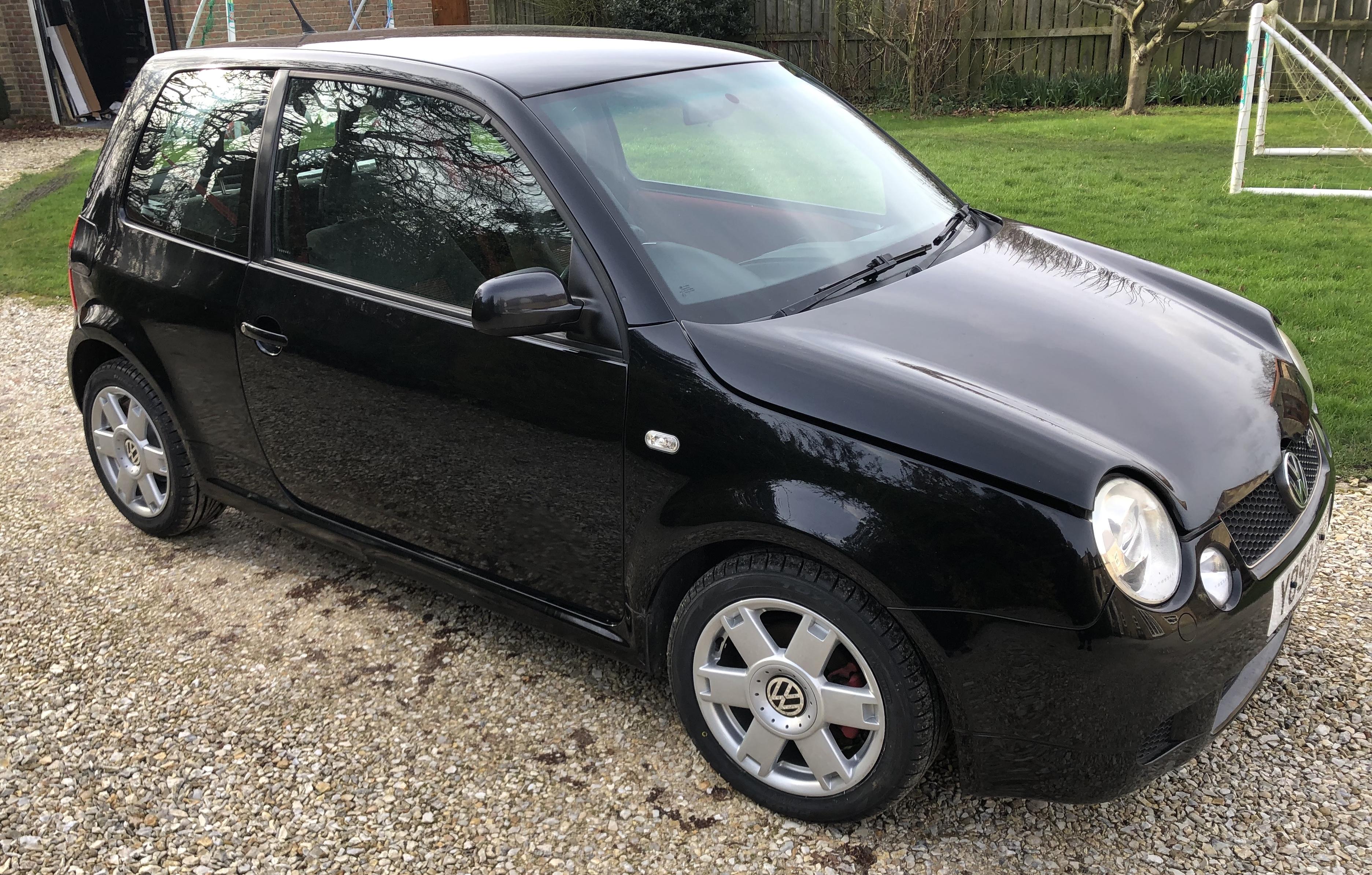

The resurrection continues.

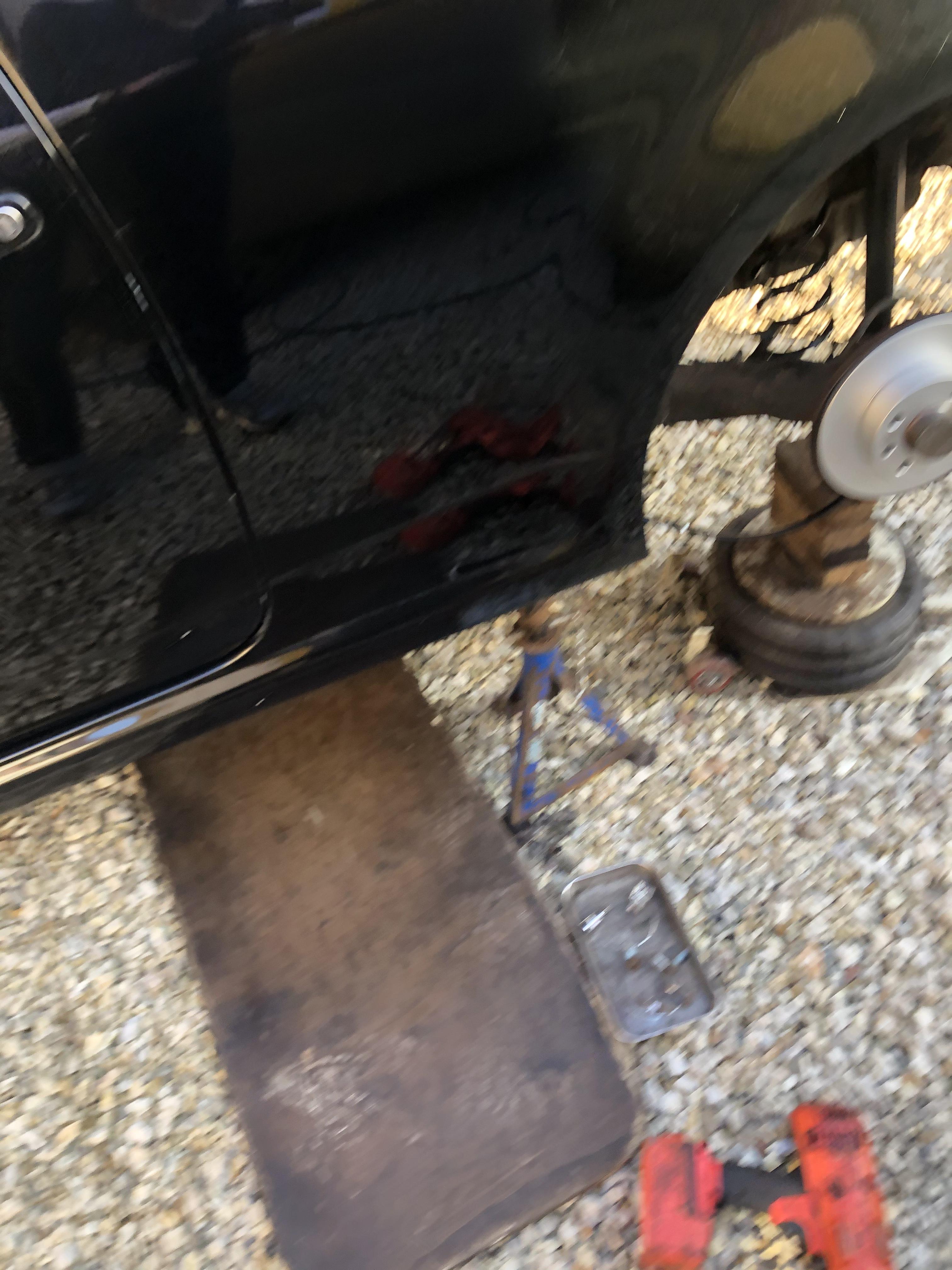

All mechanical issues resolved, head has been resealed which has cured an oil leak. All front end shocks, springs and top mounts have been replaced along with passenger front stub axle which was bent.
The water pump and cambelt have been changed. Oil /antifreeze/coolant all changed.
It has meant that all 4 refurbished Bathurst wheels are now fitted.
Once the tracking is sorted out. Next stop will be the body work. There’s a replacement rear bumper/spoiler that need a respray (currently in silver) and a towing eye cover and passenger wing mirror cover that are in primer.

Not sure why, but it just looks way better than my black SDI. Must be the shape of the frint wings or something. Nice.
This Lupo is having tracking done today (massively out on the front due to bent stub axle) this has been replaced and tracking adjusted by eye so it can be driven, also having the MOT done. Should pass as practically everything that was a potential fail area has been replaced.
