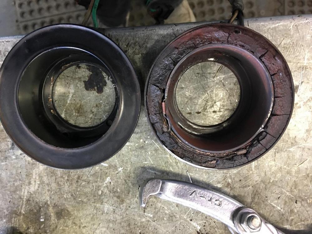

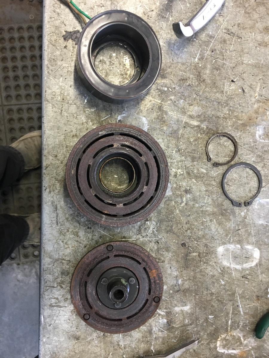

I made the decision to go with the original AC compressor, not that the used one would not work, it's just that the original is tighter and not many miles on it. I changed over the coil and clutch.
The clutch was pretty rusty but I cleaned it up and think it will be ok. The compressor is back in the car now and just need to recharge the system.

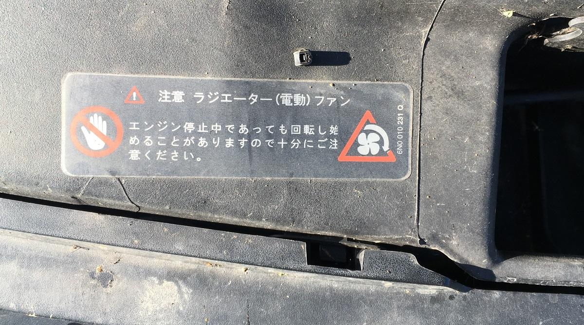

There's typically an AC sticker on the panel next to the bonnet (hood) lock, just above the radiator. It tells you the system capacity 750g type of R and +50 or whatever amount of oil in grams to add.
Now I believe that due to how badly burnt the clutch coil was there is a possibility there is a bad fuse somewhere. The ones on top the battery look good, I pulled a couple from the panel in the parcel shelf but they look fine. Just have the symbols to go by as the owner's manual is in Japanese too. Anyone know which fuse it is? 26 was my best guess and it looks fine.

If you send me a picture of the Japanese writing I will translate it for you. Make sure it’s super clear tho - this is also me being deadly serious x
Obviously that sticker is telling you not to stick your hand down where the cooling fans are.
