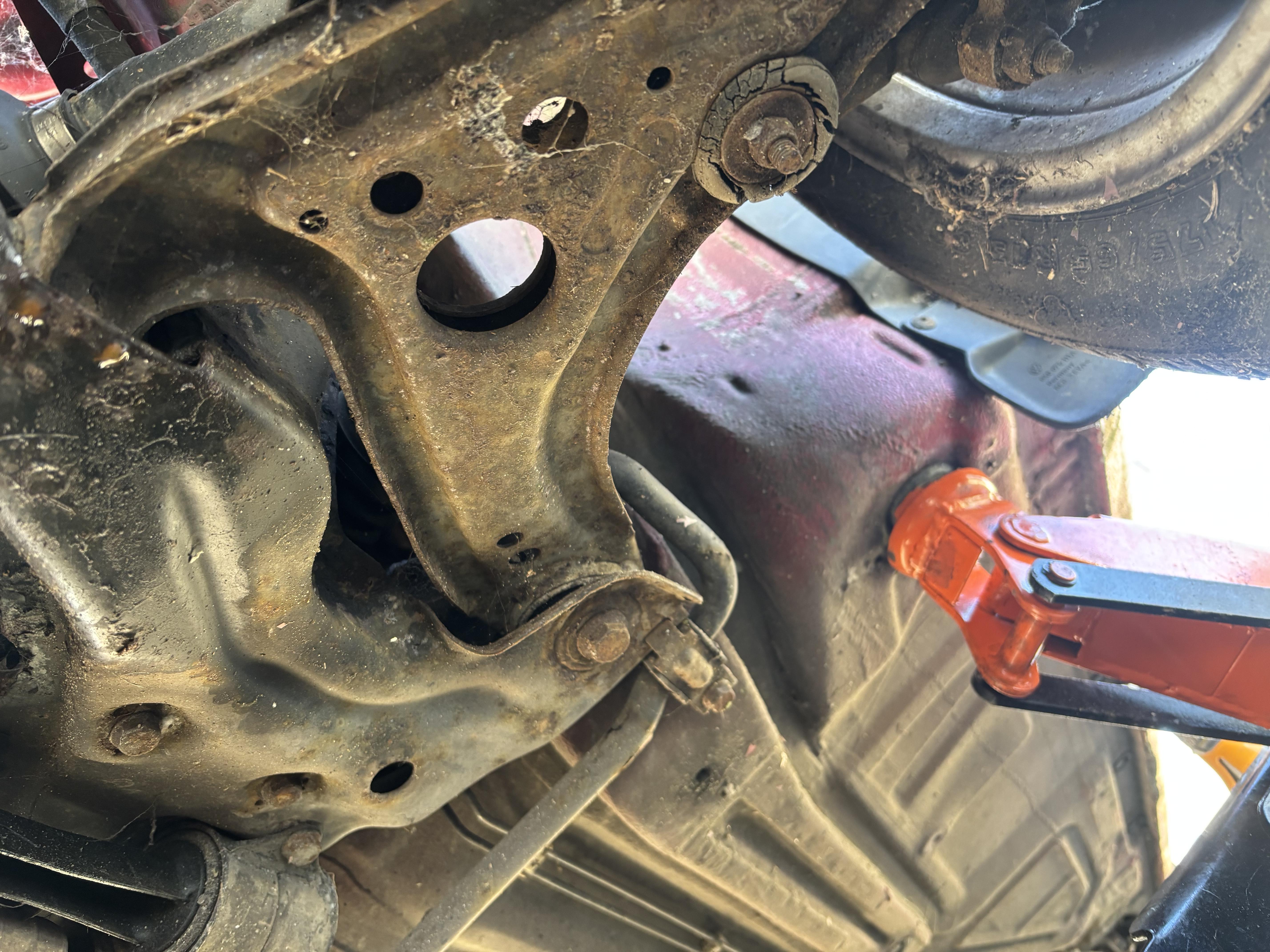

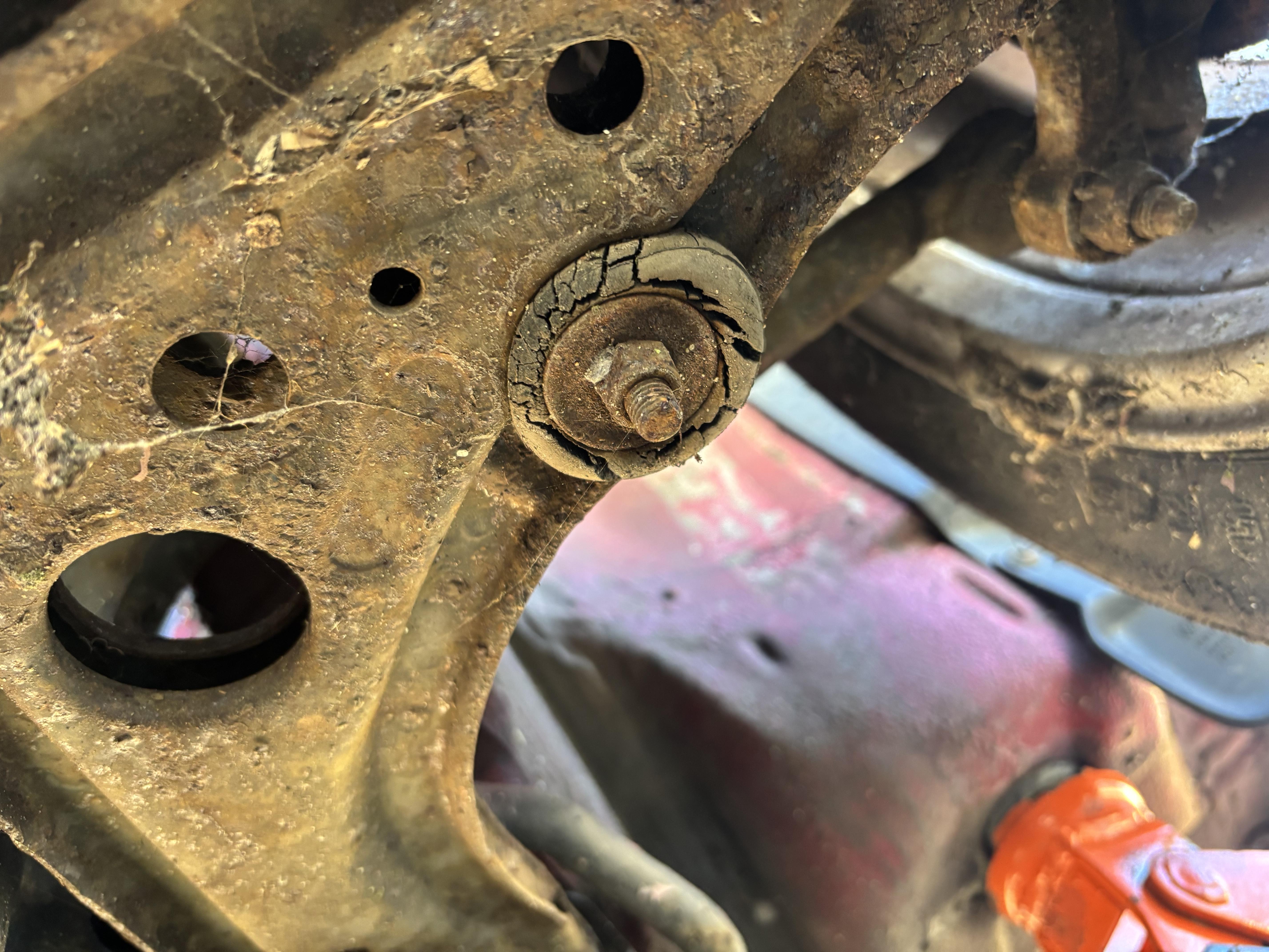

JedB Posted March 13, 2025 Author Report Share Posted March 13, 2025 @tigcraft @mk2 @Rich @ObjectiveAway @amgeriz Thanks for your help - so glad it’s running. Flushed all the fluids and changed wipers. I can see I have a perished bush on the wishbone which I initially thought was a droplink, can anyone please use their expertise identifying? Also this white part of the exhaust looks worse for wear, wondering if I buy this whole set of exhaust from eBay, any advice appreciated as smoke is escaping. I am now going to trawl the forums and youtube on changing aux belt, I think cam belt and water pump will be in order too but at a garage but then we should be ready for an MOT! 1 Quote Link to comment Share on other sites More sharing options...
tigcraft Posted March 13, 2025 Report Share Posted March 13, 2025 It’s the anti roll bar link bush. Please please please use a bit of thick 6”x 6” plywood to support the car and not like you’ve done as old cars are thin in those corners!! 1 Quote Link to comment Share on other sites More sharing options...
mk2 Posted March 13, 2025 Report Share Posted March 13, 2025 OMG! Don't jack it up there, it'll go straight through the floor! Not a jacking point... The right place is on the sill triple edge, just below the little arrow marking. Hope the floor pan is ok after this. There's very little rust under the car. I'd get the whole underside pressure treated with waxoyl or similar to keep it looking that good! Yeah that's just a down pipe, with some heat wrap around the flex joint I'm guessing. Go for Ernst, Walker or Otto brand exhaust bits. Autodoc? And like @tigcraftmentioned, anti roll bar drop links. There are two sizes. Make sure you get the 18mm hole...(not Gti). 1 Quote Link to comment Share on other sites More sharing options...
JedB Posted March 13, 2025 Author Report Share Posted March 13, 2025 (edited) @tigcraft @mk2 Thankyou both so much. I did have an axel stand under too before going under, I see the triple sill now, thanks alot, appears to be no marks where I jacked. I have found the anti roll bar drop links, hopefully they are simple and a couple of bolts. Once new tyres are on tomorrow I can drive onto my little plastic ramps which I much prefer (with a couple axel stands, wheels chocked etc). I will have a look at Waxoyl - was going to buy the hammerite black paint to touch up alot of areas. Thanks so much guys - really feeling better about this car for my sister - knew it wasn't scrap as some people advised her - done £160 on 4 brand new 13" tyres, £90 fuel pump, £25 on wipers, £16 coolant, £25 fuel filter+spark plugs and now exhaust and drop links all seems well worth it considering when I owned the car I had the pedal box removed and refurbished and various other labour intense jobs. Edited March 13, 2025 by JedB 1 Quote Link to comment Share on other sites More sharing options...
amgeriz Posted March 14, 2025 Report Share Posted March 14, 2025 (edited) Glad you have it on the road again! It's a little bit tricky to mount this arb lower bushes first time, it helps if you do it with one side attached, so you can compress the new upper side bush lifting the wishbone, to be able to thread a little by hand. If you change the entire droplink, vaseline or silicone grease on the arb helps a lot. Check the position too, because they are offset. Edited March 14, 2025 by amgeriz 1 Quote Link to comment Share on other sites More sharing options...
