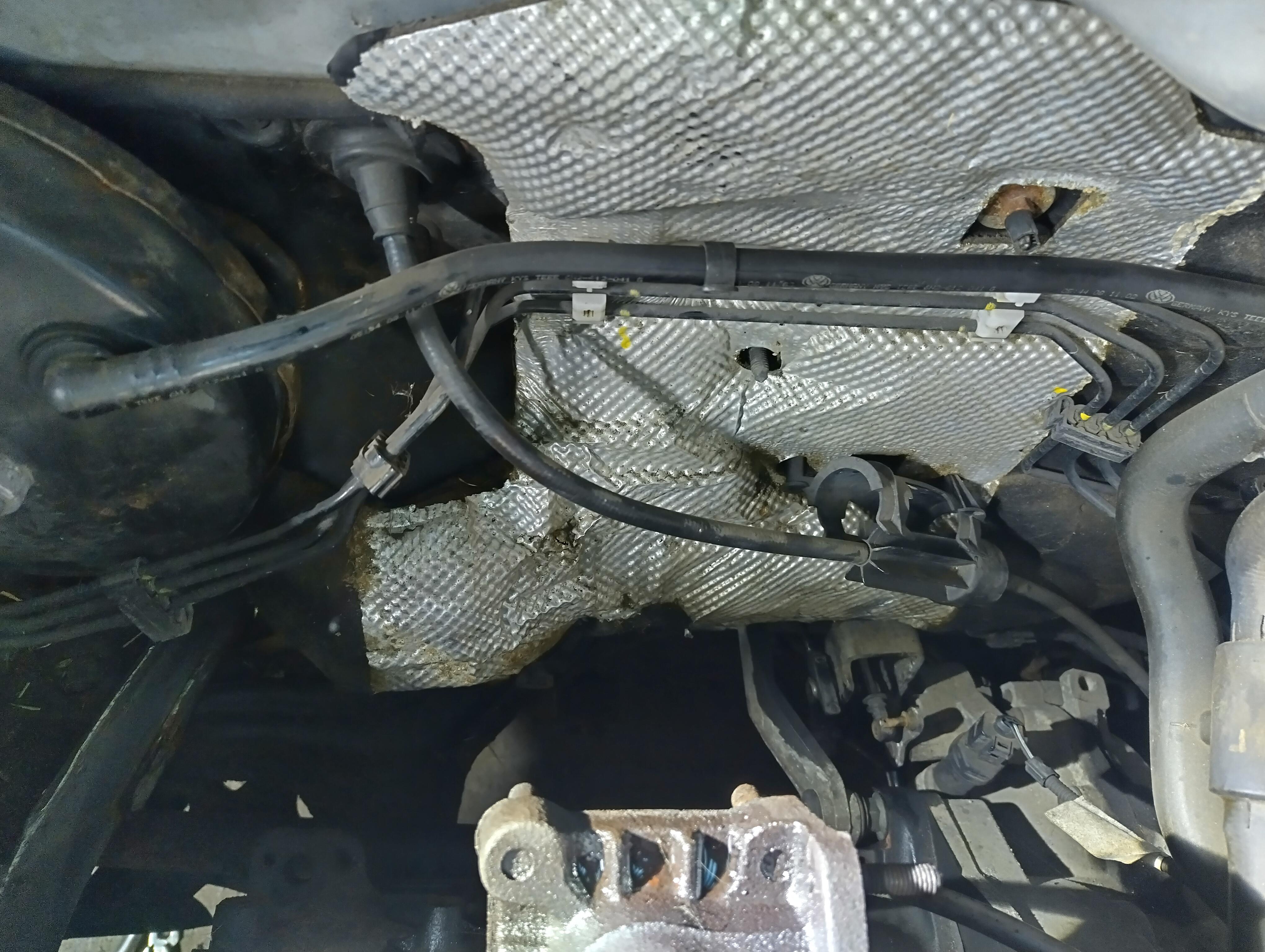

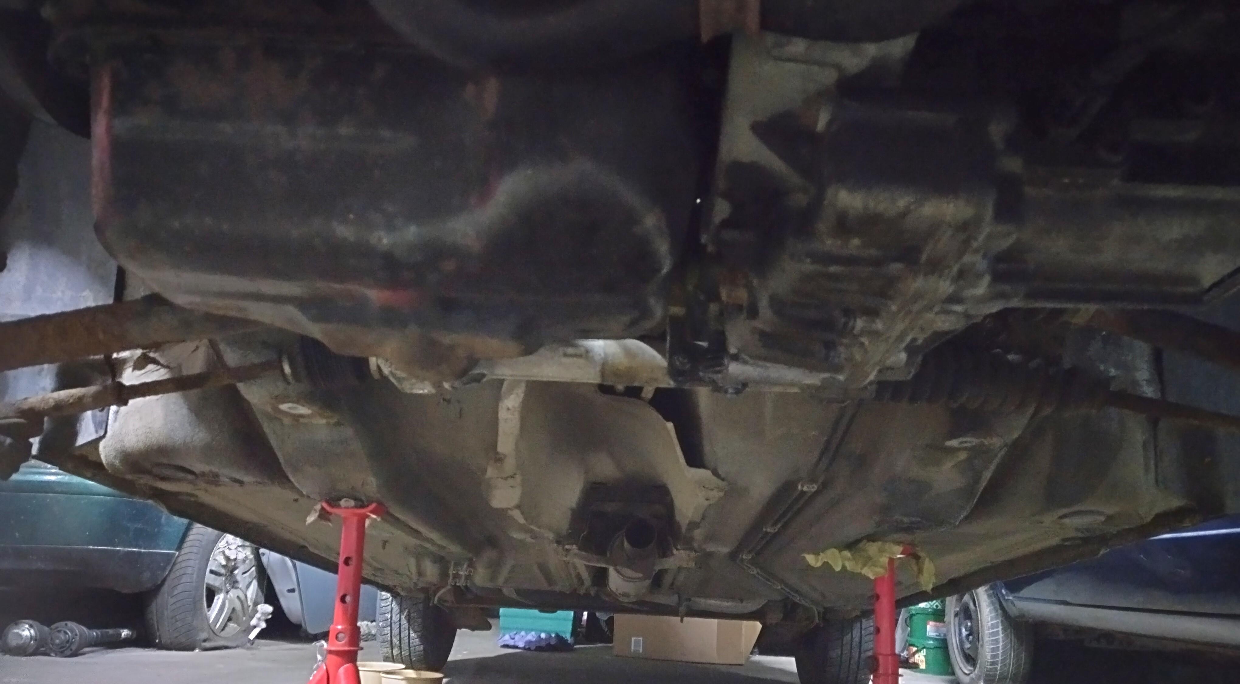

Rich Posted November 7, 2023 Report Share Posted November 7, 2023 Buy a cheap lupo they said, it will be good they said.... So I bought a cheap lupo and if has sat waiting it's time. It's time is now, it gets a thread, revival to removal. So far it has now moved inside. And it is up in the air getting all the subframe and exhaust bolts loosened off and bathed ready for removal. two tyres (£100!) Getting fitted as we speak. bushes, mounts, full arb, filters, fluids, brakes, timing belt are all on their way tomorrow. one wing acquired, two doors and one more wing to go..... 1 Quote Link to comment Share on other sites More sharing options...

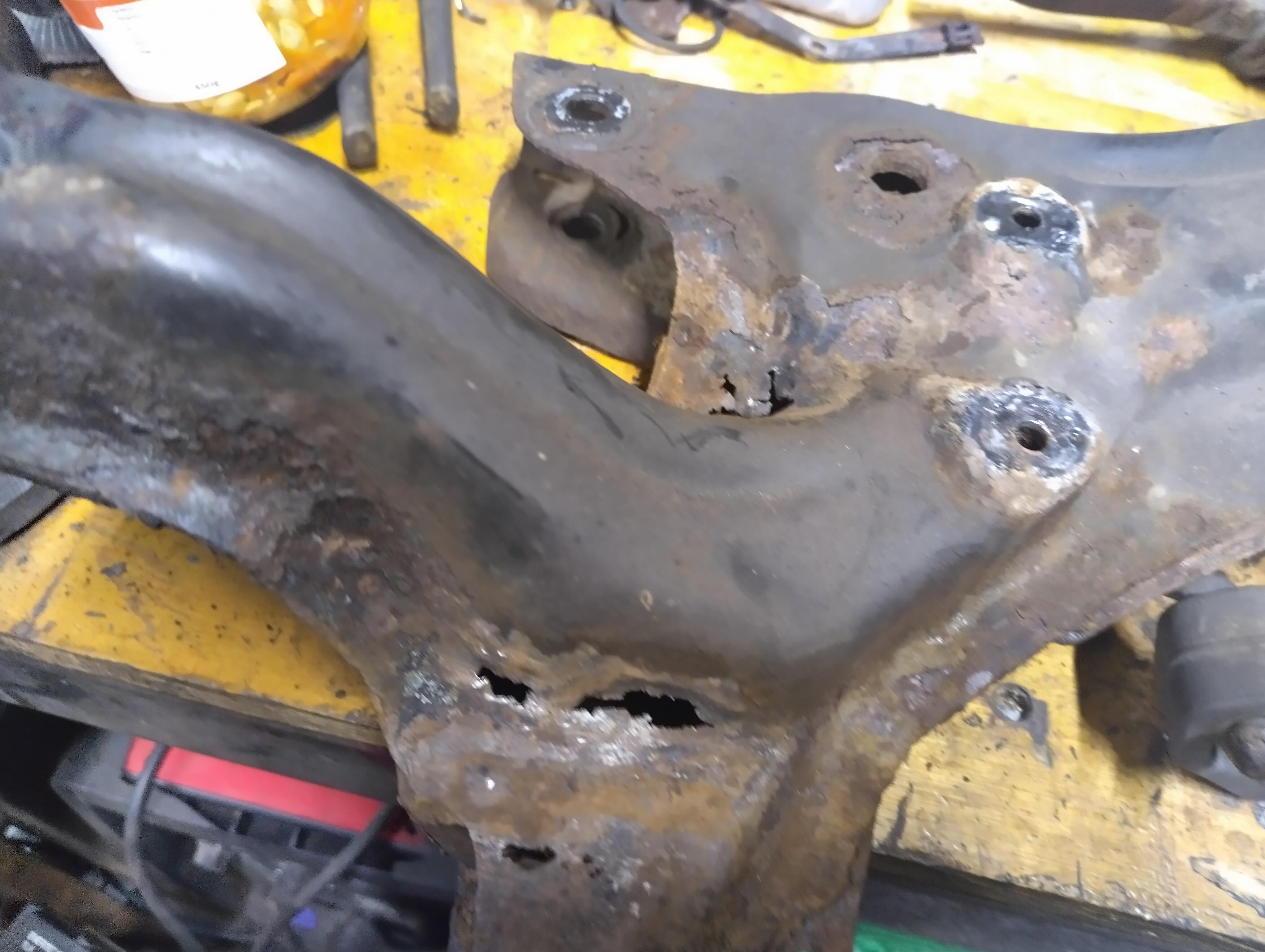

Rich Posted November 12, 2023 Author Report Share Posted November 12, 2023 Definitely a good idea to buy a cheap lupo. The parts have now actually surpassed the purchase price. Subframe removal necessitated downpipe removal, painless but annoying as that meant trumpets and oily box off. Needed to come off as the seal was twisted and needs cleaning. Egr removed, blanking plates to fit. Downpipe needs welding around the cat, easy enough, rest is all new, should be sweet. No idea why an advisory on the wishbone bushes, they are fine. Gearbox selector seal needs doing. Subframe, beyond efforts for cost/time. Quote Link to comment Share on other sites More sharing options...

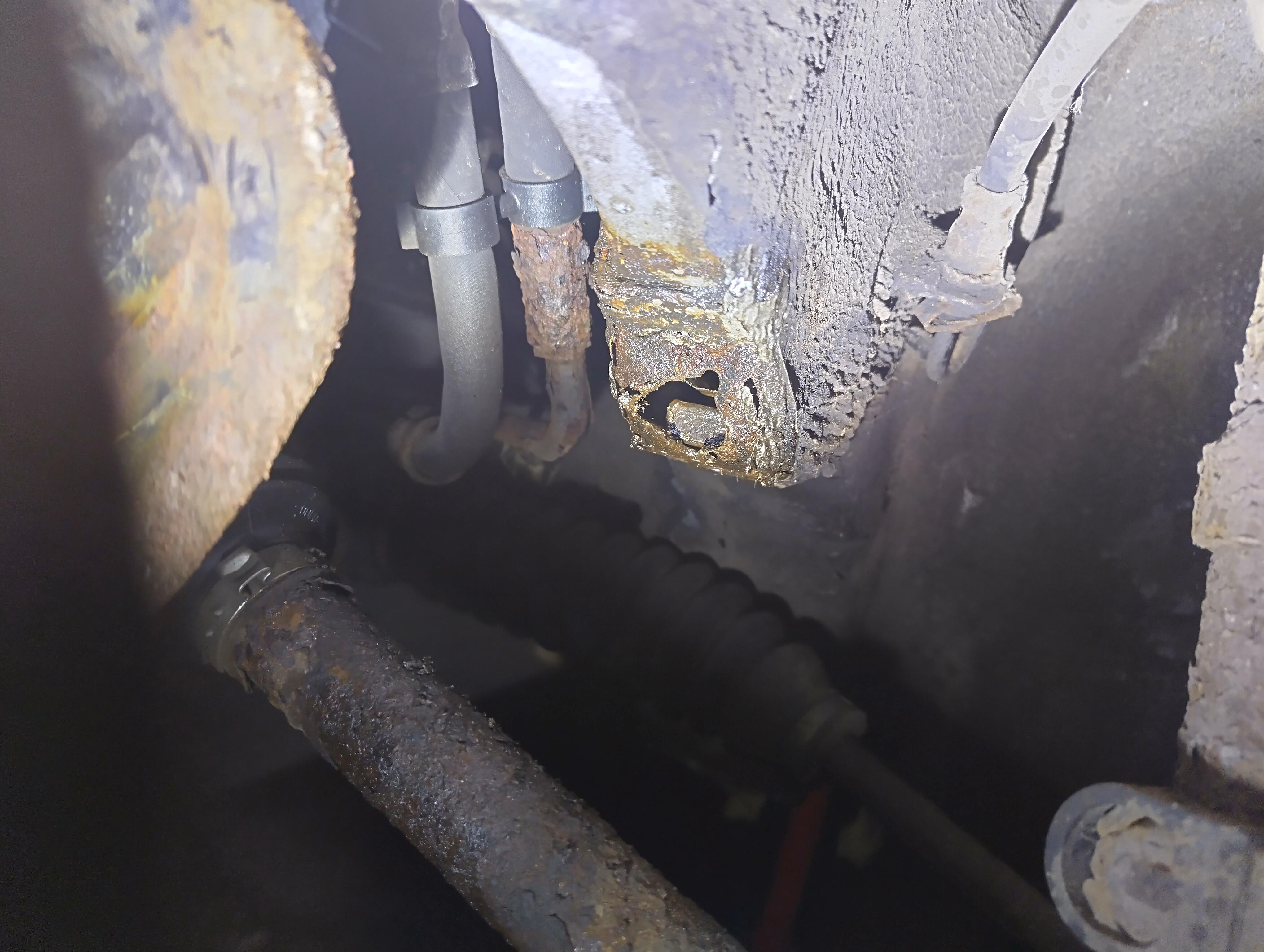

Rich Posted November 12, 2023 Author Report Share Posted November 12, 2023 Also, to note for removal, I was nice with all captive nuts, I've been here many times but the rusty passenger mount (theme on that side) decided to fight and fortunately made an access hole. I'm going to fit the frame and weld the captive and plate it. Quote Link to comment Share on other sites More sharing options...
mk2 Posted November 13, 2023 Report Share Posted November 13, 2023 Rear subframe and coils probably need doing too? They look rough! I had both front and rear subframes (bought from someone on here) sandblasted. Presently sitting in dry storage waiting to be galvanised... My silver SDI has both F&R desperate to be changed. Quote Link to comment Share on other sites More sharing options...
Rich Posted November 13, 2023 Author Report Share Posted November 13, 2023 I haven't even looked at the rear yet. The whole car is great for rust, scabby panels but sills are straight and the shell is fantastic. I was theorising that the coolant leak and the undertray were the culprit but then it's gone on the other side too. The rear jack up can be later in life, I don't wanna know. Quote Link to comment Share on other sites More sharing options...
Rich Posted November 13, 2023 Author Report Share Posted November 13, 2023 Subframe delivered, fitted, all good to go and hopefully mot tomorrow or Wednesday. Did the wishbone bushes as they were off, easy and cheap. Arb bushes and drop links too. For some reason it won't let me upload photos. Quote Link to comment Share on other sites More sharing options...
