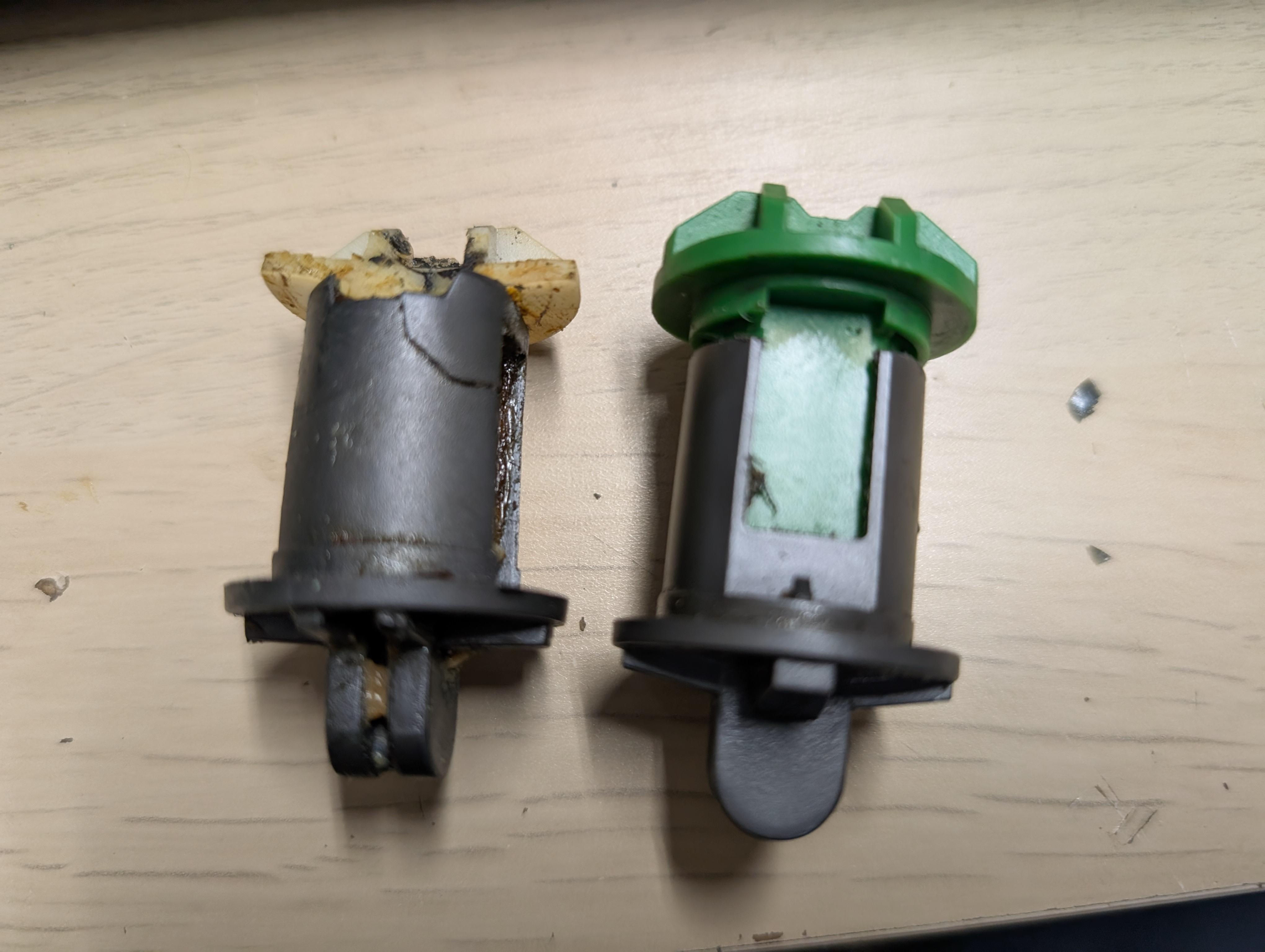

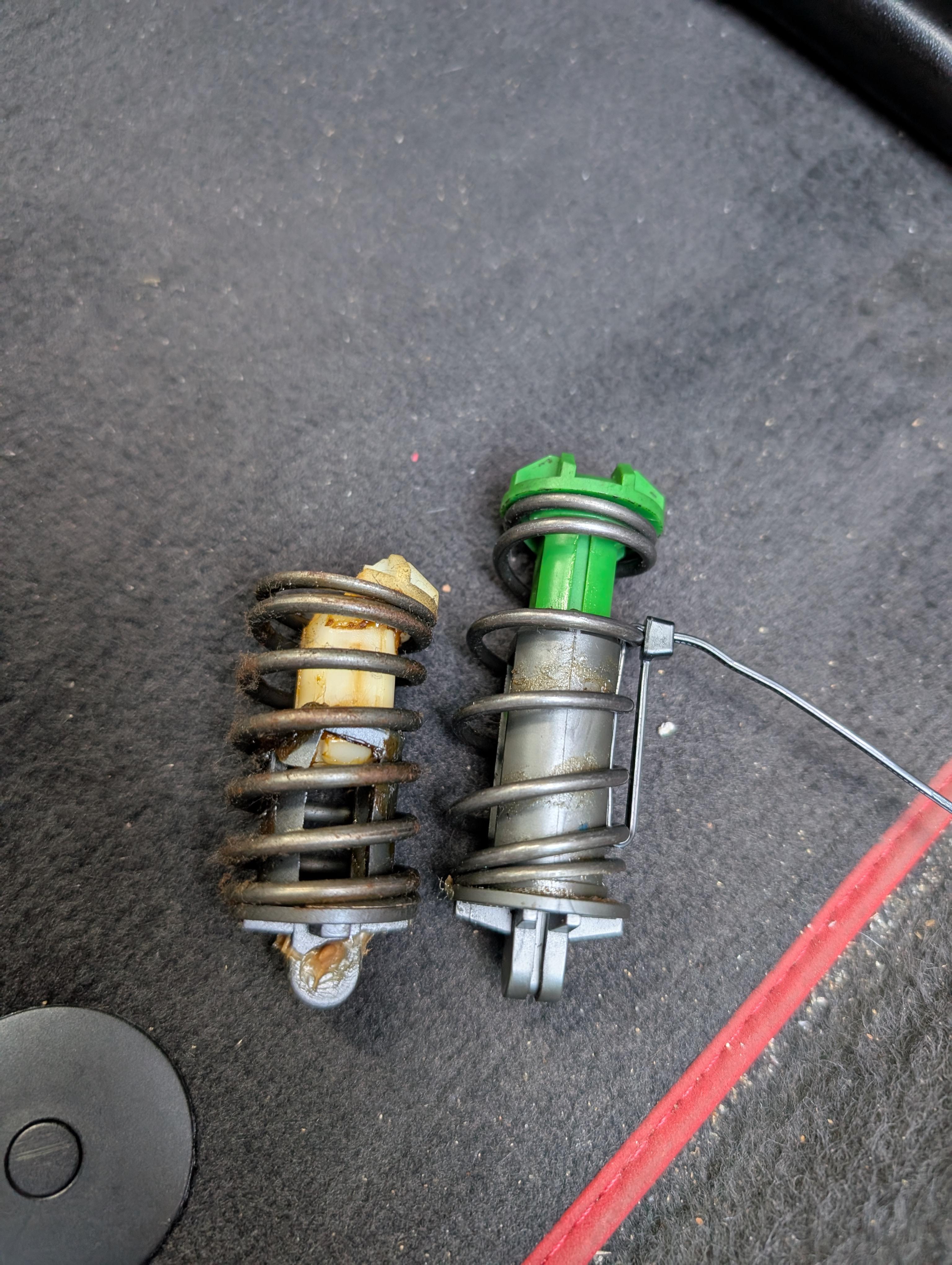

Lupo GTI JP Posted April 9 Report Share Posted April 9 (edited) I don't know if the poster is still looking at this topic, I have successfully replaced the springs. I shortened the spring inner for the GOLF and installed LUPO springs. It is working fine. Edited April 9 by Lupo GTI JP 1 Quote Link to comment Share on other sites More sharing options...
