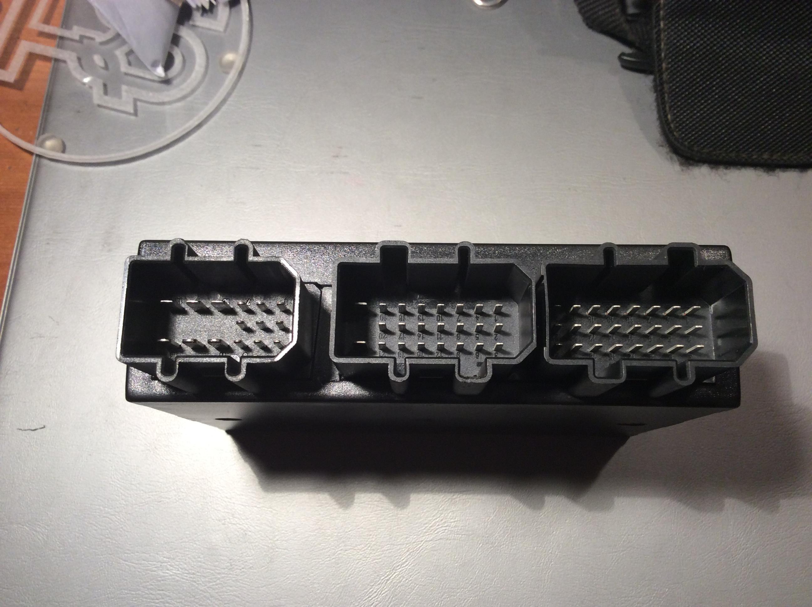

When you replied yesterday we had already located and removed the ccm,
THAT WAS EASY 🤣🤣
the photos are attached.
There is some discolouration on the cct board see last cct board picture.
Yup, those blocks at the bottom, closest the connectors are the relays. My guess is that one of them or perhaps power to them is not working.
They are nothing special- just magnetically operated switches that open and close contacts depending on what the logic says. Unusual to go wrong, but always possible. You could try unsoldering them and testing them one by one, or if you're brave, simply connect some power to each coil while still in circuit and measure the continuity with a meter.
Yeah, I'd start on the end with discolouration :)

Coukd be that a voltage regulator on that board has gone down? They're the little components with a heatsink soldered to the pcb. 3 legs one side, big single leg the other.
Nothing obvious looking at that pcb but the stains could be from damp. If these are cheap to buy then just try another one if they are pricey (for me that would be more than £25 lol) then probably worth a fiddle with it, prise the plastic cap off the relay at the end, clean the contacts and check it is working with a meter, reflow the legs and anything else that looks dry and clean off the staining if it look s like it would cause tracking.
