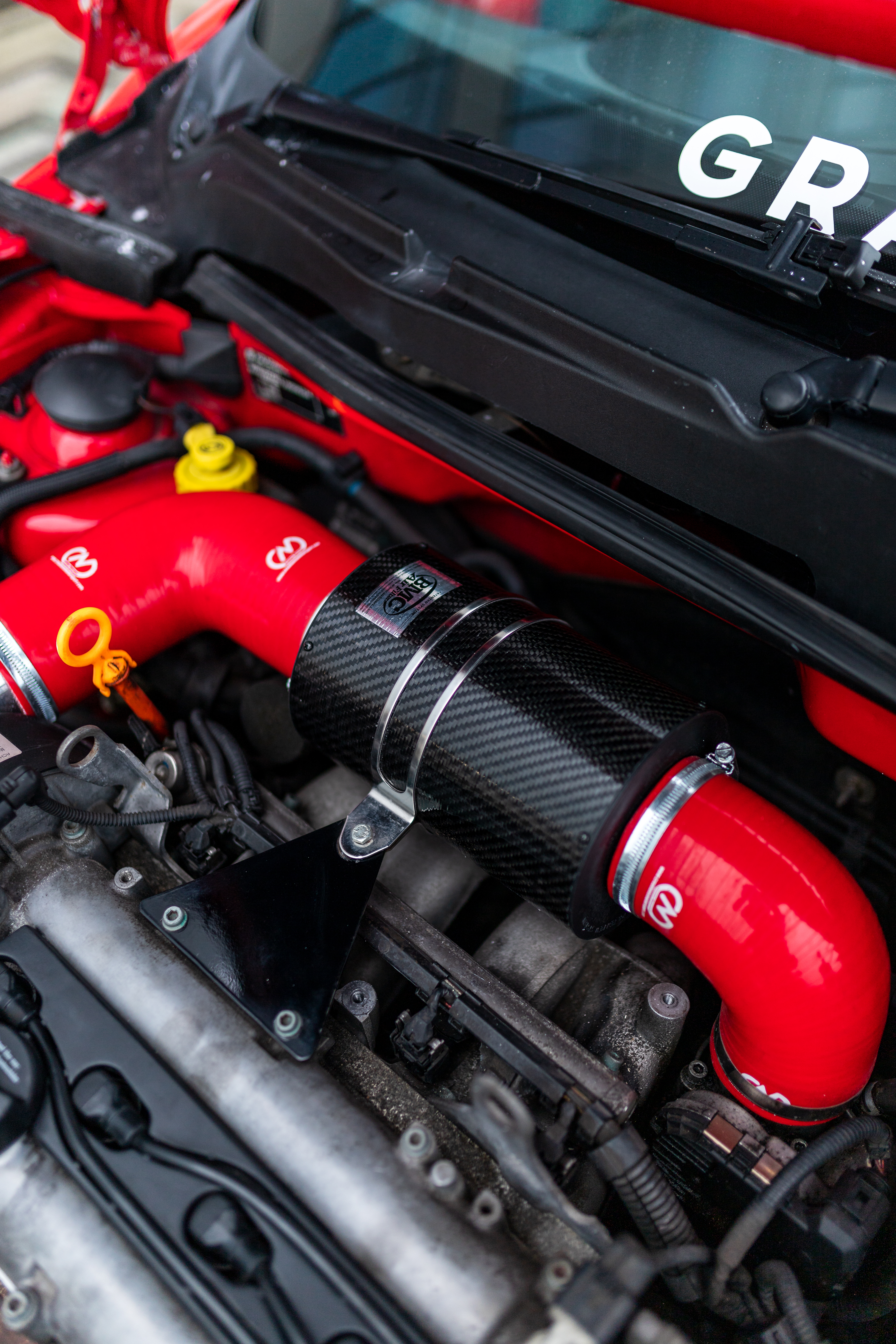

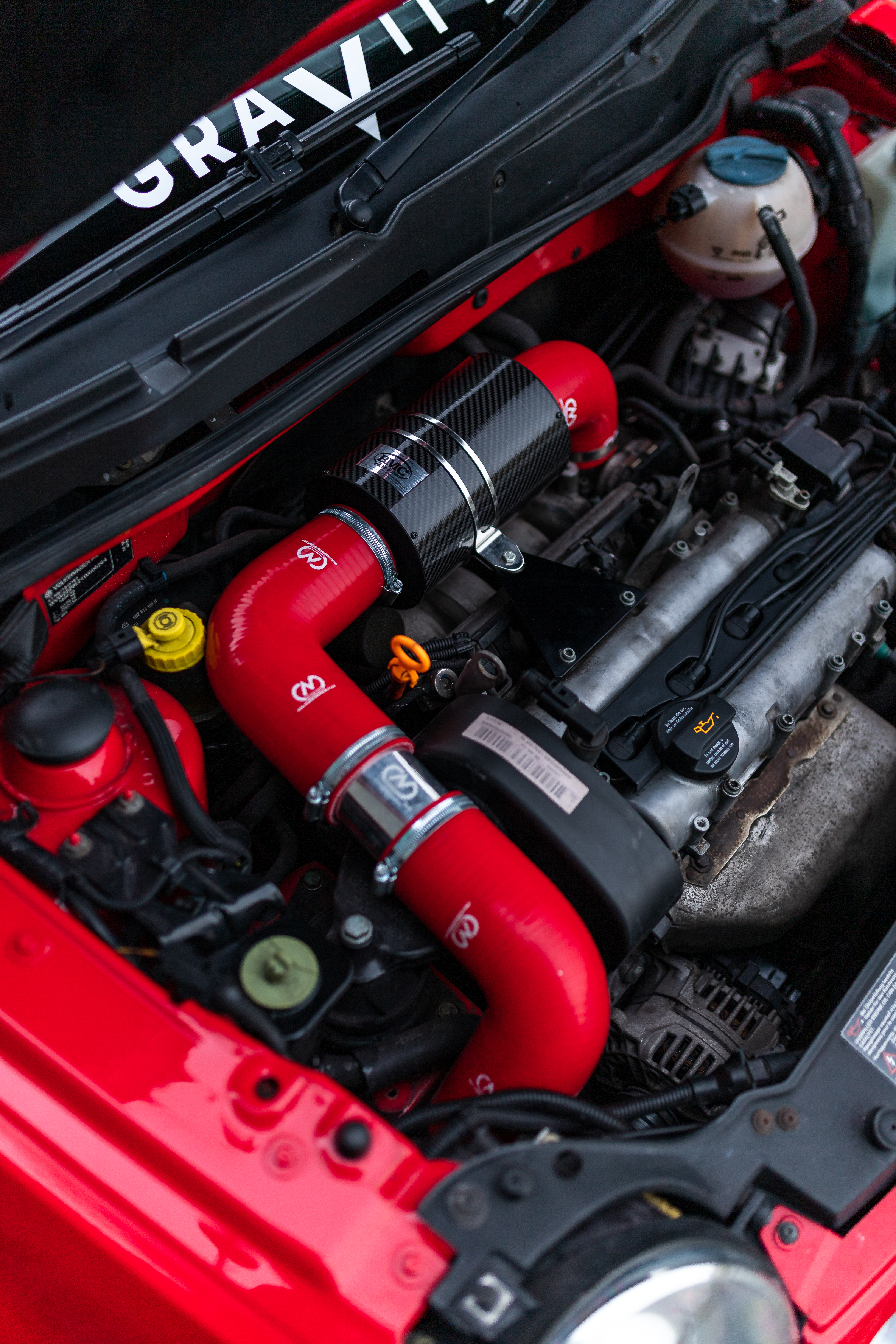

Firstly, the radiator was broken and was leaking coolant badly, I was losing a litre of coolant almost a week, so a new genuine radiator from eBay was ordered to fix it. Next, the airbox was cracked where it sat on the throttle body so that was replaced with a BMC CDA intake with silicone hosing from CreationMotorsport. After that, an oil leak started appearing, it was initially thought it was the lack of sealant around the sump so new sealant was put on and a new magnetic sump plug from ECS was used to help, still problems were there. Then the oil breather housing was replaced since it was cracked and the problem went away. Shortly after, the cam belt and water pump were changed since there was no history of that getting done!

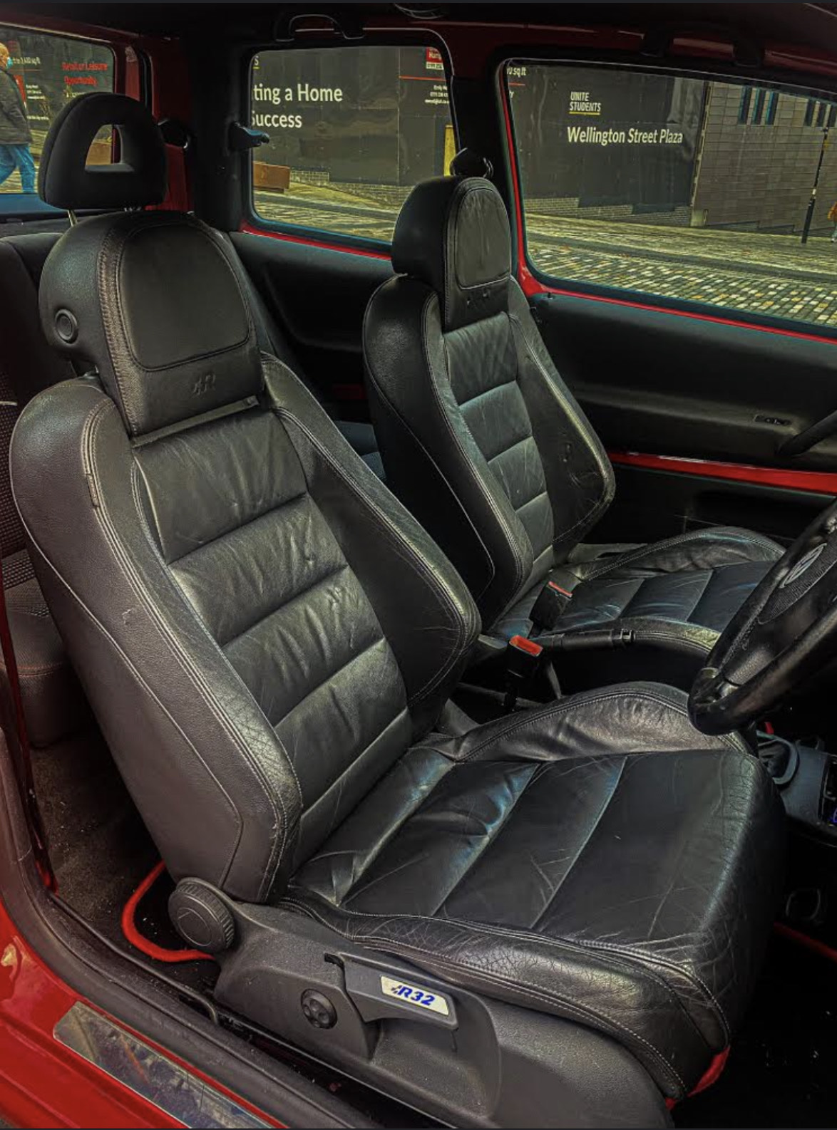

Finally, I changed the front seats as they were looking tired so they were replaced with the Mk5 Golf R32 leather seats I put in my 1.0ltr (yes I still have the 1.0 too), and immediately it was an upgrade over the cloth seats. A few cosmetic changes were then done such as getting the rear windows tinted 15% since I didn't like the idea of being exposed, shorter aerial and a couple stickers.

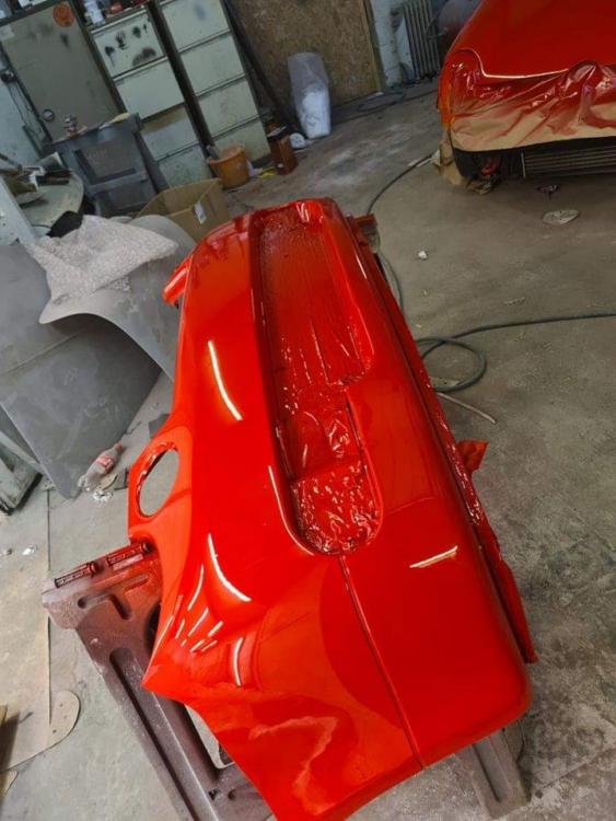

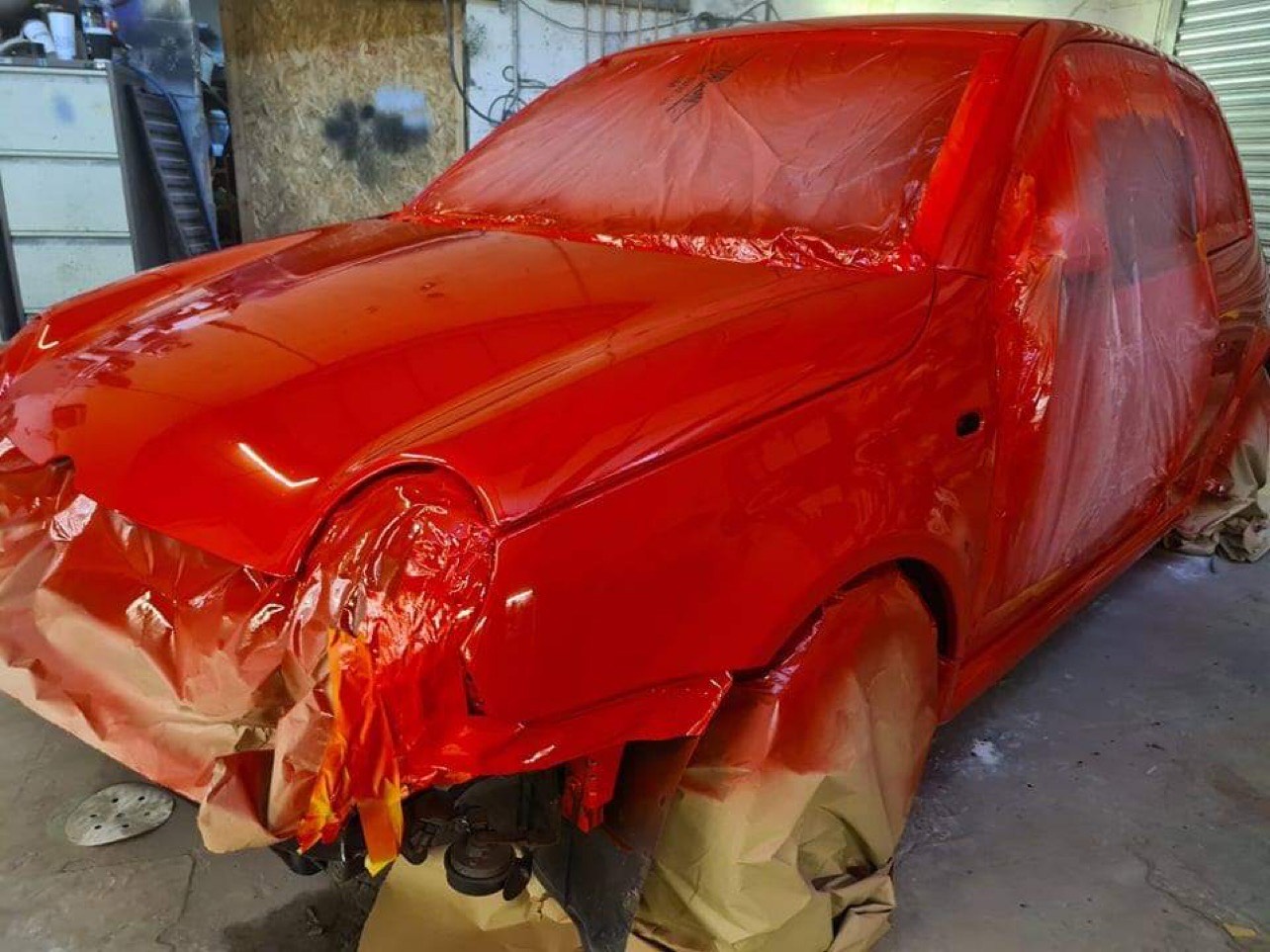

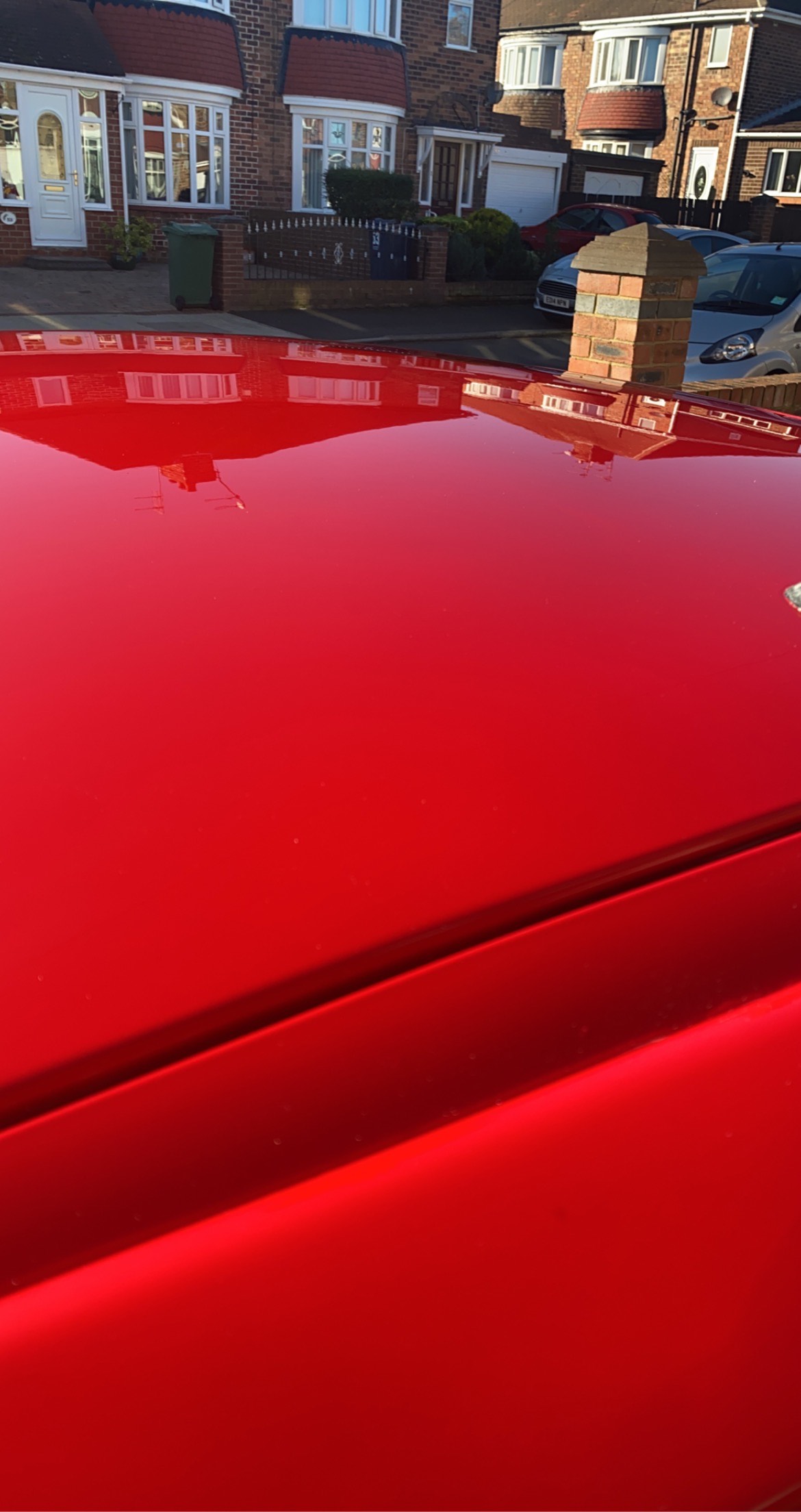

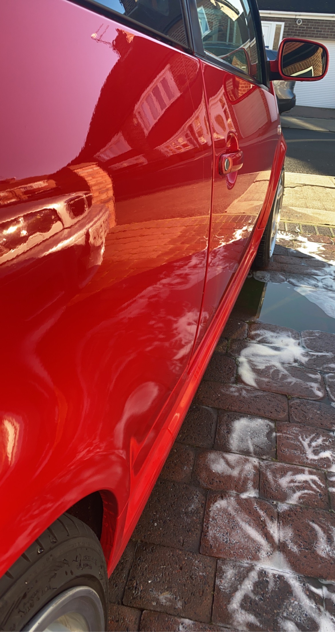

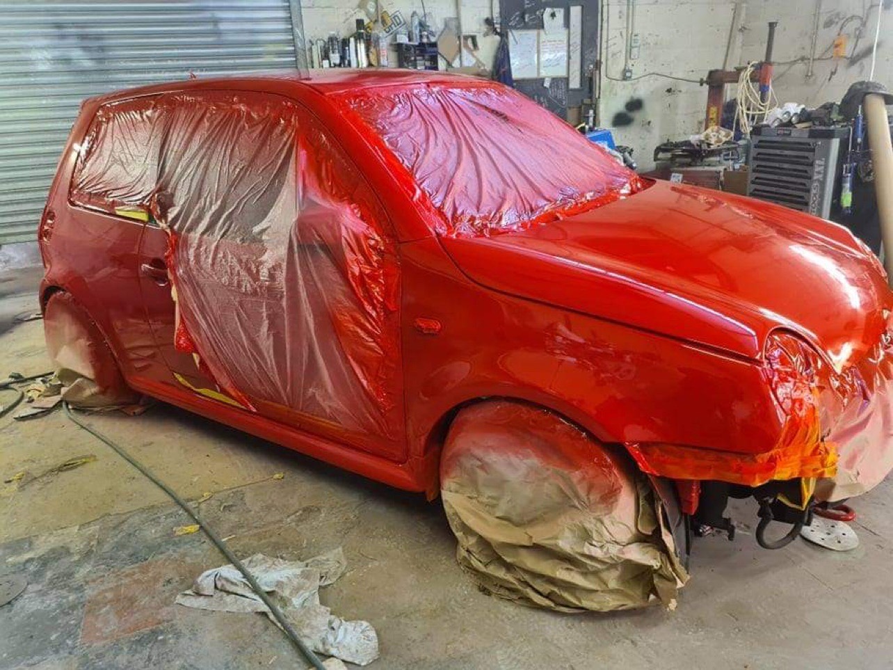

Decided to upload some more pictures of the Lupo! Couple pictures are when it was in paint and prepped by my painter and then being detailed by myself. The picture where it has the stripe was one of the first pictures I took, only had the car for a number of days at that point so went out exploring the countryside getting to know the car a little bit along the way. Uploaded a couple pictures of the seats to see how it transforms the interior, and they completely do! The normal seats were far too relaxed I thought and they didn't demonstrate what a proper GTI interior should be so they were changed for the Mk5 R32 leathers.
