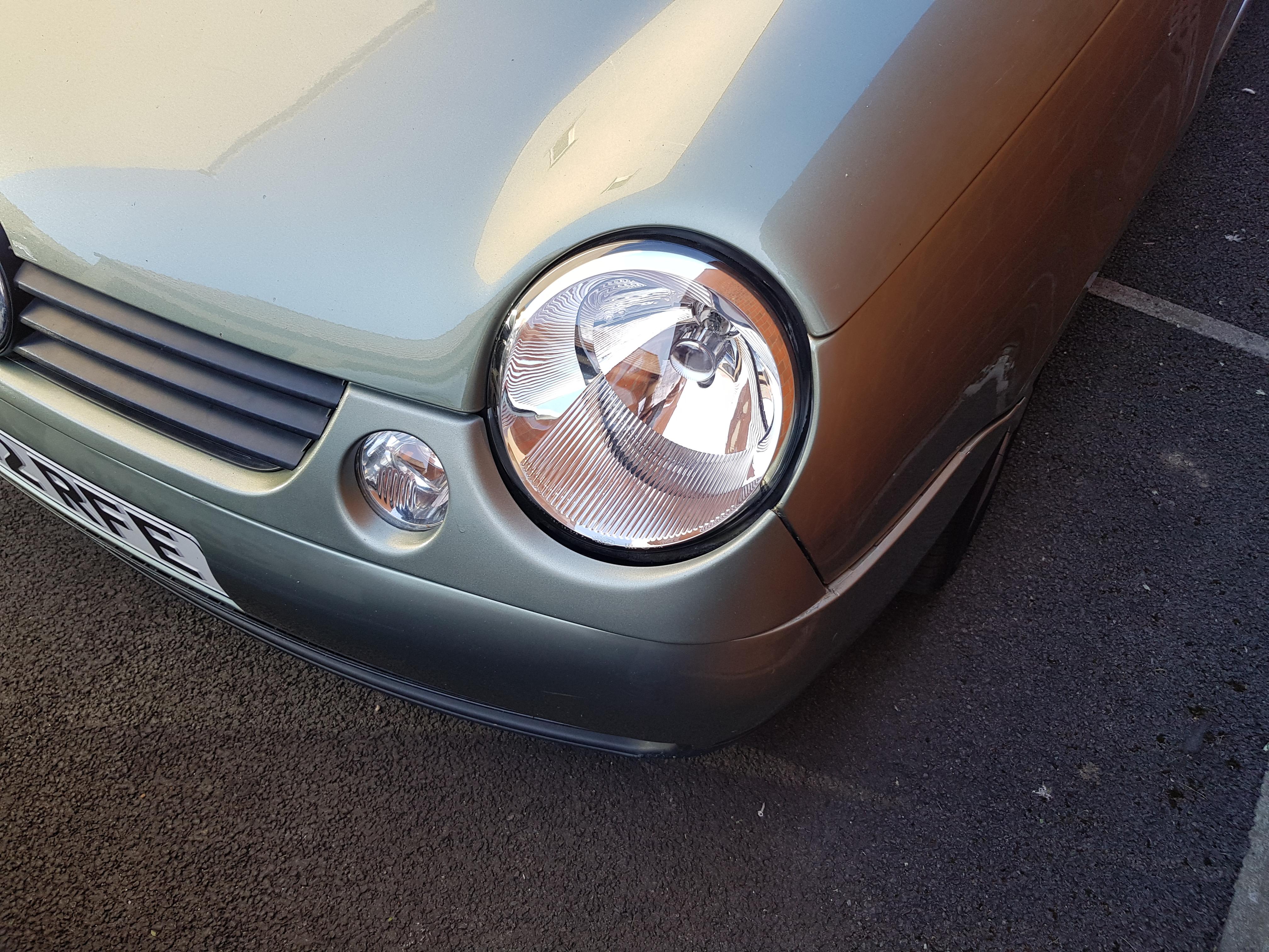

Another update - we are on a roll.
The indicator panel was damaged on the passenger side. You can see the damage in this photo:
We removed the panel and pulled the front bumper away slightly to help.
We are missing one of the locating pins that connect the panel to the wing. Any idea where i can get one of these? I also was gutted to see that the tabs on the bottom of the new panel we have sprayed to match the car are broken, so it sits all wrong.
Any help much appreciated.

Those tabs are often broken.
Those pins are rare, get to a scrappy and rip some cars apart and start collecting.
Yeah, what @Rich said. I find the trick is to use a hot air gun (hair dryer) on the wing where the two clips are. Then when very warm (not paint blistering hot), spray some silicone oil into the seam, to try and get it to penetrate into the two clips. Then it simply pulls/pops apart.
In the past I used to keep breaking the things, as I don't think that it's possible to separate the front panel from the wing without divine intervention... Not the best design.
Patience is key with the front panel
There's a 1L in A1 breakers in Winnersh area. I think it's been pretty much stripped given how scarce Lupos are down here, but the wings were still on, so the clips might be still there. I don't have a single one that's not on a car. I think I've seen them on ebay for a few quid. Might be worth a bit of research time...?

My daughther and I gave the indicator panel a go yesterday or the day before (lockdown days all look the same!).
The damage can be seen on the right hand side.....

After testing all our skills in sanding, filling, painting and laquering a black indicator panel and then building broken the support brackets from plastic, glue and nuts/bolts this morning we have:20200529_105714.thumb.jpg.8ef279bb1ba7d6c2872e0f2b7aced03c.jpg
Its still not 100%, but once the local breakers yeard opens up, i will find the parts i need. It does look better though!
All credit to my daughter who has learnt the fine art of painting and sanding....
