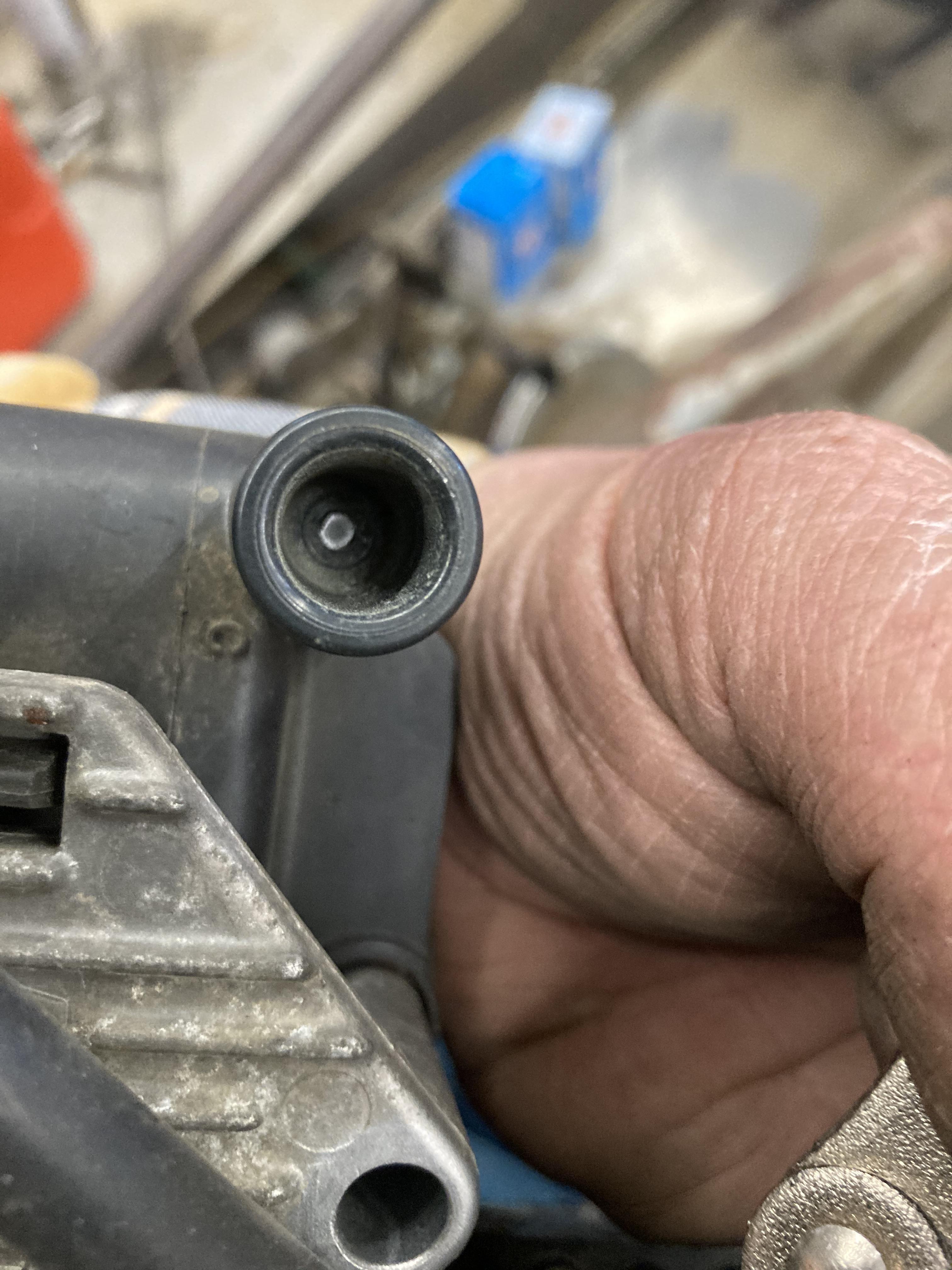

oprn 30 Posted February 17 Author Report Share Posted February 17 The weather has warmed up a lot. We were off to the city today with Franklin and he bucked and misbehaved all the way there and back. It was only -9 in the city too so it's not the cold. Tomorrow I will lift the bonnet and start the investigations. When it was random it was hard to find but now that the problem is here to stay I should be able to find it... I hope! Quote Link to post Share on other sites
Rich 1,059 Posted February 17 Report Share Posted February 17 Seems like a misfire, isn't a misfire, green temp sensor. Quote Link to post Share on other sites
oprn 30 Posted February 17 Author Report Share Posted February 17 Might have found it. Pulled the spark plugs and they looked ok. Next was the wires into the coil pack - hoo boy! We have an issue! 3 out of 4 badly corroded and the 4th one the connecting pin broke off and came out with the wire. Looking for a coil pack now and a set of wires! Quote Link to post Share on other sites
mk2 361 Posted February 17 Report Share Posted February 17 (edited) I was thinking condensation on HT, but @Rich's suggestion is probably closer to the mark. There's a youtuber in the US who's collected all the temp sensors from vdubs he's worked on since '98. Has a large bin full- like a lot (1000's)! Edited February 17 by mk2 Posted at exact same time as reply... :) Quote Link to post Share on other sites
mk2 361 Posted February 17 Report Share Posted February 17 (edited) I was right . Damned vdub ht leads from that era... Hate. Edited February 17 by mk2 Quote Link to post Share on other sites
oprn 30 Posted February 17 Author Report Share Posted February 17 Funny! it ran just fine on the way to the shop this morning, I put my OBDII reader on and no codes. Well I cleaned them up as best as I could with a nail, greased them up and it's running fine again but I know what I need now! The shopping starts... Quote Link to post Share on other sites
oprn 30 Posted February 18 Author Report Share Posted February 18 Parts on the way from Autodoc. Cost more to ship than the parts are worth but that's the way it goes. The coil pack it turns out is common here and readily available but the HT leads are not so might as well get them all in the same shipment. Quote Link to post Share on other sites
Rich 1,059 Posted February 18 Report Share Posted February 18 Going to say, that coilpack is very very common across the world. Quote Link to post Share on other sites

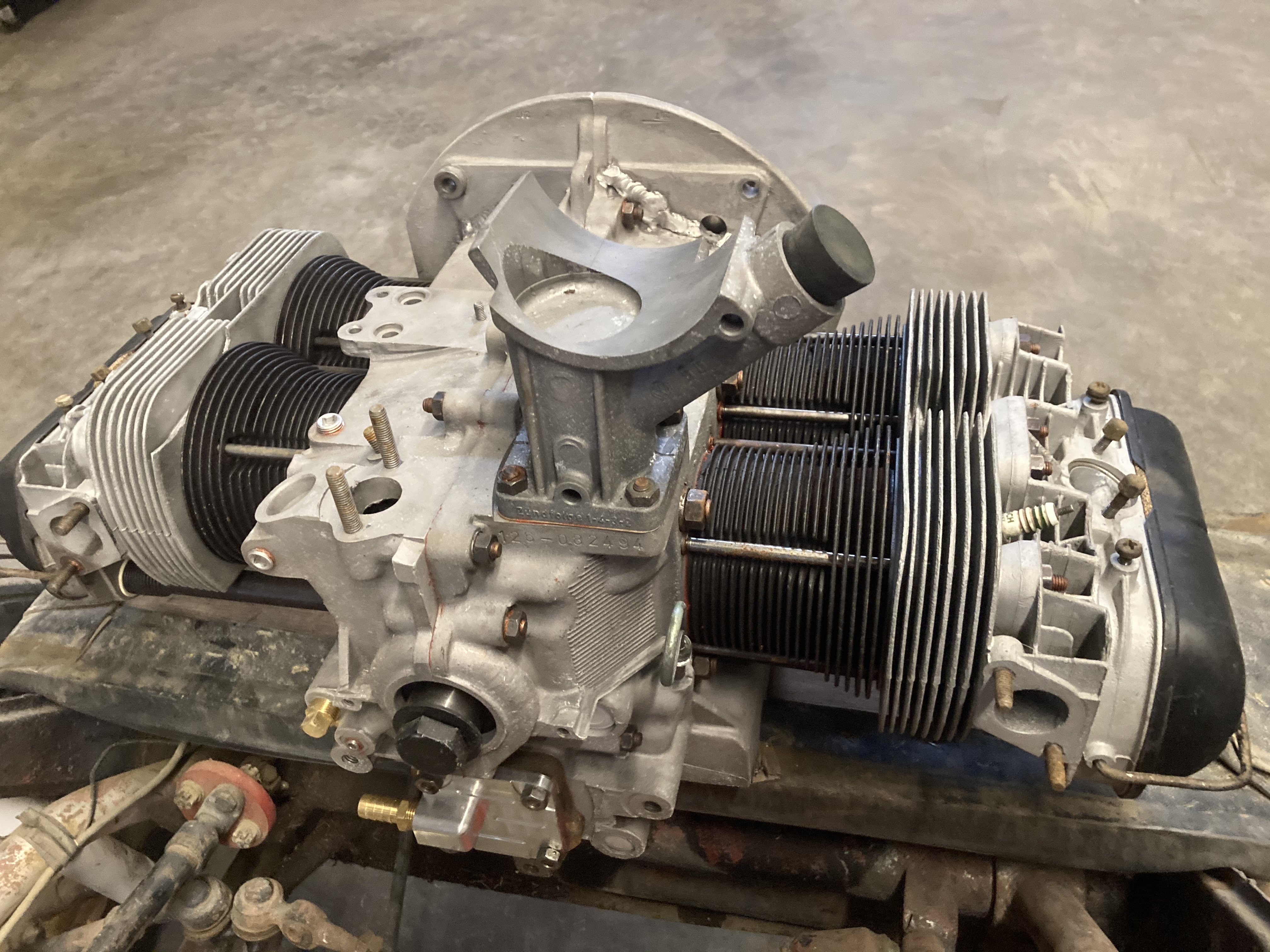

oprn 30 Posted February 20 Author Report Share Posted February 20 (edited) While waiting for parts I will continue with putting a fresh engine in the sand rail. The old one was just a well used core that I used initially when I built the Buggy and it gave us 6 years of service well above and beyond what I expected from it so time for renewal. Out with the old and in with a fresh one I rebuilt last summer. Edited February 20 by oprn spelling correction 1 Quote Link to post Share on other sites
