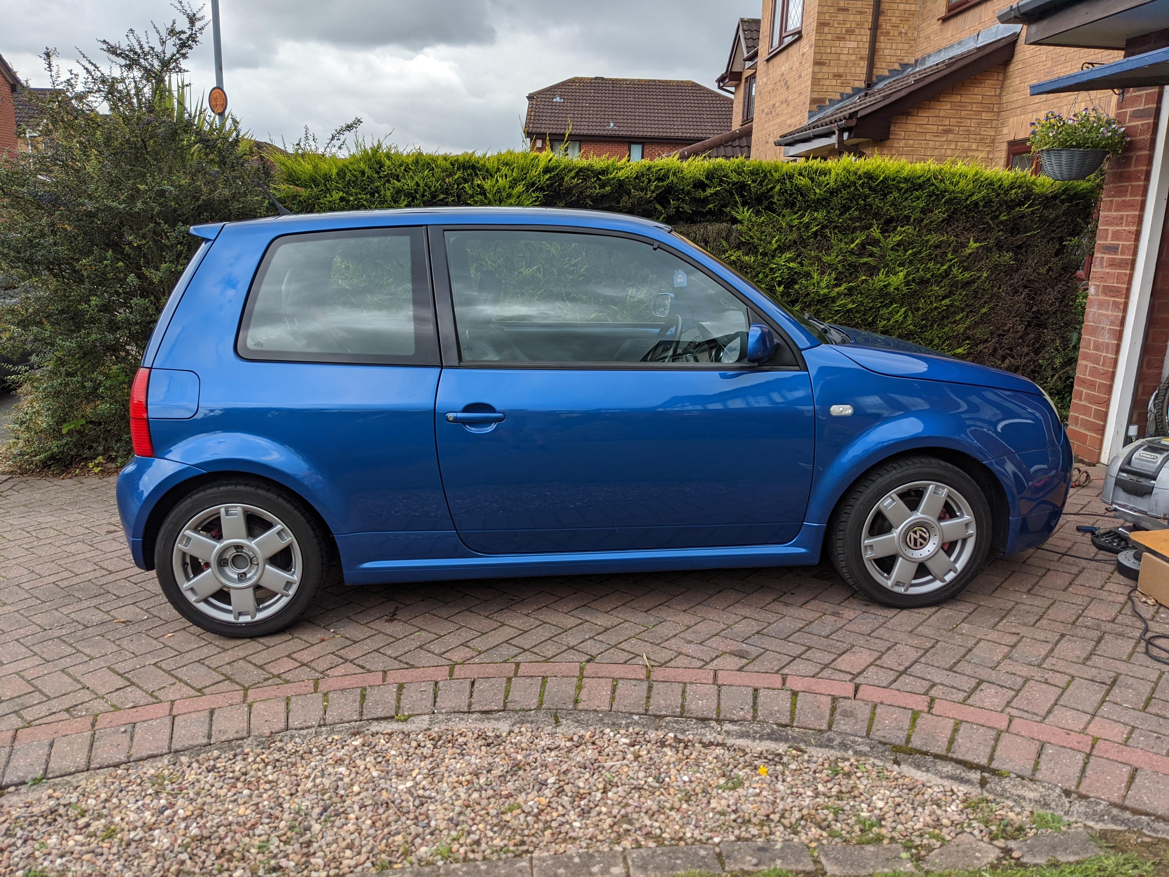

dirk1978 Posted June 23, 2020 Author Report Share Posted June 23, 2020 Got the fronts on and tried to get the car to a height I like. I always wanted a slight drop to make it look a bit more in keeping with what other cars look like these days. The height of the standard GTI can look silly sometimes. There's a huge amount of adjustment in the camber so until I can get it aligned I've just pulled the top out to the end. That's where it was on the OE struts anyway. The clips for the ABS cable wouldn't go into the lugs on the new struts so I cable tied one of the bungs to a lug. This was with the rear on the (I think) highest setting and the front just guessed at. I've since taken about 5mm off the rear. I'll have to see how it settles. It feels utterly amazing compared to before though. It's at least as comfortable as the original springs and has no harshness at all. I can glide over my local speed bump at the same speed as before and it feels like a modern car. Don't know if the Vogtland are really good or if the originals were really bad. Quote Link to comment Share on other sites More sharing options...

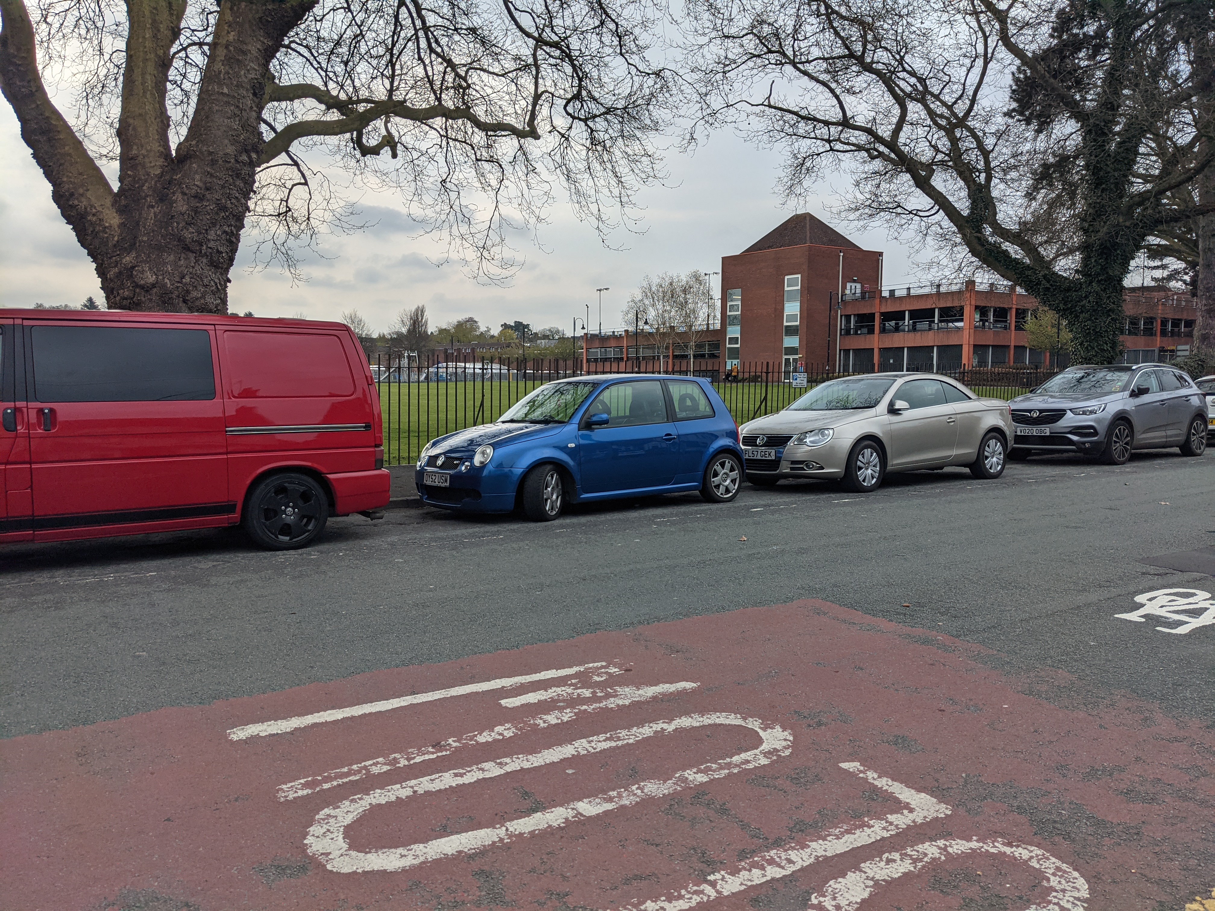

dirk1978 Posted June 25, 2020 Author Report Share Posted June 25, 2020 What does everyone think of the drop? 2 Quote Link to comment Share on other sites More sharing options...
Rich Posted June 25, 2020 Report Share Posted June 25, 2020 Looking good. Riding well? Quote Link to comment Share on other sites More sharing options...
dirk1978 Posted June 25, 2020 Author Report Share Posted June 25, 2020 3 minutes ago, Rich said: Looking good. Riding well? Brilliant. Top tip on the Vogtland. Thanks. Quote Link to comment Share on other sites More sharing options...
mk2 Posted June 25, 2020 Report Share Posted June 25, 2020 Nice. So much lower than my E spec SDI. Quote Link to comment Share on other sites More sharing options...
Skajme Posted June 25, 2020 Report Share Posted June 25, 2020 Looks really smart that, good height I reckon! Quote Link to comment Share on other sites More sharing options...
Blue Loop Posted June 26, 2020 Report Share Posted June 26, 2020 That ride height looks very similar to mine, I like it! Quote Link to comment Share on other sites More sharing options...
Y2ACP Posted June 27, 2020 Report Share Posted June 27, 2020 Spot on,this is how it should have come out of the factory. 1 Quote Link to comment Share on other sites More sharing options...

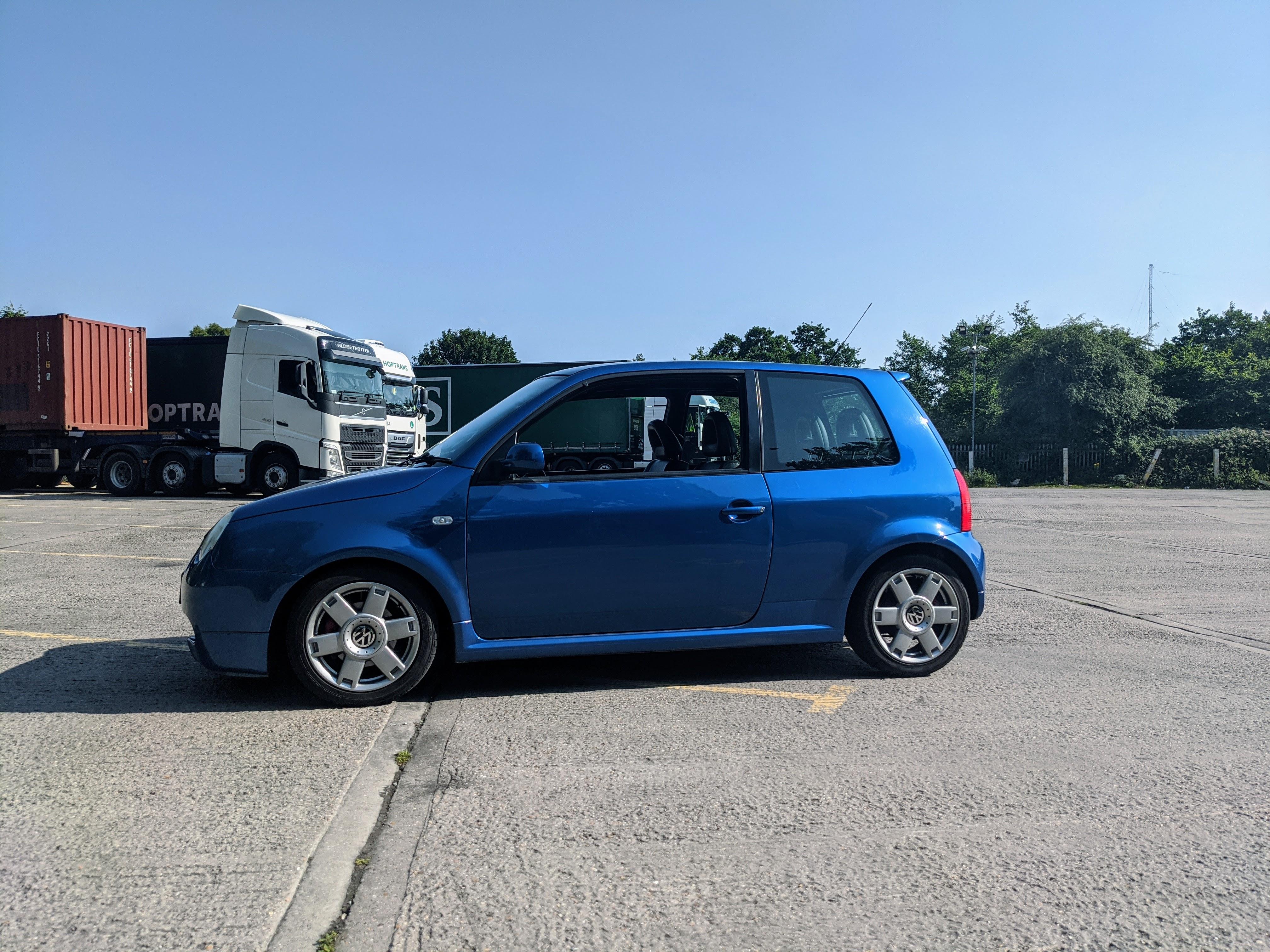

dirk1978 Posted August 4, 2020 Author Report Share Posted August 4, 2020 The coilovers said they would drop a bit after settling. Seems they have settled at this height. I'm happy with this considering this was the first attempt at setting the height and I haven't touched it since. 3 Quote Link to comment Share on other sites More sharing options...
Skajme Posted August 4, 2020 Report Share Posted August 4, 2020 Looks good! I feel like the rear needs to come down slightly though! Quote Link to comment Share on other sites More sharing options...
dirk1978 Posted August 5, 2020 Author Report Share Posted August 5, 2020 8 hours ago, Skajme said: Looks good! I feel like the rear needs to come down slightly though! I keep wondering this but this driveway is slightly sloped so when the handbrake is on the rear lifts slightly and when on level ground the rear arches still look higher than the front but the sills look parallel. One thing I don't want is any reverse rake and at the moment the handling feels absolutely perfect so even if it is slightly raked I'm happier that way. I dunno, I might take 10mm off the back and see what happens. Quote Link to comment Share on other sites More sharing options...

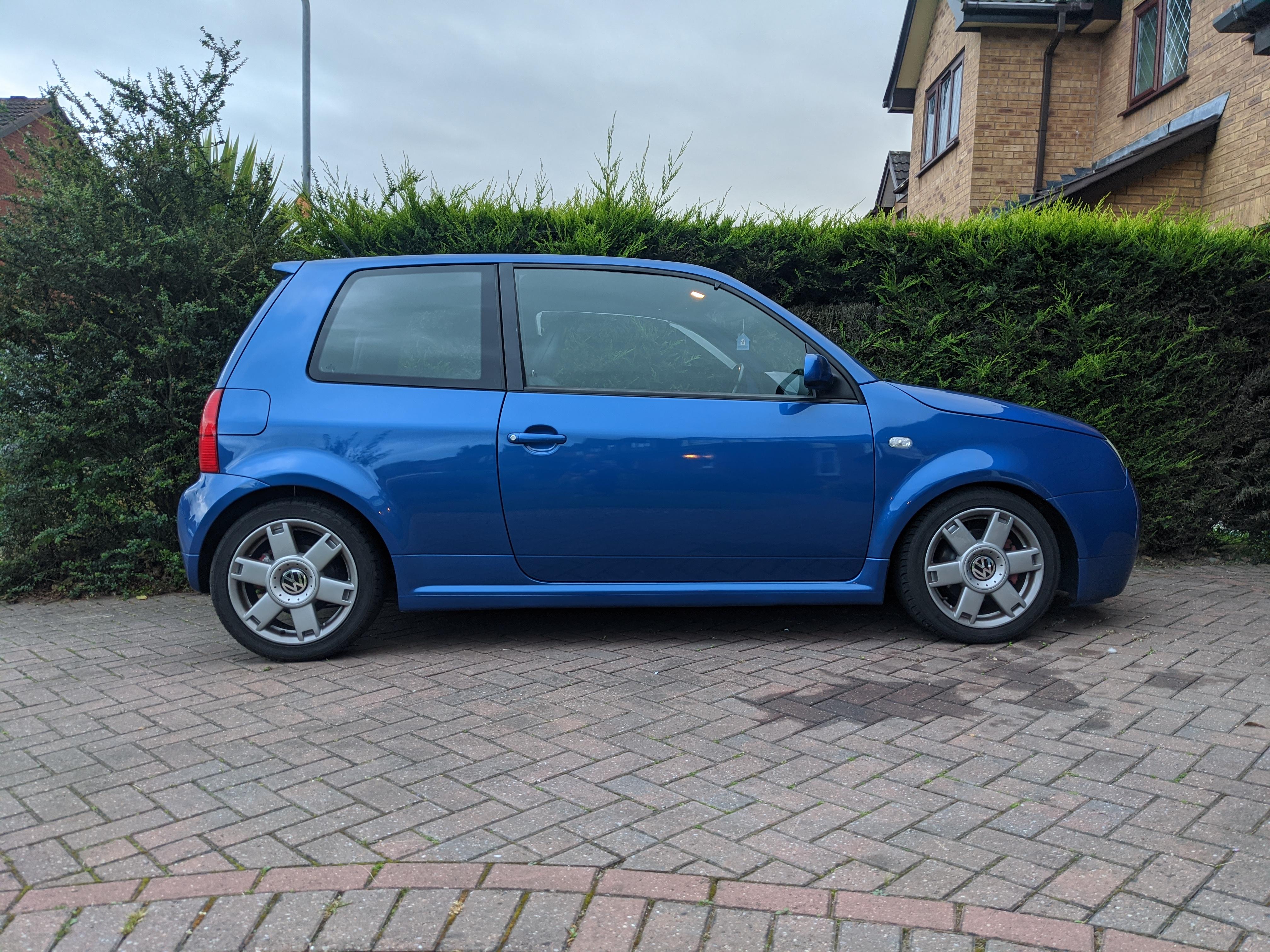

dirk1978 Posted April 28, 2021 Author Report Share Posted April 28, 2021 Every time I drive it and look at it I think I couldn't have set up the suspension any better. I never got the camber redone either and the tyres are wearing perfectly. 1 Quote Link to comment Share on other sites More sharing options...
