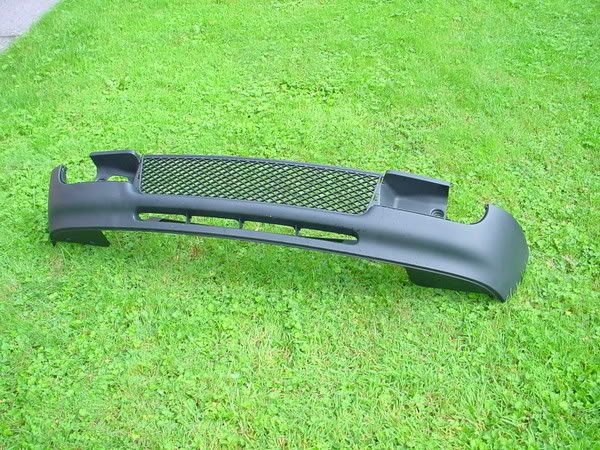

Hi,
I brought the 3L lower bumper/spoiler 3 years ago from my local VW dealer's parts dept but never got around to fitting it to our standard 1.4s colour concept. I still have the parts they look as if they fit, the bumper shape seems the same on both 3L and standard car ( that is where lower spoiler joins) The part No are as follows:
Lower bumper/spoiler - 6E0 805 903 C B41
you also need the fog lamp cowls or blank off covers.
fog lamp cowls are handed - 6E0 853 665 C
6E0 853 666 C
the colour is best described as very dark grey whereas my standard car has black spoiler.
I am quite happy to send pictures of the parts but do not know how to post a picture here, unless someone can educate me.
Hope this will help you, it is a great looking spoiler, I even have the 3L TDI brochure (German) with closeup pictures of the spoiler detail . Have you seen the special aluminium/magnesium steering wheel for that model.

Thanks to scirocco for sending some 3L lower bumper pics. Not shore now...
lupo3lspoiler001.jpg border="0" class="linked-image" />
lupo3lspoiler003.jpg border="0" class="linked-image" />
