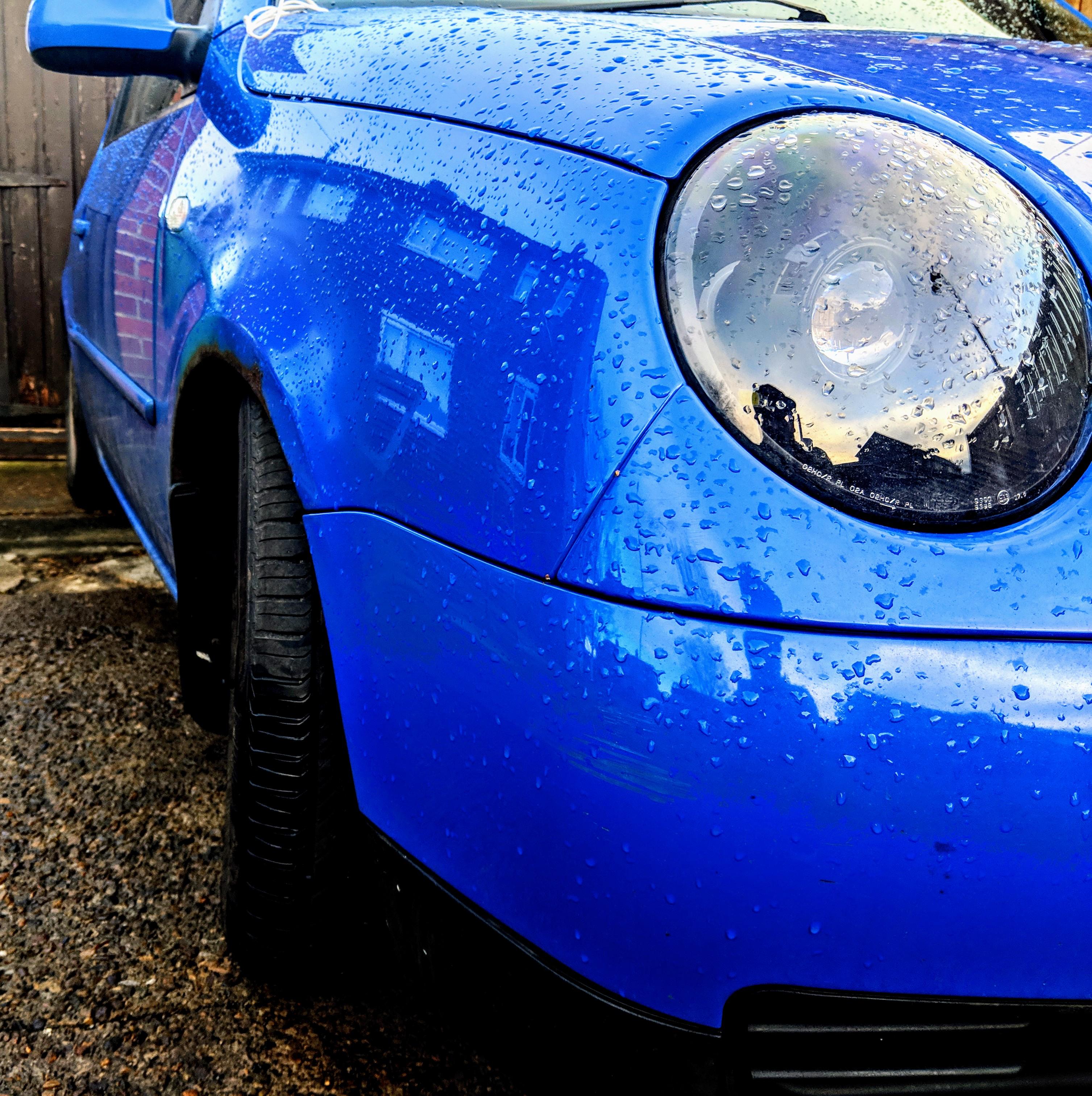

One of the front, all I got at the moment

love the colour!

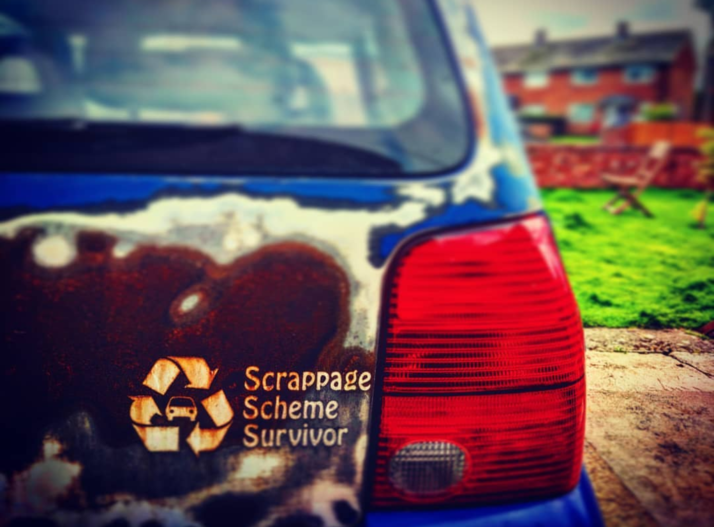

Thanks for the kind words on the colour but it won't be like that for long. Going down the patina/rat route
Very nice!

Be a shame to rat it. I've never seen an SDI in that colour. Might be rare (worth more).

The guy who had it before me has already attacked the back with a sander, so I thought might as well carry on. Yeah there's a few gti's round here and a few chavvy looking ones as well.

She gets waxed everyone she's washed.

i'd personally get a new back door fix the arches and swap the fuel lid. The car would instantly be worth a sh!t load more.

Hi QU1N Y  Welcome to the forum. I like the blue on your lupo. Get all the same colour look even better.

I like the rat/patina look. Apologies for ruining the colour.
