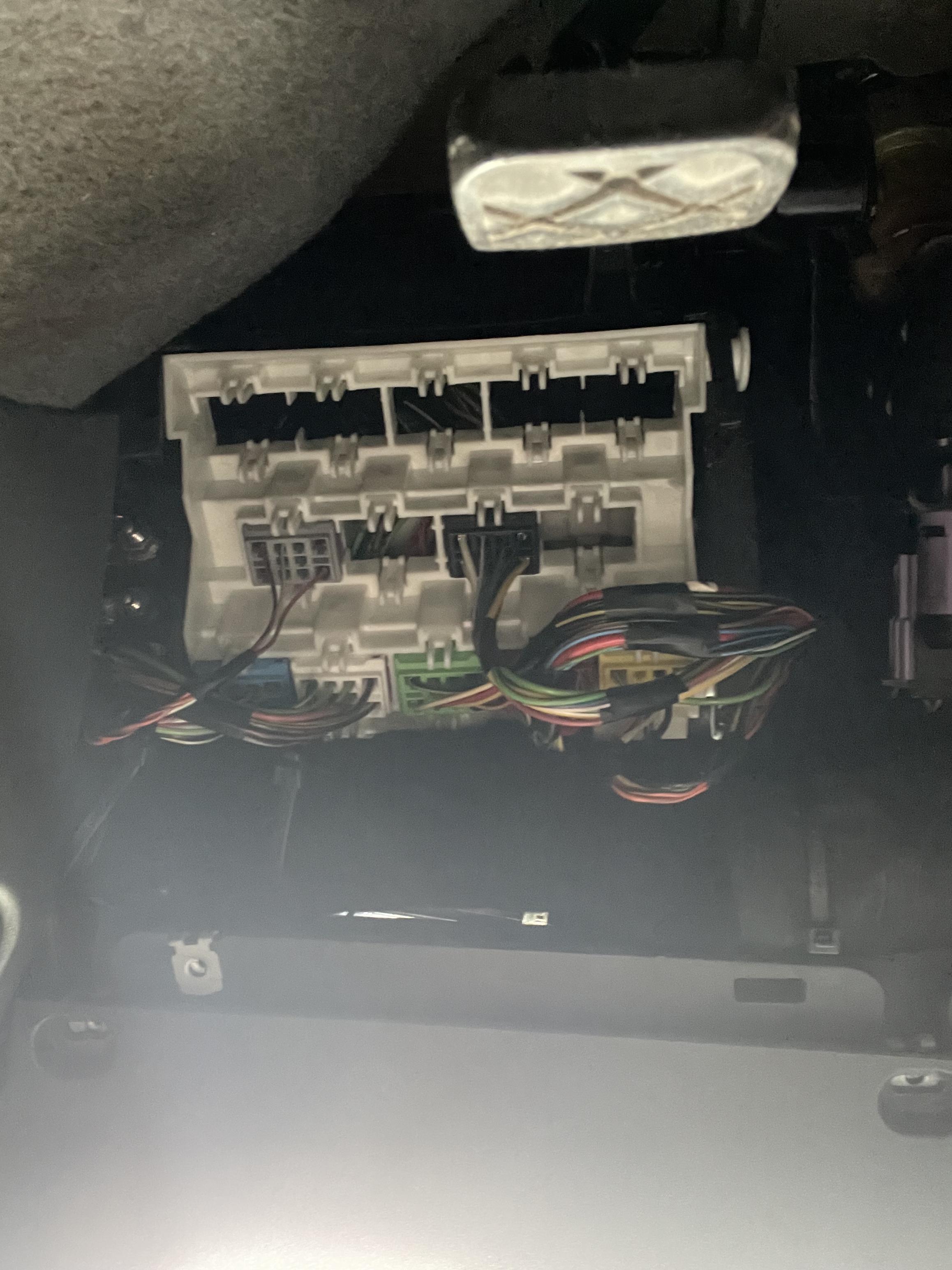

Dblock Posted April 10, 2015 Author Report Share Posted April 10, 2015 My brother tried this on his car but he got stuck. Hi everyone,Was attempting to change my relay 109 today but ran into some difficulty. Unscrewing the fuse box doesn't give enough manoeuvrability to get my hands in to the relays behind so I took the panel from underneath off. I was met with this (picture) which I couldn't figure out how to disconnect the wires from. The whole thing itself could be taken out of its holder but doesn't give enough room to get in behind it to the relays. How do you disconnect the wires? Is there an easier way? Quote Link to comment Share on other sites More sharing options...

Pete Posted April 10, 2015 Report Share Posted April 10, 2015 They unclip from under and above and pull towards you, I'm sure you can unclip the whole bracket tho from the tab on each side and it gives enough space to get to the relays, it's all slotted in see so you undo the lug on either side, swing it towards you and pull out. Quote Link to comment Share on other sites More sharing options...

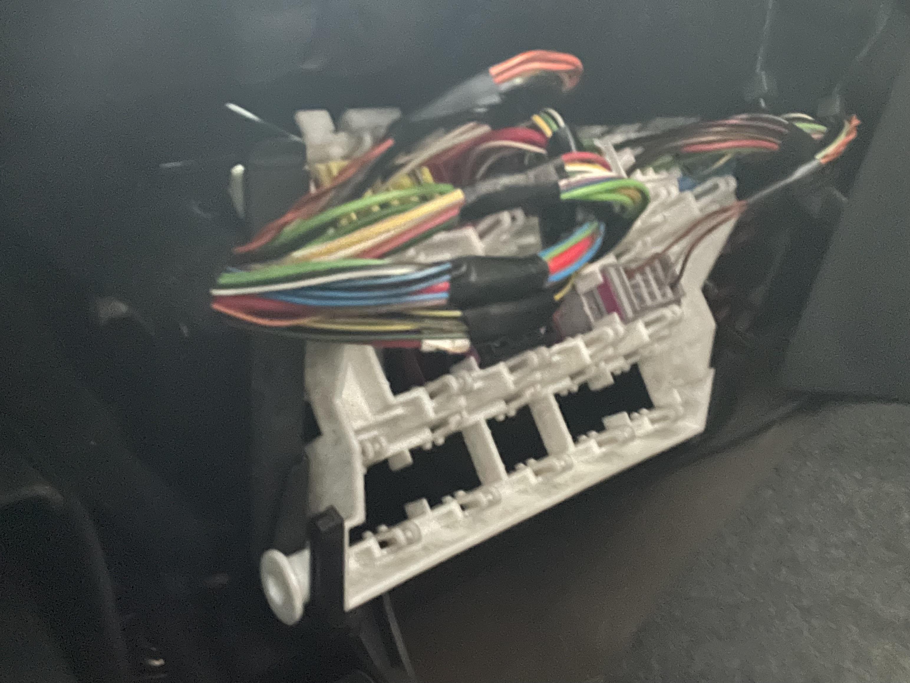

Loop_de_Lupo Posted May 4, 2025 Report Share Posted May 4, 2025 (edited) On 4/10/2015 at 10:23 AM, Pete said: They unclip from under and above and pull towards you, I'm sure you can unclip the whole bracket tho from the tab on each side and it gives enough space to get to the relays, it's all slotted in see so you undo the lug on either side, swing it towards you and pull out. Any more advice on this. I’ve removed the lower dashboard panels and can see the relay board. It looks like it should unclip and/or hinge down but I can’t work out how to release it. Edited July 21, 2025 by Loop_de_Lupo Typo 1 Quote Link to comment Share on other sites More sharing options...

Loop_de_Lupo Posted July 21, 2025 Report Share Posted July 21, 2025 Having given up trying to contort my fingers enough to finish the job, I gave in and got our specialist to do it when it was in for a service. Despite my early excitement, it still refuses to start sometimes and has cut out at a set of traffic lights so changing the relay hasn't cured the problem. Any pointers for where I should look next? Quote Link to comment Share on other sites More sharing options...
