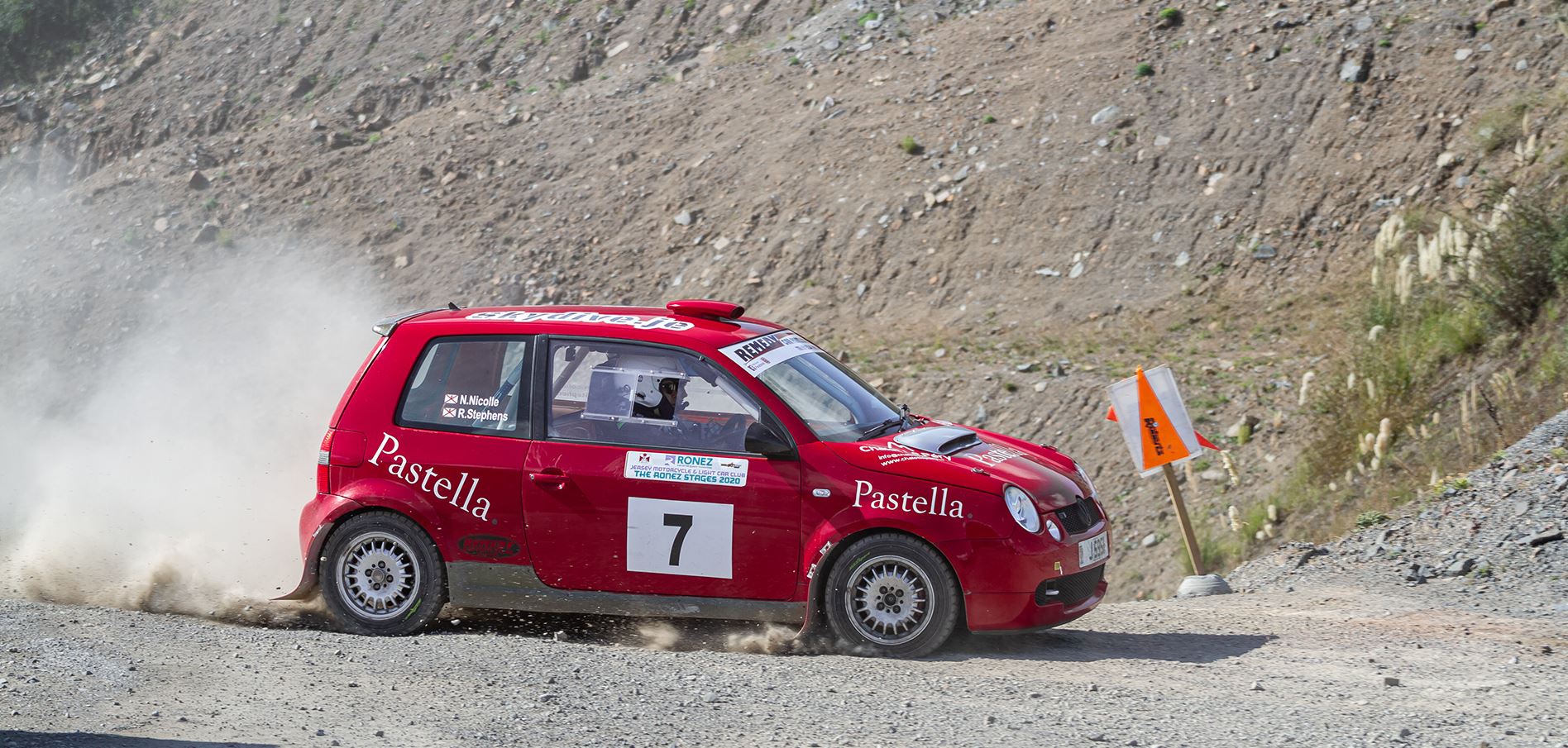

My GTI runs most of the time on 185 / 55  R14 80 T tires and has  6Jx 14 ET 43 rims. It is an economic decision. I use it as a daily drive to work. For "Sunday"  I have some Bathurst with 205 / 45 R15 81V.
