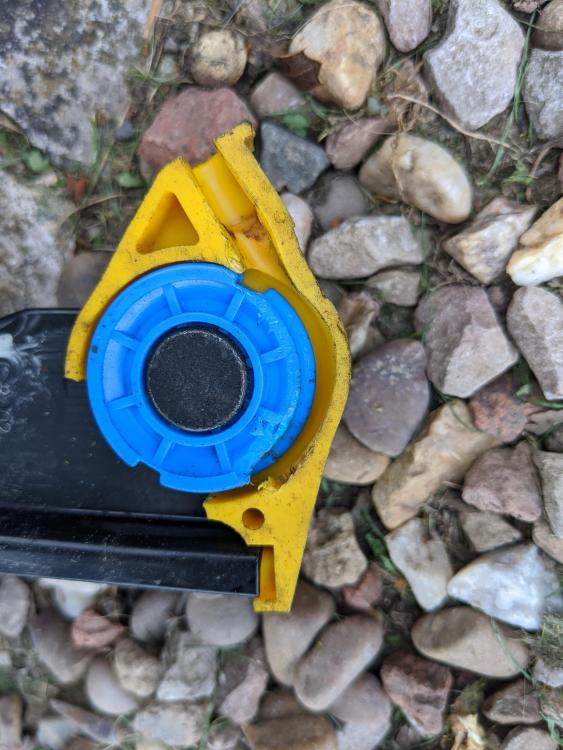

Just went out in the car and tried to wind the electric window down but heard a bit of a straining noise then it fell down and wouldn't go back up. Got the door stripped down and taken the mech out and I'm pretty sure that blue roller has snapped a bit off and the cable should wind around it. Any ideas where I can get either a repair kit or a replacement part? Should the cable that normally goes around it look like that or has it also been damaged?

The pulley that failed doesn't look original. I'm sure they're a white plastic, not blue and yellow. May have already been replaced before?

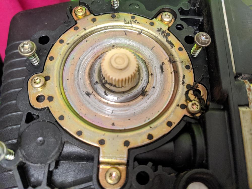

That last pic is OEM, but looks like vdub must have changed the design. Different to the one I took pics of from one of my Lupo SDI window mechs (in the how-to).
Can't believe all the shredded plastic everywhere. What a mess.
