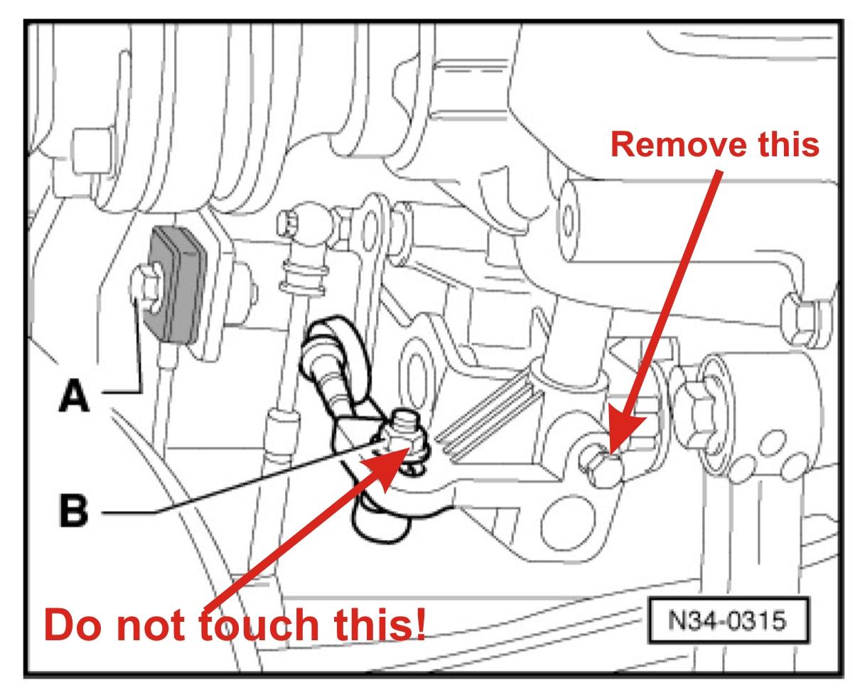

lupo 1.7sdi Posted May 1, 2020 Report Share Posted May 1, 2020 It is not easy to remove the oil seal. for this you need one or two thin screwdrivers (about 2mm in diameter), very sharp and hard (the oil seal has a metal ring under the plastic cover, a ring that must be perforated to hang and remove the oil seal). Basic rules: - Must not scratch the shaft (wrap thin layer of insulation tape around shaft). If this happens it will leak permanently. - Fill space between sealing lip and dust lip with grease - Do not touch the screw B. if necessary mark its position, otherwise you will need adjusting selector mechanism Selector finger Quote Link to comment Share on other sites More sharing options...
mk2 Posted May 1, 2020 Report Share Posted May 1, 2020 Yeah, when you remove/loosen that "remove this" bolt, you can end up with a burr on the end of the selector shaft. Run your fingers around the end of the selector shaft and see of you detect any sharp bits. You need to file them off else as soon as you slide on the new seal, you'll cut the lip and the new seal will leak (happened to me...). Quote Link to comment Share on other sites More sharing options...

RobArosa Posted May 4, 2020 Author Report Share Posted May 4, 2020 On 5/1/2020 at 7:24 AM, lupo 1.7sdi said: It is not easy to remove the oil seal. for this you need one or two thin screwdrivers (about 2mm in diameter), very sharp and hard (the oil seal has a metal ring under the plastic cover, a ring that must be perforated to hang and remove the oil seal). Basic rules: - Must not scratch the shaft (wrap thin layer of insulation tape around shaft). If this happens it will leak permanently. - Fill space between sealing lip and dust lip with grease - Do not touch the screw B. if necessary mark its position, otherwise you will need adjusting selector mechanism Selector finger Well I replaced the seal today and so far so good. Apart from being a bit of a faff to get the old one out it went pretty well. Shaft looked ok too so I greased the new seal up and knocked it in square with a socket. I'll see how it goes when it's warmed up as that's when it seems to drop the most oil but for now I'm happy. Thanks everyone for your help so far 2 Quote Link to comment Share on other sites More sharing options...
