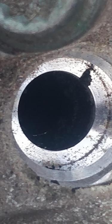

Another small update, I had some free time today so I did a fuel pressure test and took the injectors out to have a look.
Fuel pressure was at 35psi and when the vacuum line was taken off the regulator it went up to 45 like expected.
Fuel injectors are looking a bit sooty with dried oil in the injector wells and on the injector tips. Does this look especially concerning? I haven't owned or ran the car enough to tell if it's burning oil but the injectors definitely look a bit sorry for themselves.
I'm happy to have a play about with the car cos I have my astra, this car was for my girlfriend and myself to use as a cheap runaround to save on petrol and insurance :D
Any opinions are greatly appreciated.
Could be a clogged up injector  - try swapping cylinder 4 injector with another and see if the misfire moves to that cylinder
Take care re-inserting injector into fuel rail - they don't go all the way in - the clip limits its height
Edit : those injector seals look really crusty, probably could do with a clean and lube with thin smear of vaseline
