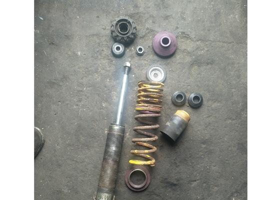

These are the new struts. Can anyone tell me exactly what I'll need to get so I don't have to disassemble the old struts? Bush, bearing and nut?
Or just get the bush and use the old bearing and nut?
Mounts, bearing and nut.
I'd suggest whipping the old struts off and just using a windy fun and your foot to disassemble, screw using spring compressors.
There's a stripped down to its entirety assembly.
