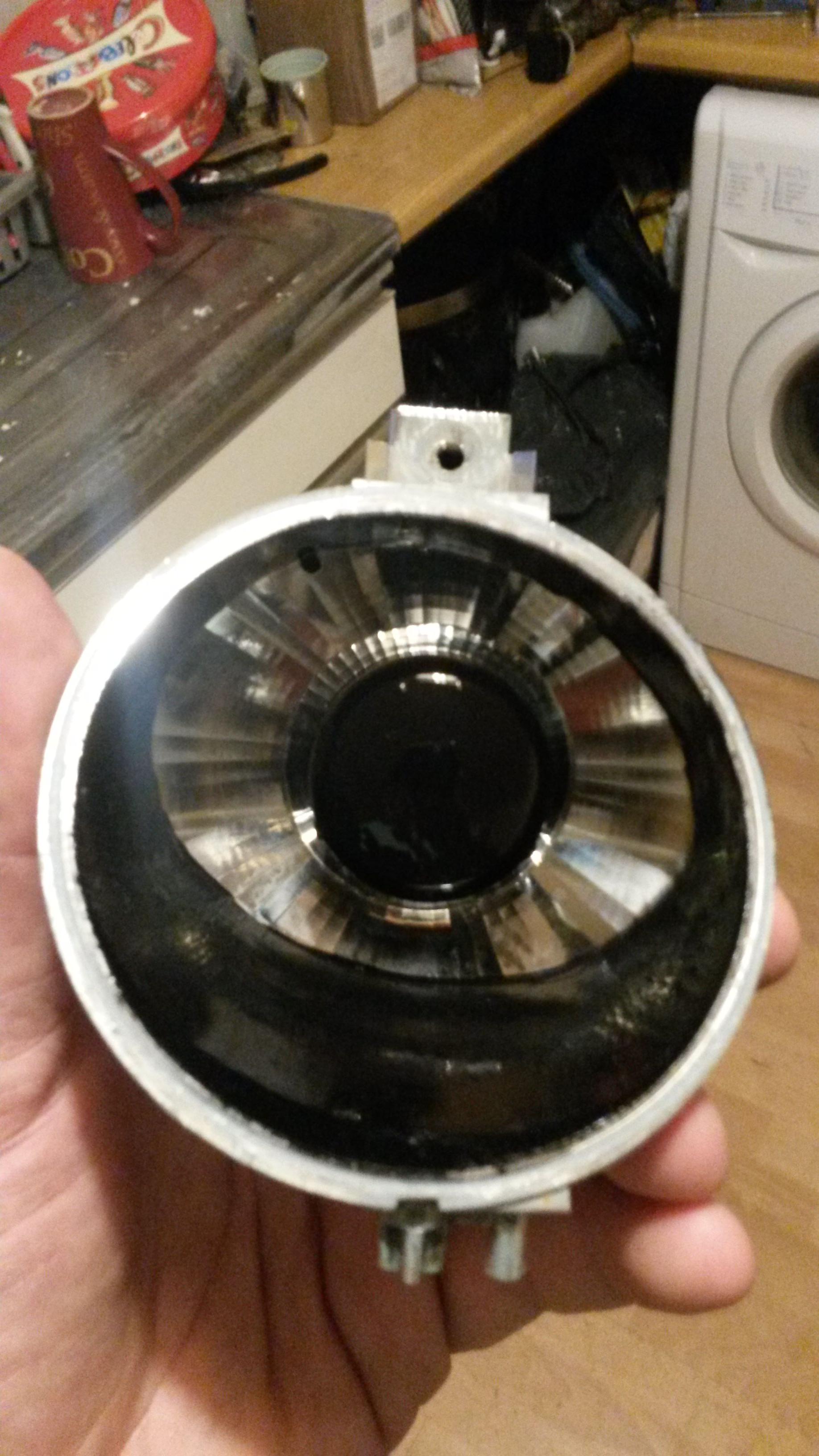

Thanks bud . The bumpers are standard bumpers just had them fully colour coded as for the front lights I split the headlights and joeyed them ie painted them black inside I also but a little red VW badge from a mk4 golf key on the bulb covers just for fun really . Lol yes we have mats in it now make a big difference.  Here is a picture of the lights back together and standard bumpers just colour coded as I said . Thanks for the input . Dave
Nicely done. You've done a really professional job on them. Superb.
How did you split the indicators apart? They are a right pain.... The centre covers are held by little plastic bits that snap clean off. And the reflective silvering on the inside just blows away when you think about looking at them!
Tbh with the headlights split easy so easy just put them in the oven for 5 minutes the indicators were a whole other story but I did them the same way but I ran a Stanley blade around the edge a few time but put them back in the oven ever time till the split took some time put was worth it I think . Ye the silver **** is crap as you say I just sanded it away in the indicators just leaving the rear reflector bit there and painted them black by hand and the headlights once you have them apart the front lip part is separate to the rear reflector so it becomes 3 pieces . Your right about the centre covers so I hard touched them I literally dropped the badge on with tweezers then just tapped it with my thumb to make just it was stuck down but I also put a damp of super glue on the back of the badge and left it over night to dry before I put them all back together.  Thanks. Dave
