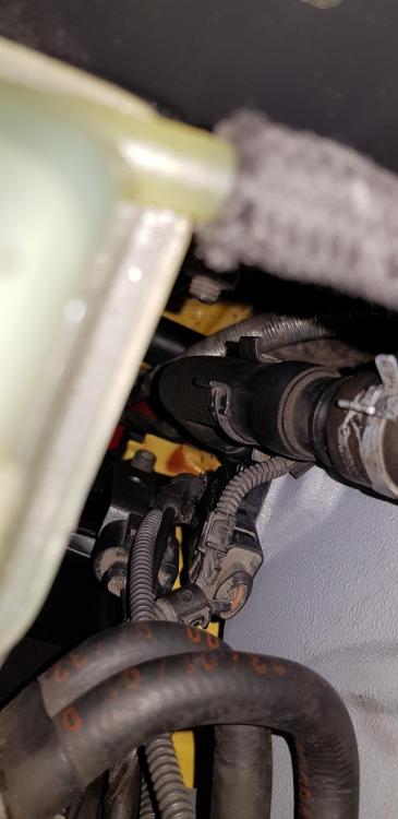

So drove to the MOT passed, no coolant light on the way but come on the way back. Slightly pressured, come back up to the min line once opened, but settled back down to 1cm under the min line.
But here's a few pics of the leaks.
Wanting to look into these more but off to Germany on the weekend, so going to need to put it on the back burner for 2 weeks.
New expansion tank, if that doesn't sort it then I'd start looking into steel seal and how to use it.
I'd be tempted to empty out the system, dry. Then pressurise to 15psi and put washing up detergent water on the outside. Find the bubbles... you've found the leak. All you need is a testing kit or a spare cap, fitted with a tyre valve :)
