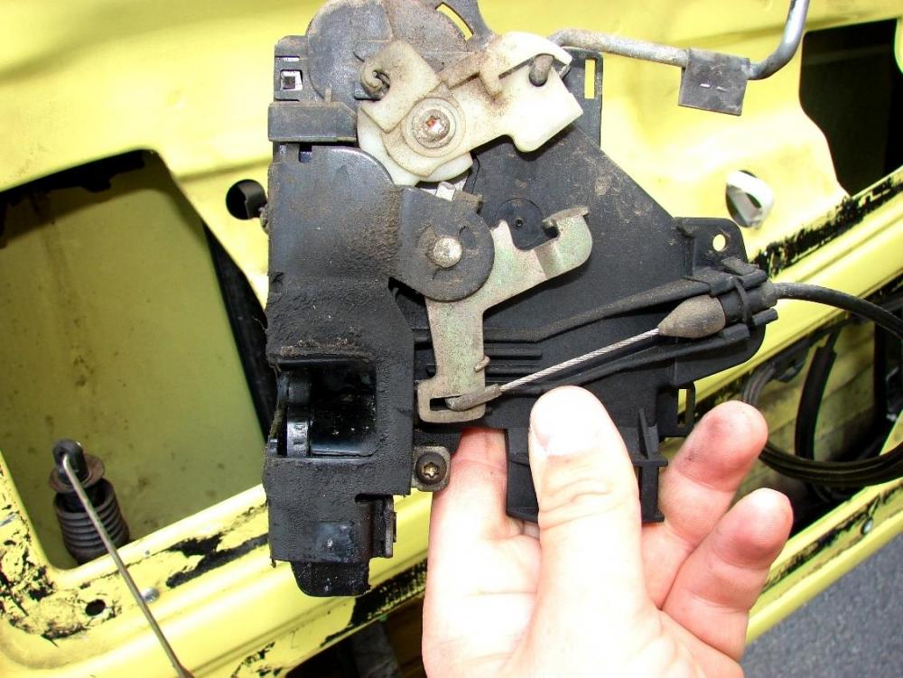

Hi guys, I need your help, please...
During some door maintenance, the locking rod came out of its position.
Do you think is broken or what?
Regards.
It's only held in the connecting piece by gravity really. Pain in the arse to get back into place. Not actually that useful on CL cars tbh.
Ok... But gosh what piece?
Use a torch (flashlight) to see where the end fits in... You can see how it locks or unlocks with a screwdriver.
How and where fit it?
Take off door card and water proofing layer and you will see... :)
Poor me... Someone has some pic to help me?
Edited by MORE
Ok, now it's clear... Thank u.:thumbup:
