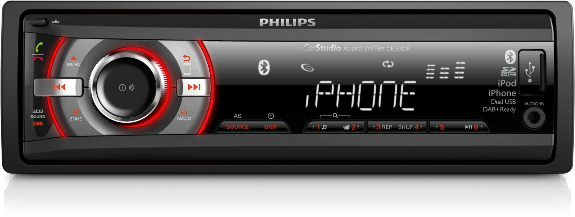

Ok, so after considerable research, I have chosen this thing- CE153DR- You can connect your phone via bluetooth (calls and music), SDCARD, USB, external input jack, line out for bass bins, spare rear USB to power other stuff (5v feed) and obviously radio... I like it:
CE153DR_05-_FP-global-001?$jpglarge$&hei
Ok, so it has no CD player, but hey, CD's are dead.
There is a "but"....
I bought it cheap, complete with the DAB option, but I personally still like FM radio better than DAB as it (really does) have better quality. Sadly us brits specified the original DAB system which is worse than FM. In europe they use DAB+ which is the same as FM. There are only four manufacturers of decent FM receiver circuits IMO, who are Kenwood, Sony, Philips and Blaupunkt (who get rebranded a bit).
Trouble is, us Lupo (and generally most Vdub owners) have beesting antennas on the roof. In the base of the antenna mount is a tiny circuit board which requires power, as it amplifies the radio signals that are picked up by the antenna 'stick', to give better reception. The power is provided down the coax cable which plugs into the radio. But that is only true for Vdub specified head units. If you measure the voltage on the centre pin of the antenna connector on the back of your radio (when it's on), chances are you'll see no volts. That's fine for a standard car antenna, but for a Vdub bee sting thing, you need at least 8.6V to get it to amplify. If you don't provide it with any volts, the effect is similar to having a regular antenna, that has been broken off- so you get poor reception- which is why I've read many times on this forum that people are never that impressed with after market radios... Now we know why! Blaupunkt do provide power as that is the basis for the Vdub units.
I plugged my new radio in and it was complete rubbish. It couldn't find the distant radio stations I usally listen to. Lots of hiss. I know there was a problem immediately, as from experience I've always found Phlips to be awesome when it comes to FM reception. Then the penny dropped. No power to the bee sting circuit board.
So yes, I had to hack the philips circuit board and solder in an RF power splitter feed (RF choke and decoupling capacitor, connected to 12V when set is powed up). Now it is as expected. Awesome.
Just be careful if you enjoy using the radio and fit a non-OEM head unit!!!! The radio might not work too well..... :)
