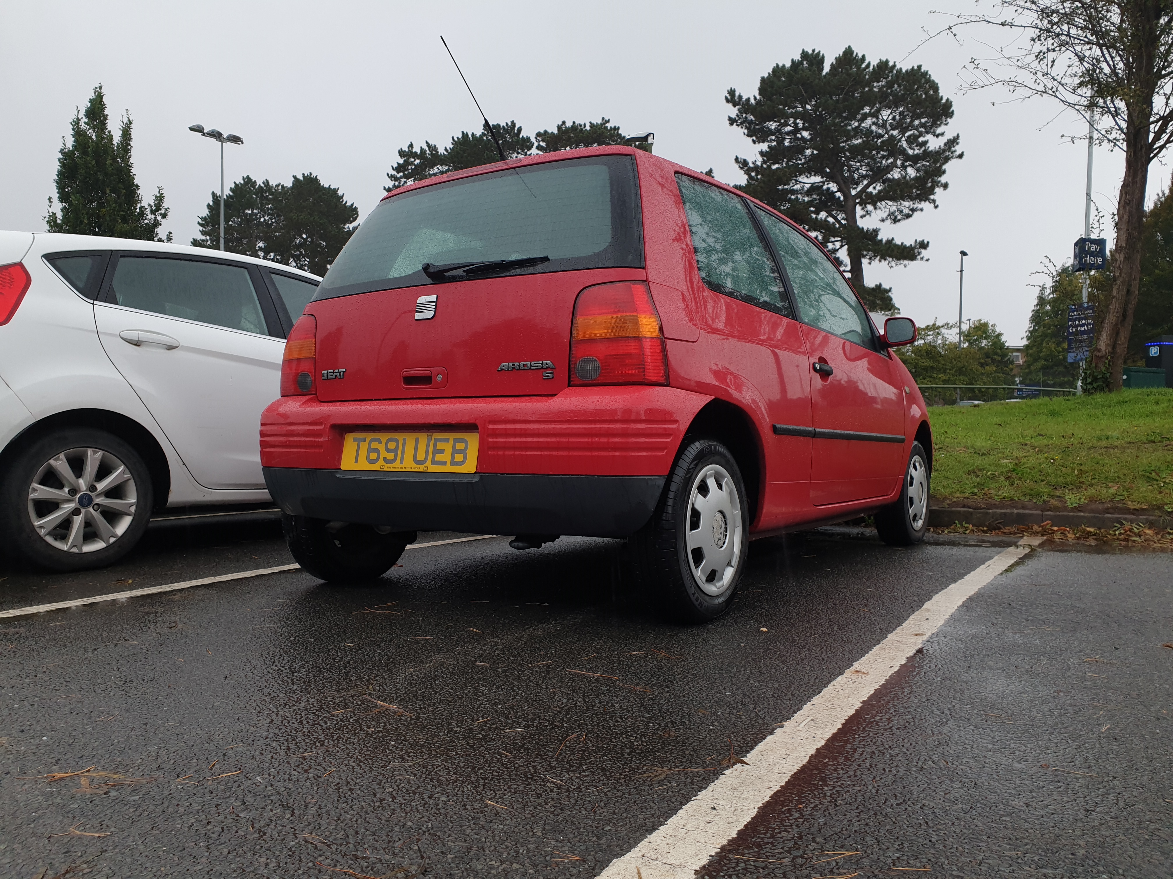

Then I started looking at lupos and Arosas again, as they're cheap and they're a platform I've worked with before, so now both the Mrs and I own MK1 1.4 Arosas with 60k miles each. Her's is tornado red (might be flash red, I can't actually remember) while mine is techno blue pearl.
Oh yes, I live in Worcester and the thermostat broke 5 miles out from Ipswich where I bought it, unfortunately it broke in the closed position, so tow poled it all the way back. I've since replaced the thermostat and it runs pretty good.

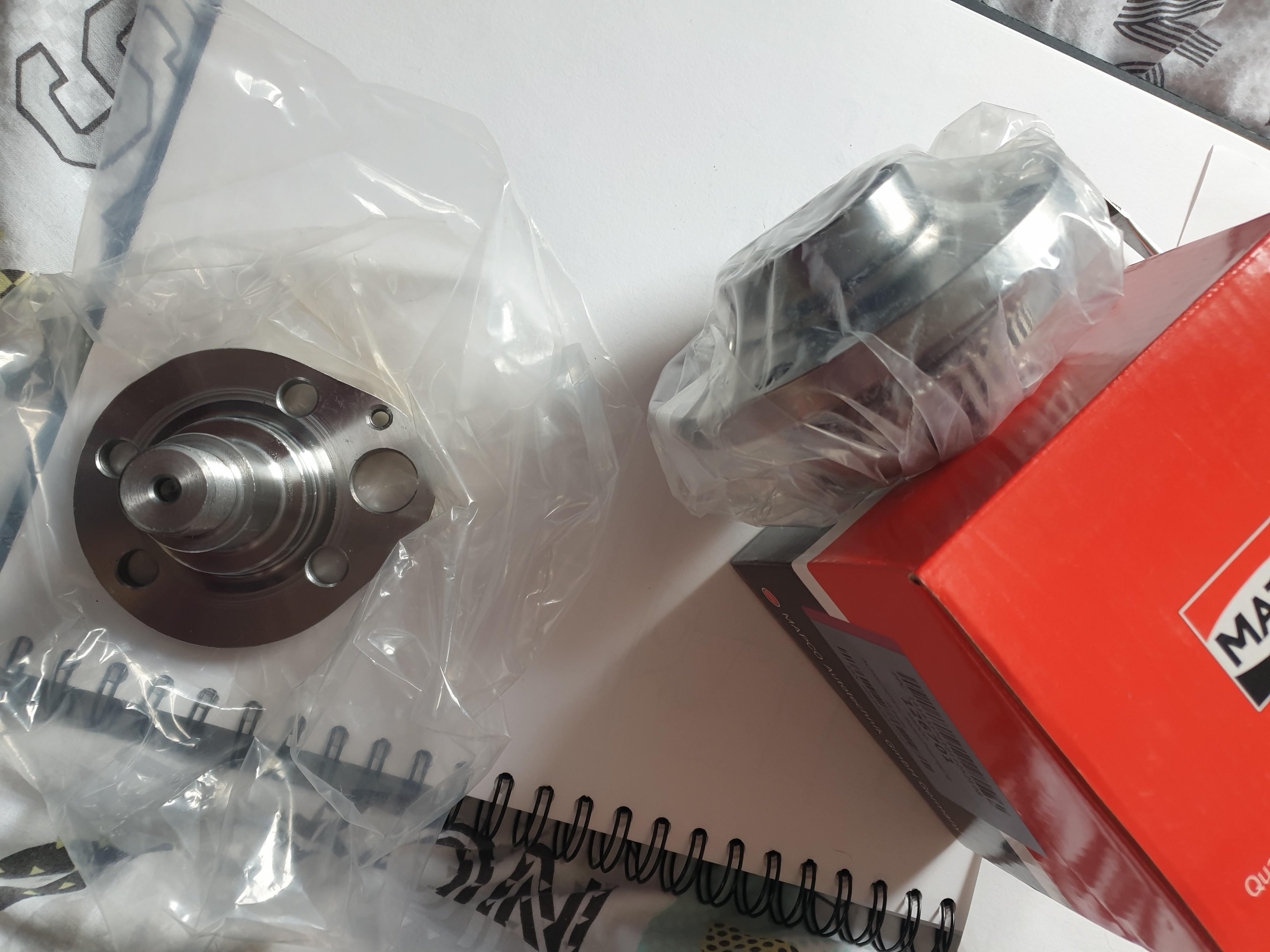

Also bought some stub axles and bearings to convert from the taper bearings that it cam with, as they have clearly failed prior to my ownership and I don't want to put them back together again when I get new drums and shoes.

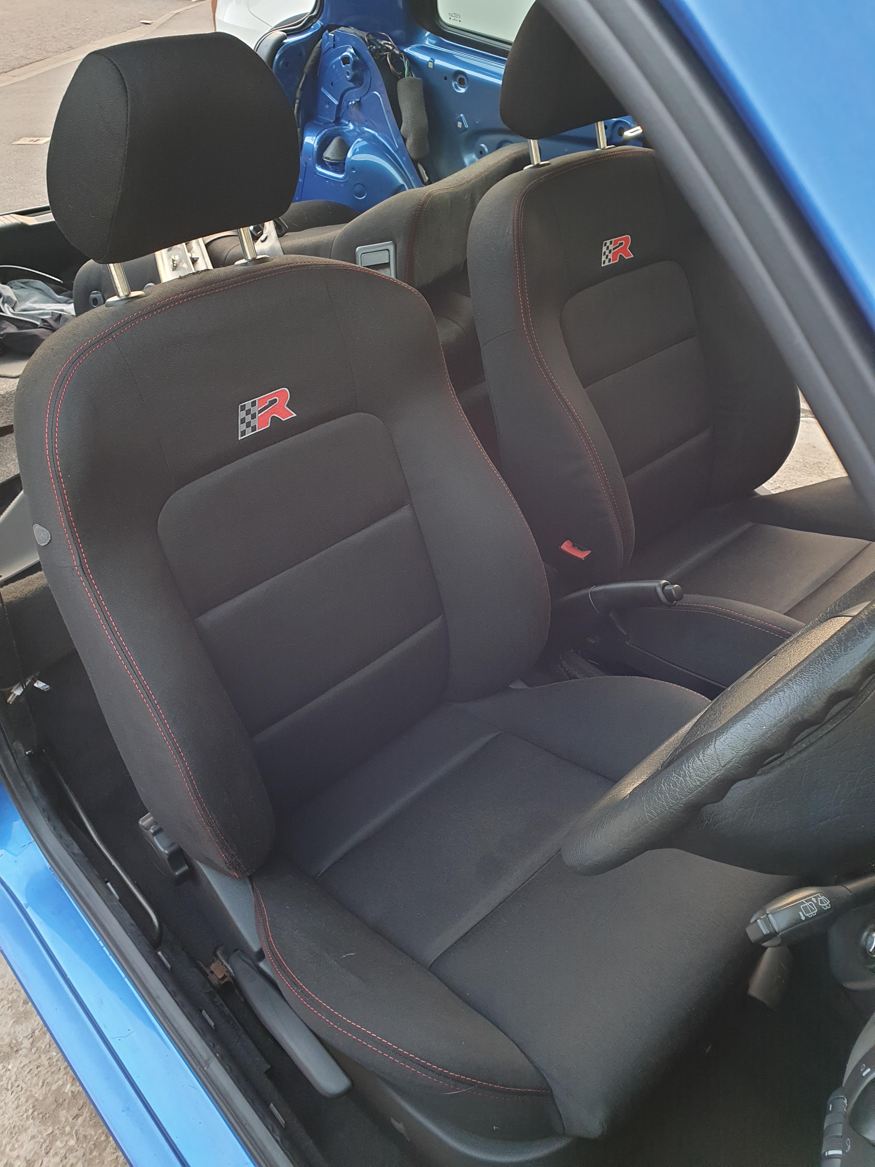

Realised I went MIA from this forum for a while, despite cleaning up my old seats i decided to go out and get mk1 cupra seats to keep to the Seat brand.

8 hours ago, C3peteo said:
Are those cupra seats a straight swap?
They're the same as the mk4 recaros, ideally need grinding down underneath slightly... or just take out the insulation under the carpet and it should be able to slide (bit difficult but manageable)

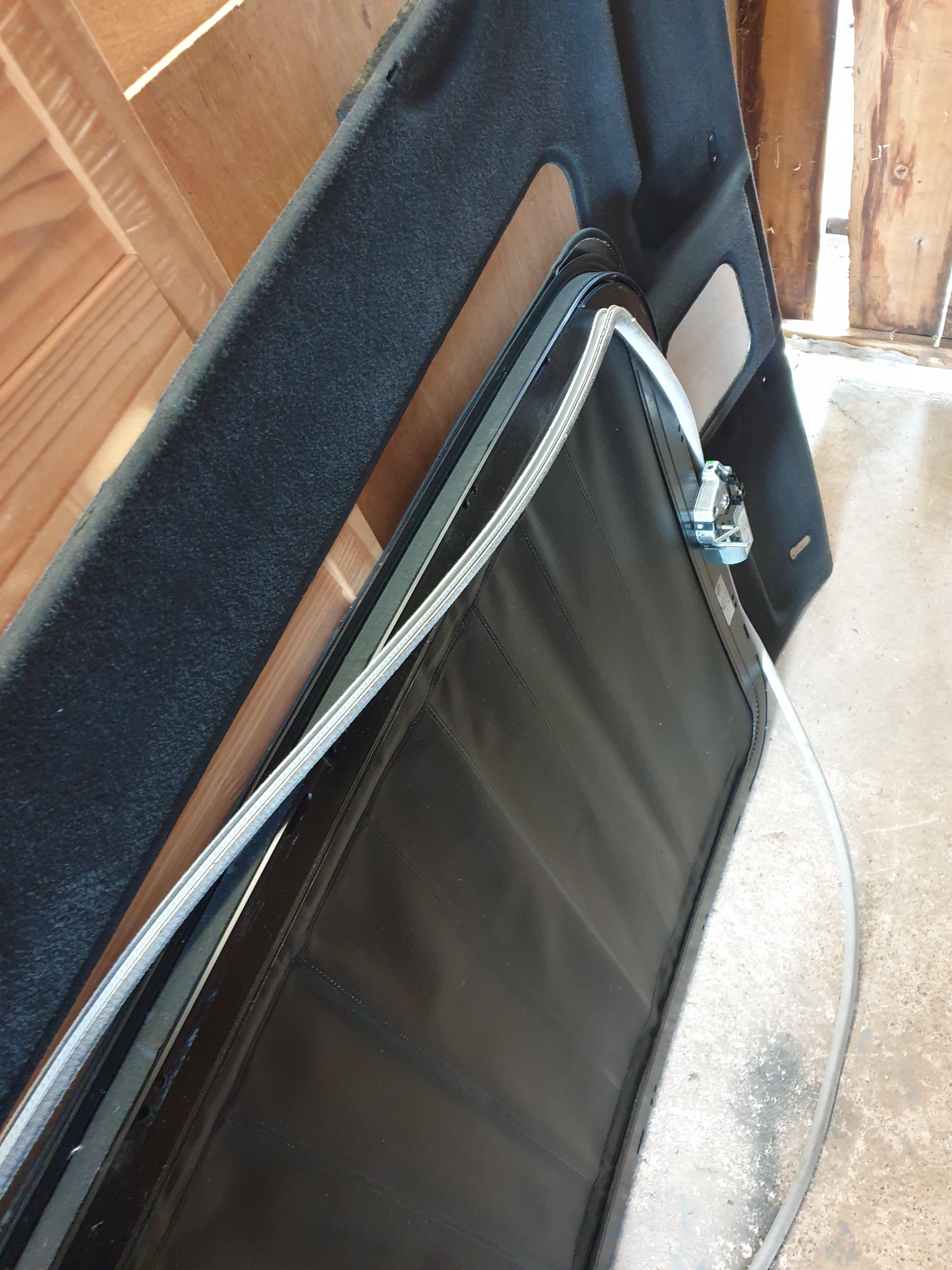

Dyed the roof and headliner for the openair, also got it fitted.

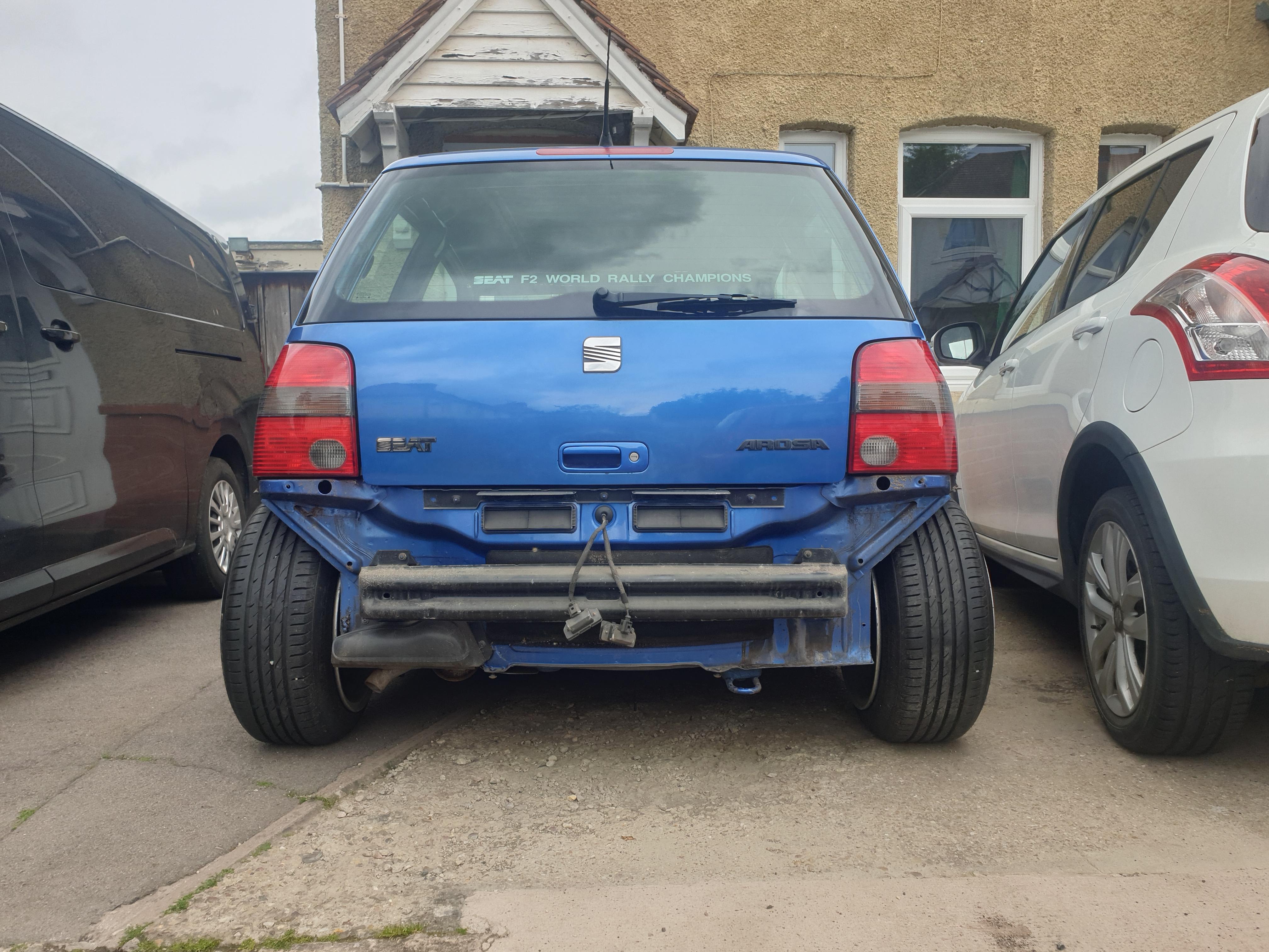

Decided that the other half and I should get some matching plates (she's an anime nerd and its just a funny thing we reference).
So of course I cleaned behind both bumpers before making a magnetic setup for the plates.
