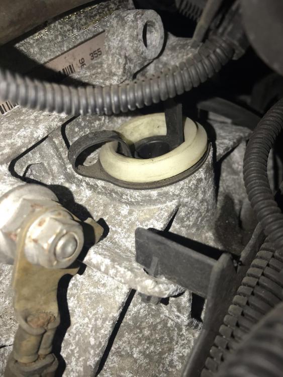

The first things and only thing have done is replace all spark plugs, which hasn't fixed the problem. The leads on top of them looked fine. But the long bit that plugs back on top of the plugs (if that makes sense) 2 of the rubber washes are split and loose. I also noticed there was bit of oil on the plug bit that screws in but the plugs themselves look fine. (I will attach a photo)

There is plug too the right and under the engine which was lifted up (photo attached) so I pushed that back down. No idea what that does.
IMG_8840.thumb.JPG.f300c55f8cb7a2d79c0a7ba8d7e28e53.JPGIMG_8841.thumb.JPG.fc7d31249664806c3776b11a94570a1e.JPG
Now looking under the car from the front, to the right of the pipe there is a block. Now this block is covered in oil except a small area which is shiny, it seems weird how this is so clean except everything else which makes me think something has come off? (photo attached)
IMG_8838.thumb.JPG.0c62dc1dfc4eb4b981b0c8831d674126.JPGIMG_8837.thumb.JPG.320a25b8d7c2ca6d05fd4f6e0bc5c149.JPG
And lastly i've noticed the cable release for the bonnet as got nicks in it like someone has tried to open it from under the car? (photo attached)
IMG_8842.thumb.JPG.6dcae165cbe50e3921ffa7b985fe2fde.JPGIMG_8843.thumb.JPG.8959c9887f3f5cfe474edc317e307984.JPG
I have got it booked in at mechanics tomorrow as Im really lost on what to do. But if any this sounds unusual let me know.
