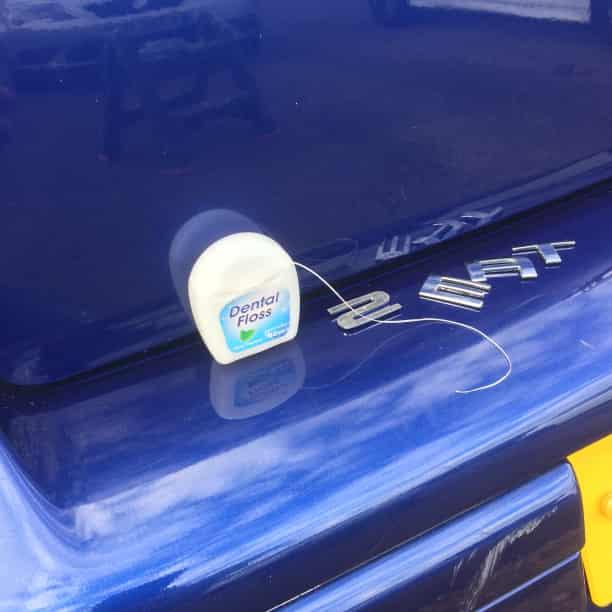

Want to remove your badges quickly & leave no damage to your paint?
1. Get your floss and saw it back & forth behind the individual letters.
You’ll be left with some sticky foam.
2. Attach a Eraser wheel in a cordless drill at max speed. Gently move across the foam back & forth. Keep removing the residue with a microfibre cloth.
3. Once all removed, wax it.
4. Ten minutes all done!32E151C1-0BC1-42AD-9BD8-9B881DB086A5.jpeg.63292a6e090464fd6d5614c142cd5518.jpeg
