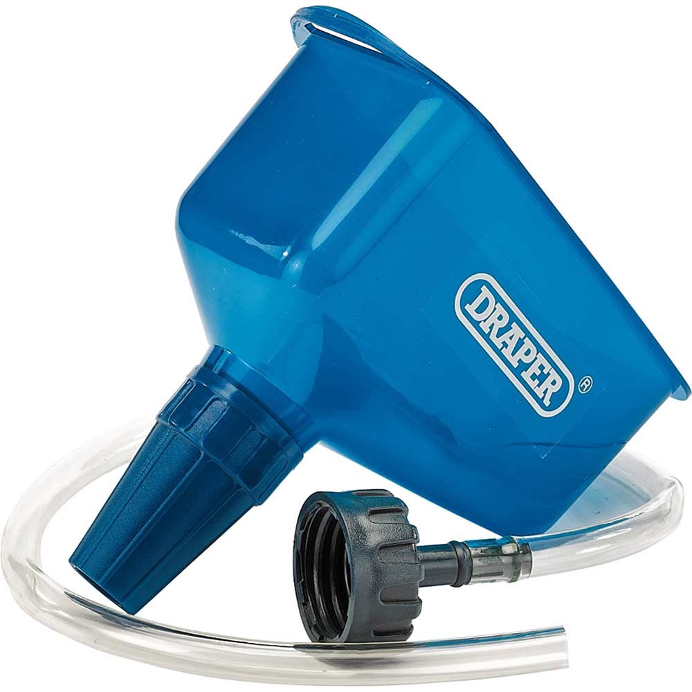

If you mean how to get the oil in there then make up or buy one of these with the tube on:
26327_SF2.jpg?w=1600&h=1600&404=default
I have used an old drinking water bottle with the bottom cut off and some tube zip tied on it, hung up with some wire on the bonnet. Use something with a large hole and large tube or it takes ages to fill the gearbox.
