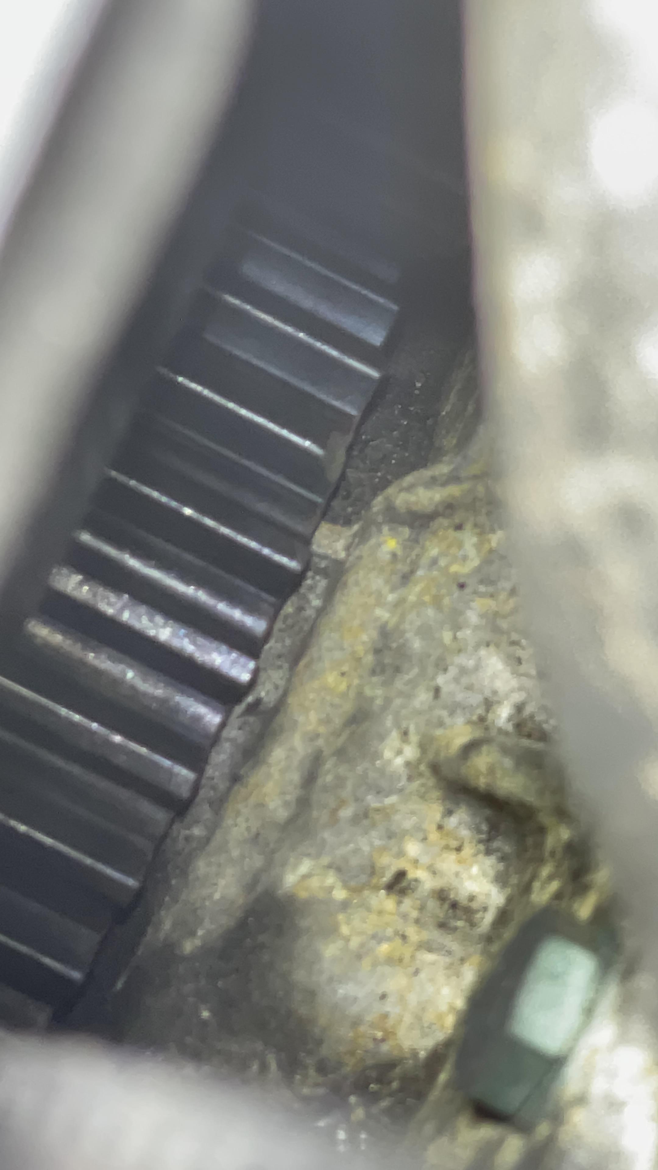

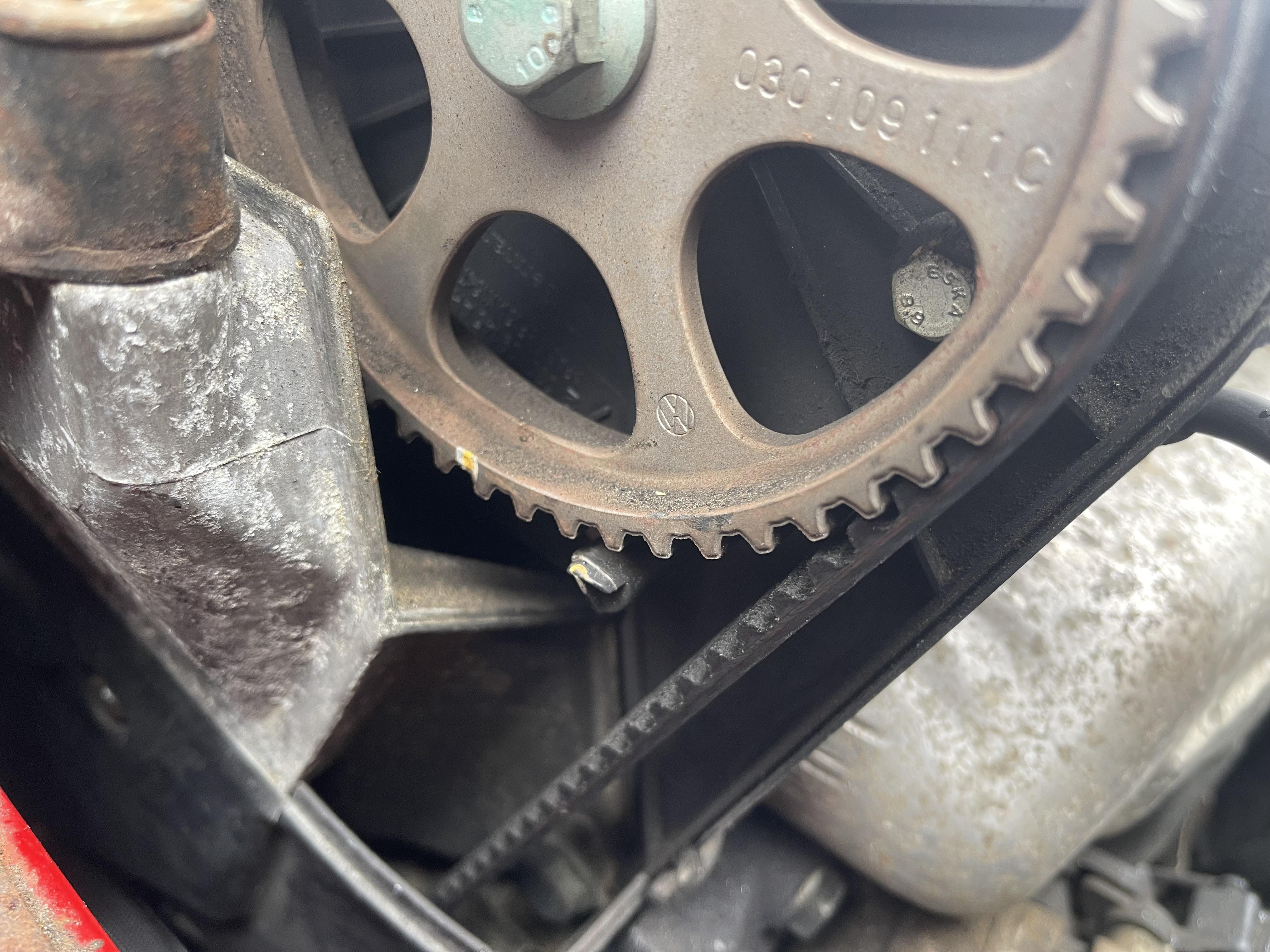

Shanks255 Posted April 14, 2025 Author Report Share Posted April 14, 2025 (edited) I couldn't see any marking on the fly wheel but I could see the one on the camshaft gear. As you can see the engine is slightly out of time. What would be the easiest way to slacken the belt enough to be able to match up the top gear? Ik there's a tensioner I should slaken but I can't get the bottom cam cover off because one of the bolts is being blocked by the aux belt pulley. I could pull off the aux belt and try but I wanted to see what the consensus was on the easiest way. Thanks. Edited April 14, 2025 by Shanks255 1 Quote Link to comment Share on other sites More sharing options...
Shanks255 Posted April 14, 2025 Author Report Share Posted April 14, 2025 UPDATE Its fixed! Turns out it was the timing belt that had jumped a couple of teeth. I prised it off using a pry bar and then did the same in reverse while pushing the car 😭. @mk2 thank you for suggesting it was the timing belt you've singlehandedly saved my sanity. And thanks to everyone else for your suggestions. Idk where I'd be without this forum . 1 Quote Link to comment Share on other sites More sharing options...
