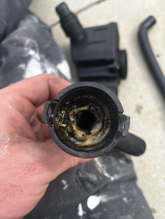

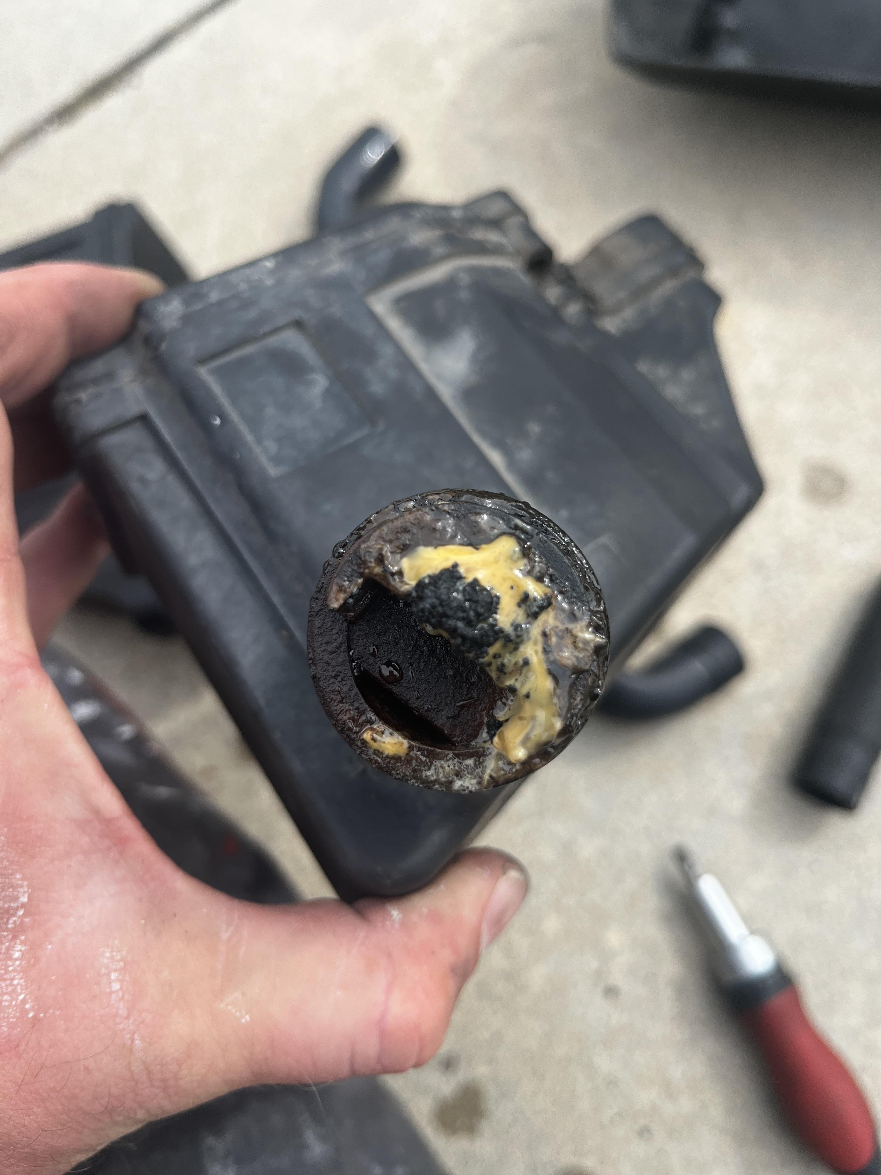

Euangti Posted April 12 Author Report Share Posted April 12 I also changed the crankcase breather and pipe as I’d ordered it before it failed the MOT. It didn’t solve the emissions problem but I’m sure it wasn’t helping looking like this 1 Quote Link to comment Share on other sites More sharing options...
