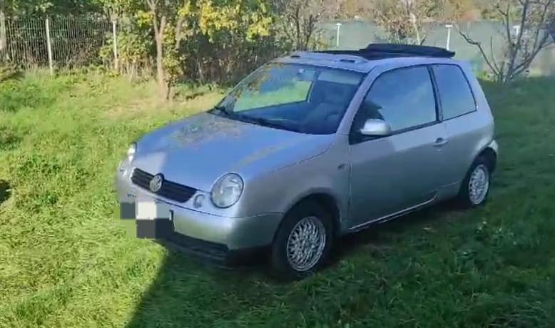

Thedriver Posted March 31 Author Report Share Posted March 31 (edited) What do you think? Edited March 31 by Thedriver Quote Link to comment Share on other sites More sharing options...
mk2 Posted March 31 Report Share Posted March 31 Hey hey, an open air with BBS alloys! Nice 👍🏻 Why do you need to remove everything? That is a lot of work... It looks good. Quote Link to comment Share on other sites More sharing options...
Thedriver Posted April 1 Author Report Share Posted April 1 Thanks! I think it really look good! I want to remove some parts because I want to know my car perfectly... Quote Link to comment Share on other sites More sharing options...
mk2 Posted April 1 Report Share Posted April 1 You can remove the engine under tray and wing liners to check everything. You can see from below the car. You don't need to remove the wings and bonnet. I would check inside the sills for corrosion. You need to remove the rubber bungs to have a look. If necessary, you can spray more wax inside when it is dry. 👍🏻 2 Quote Link to comment Share on other sites More sharing options...
