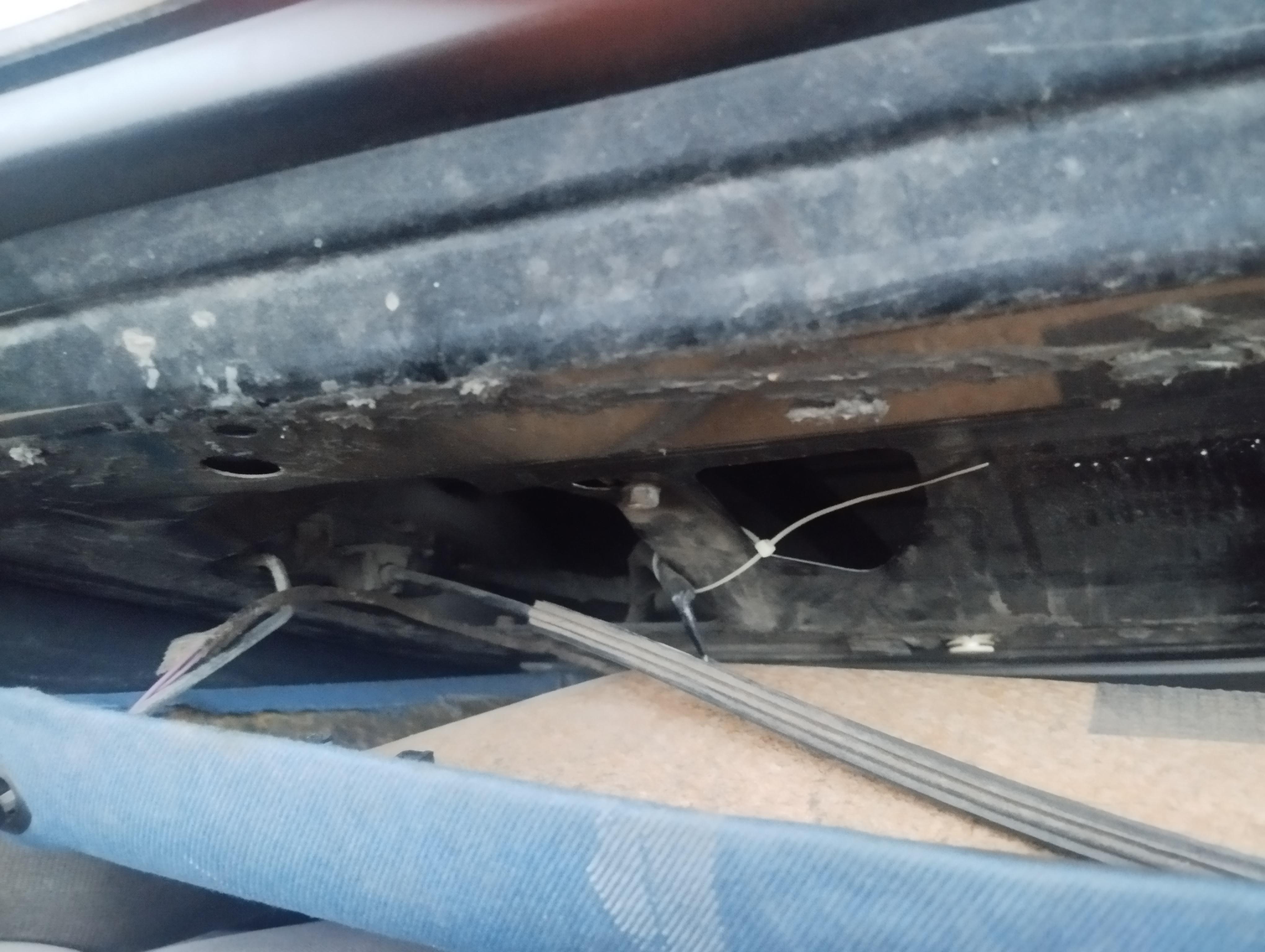

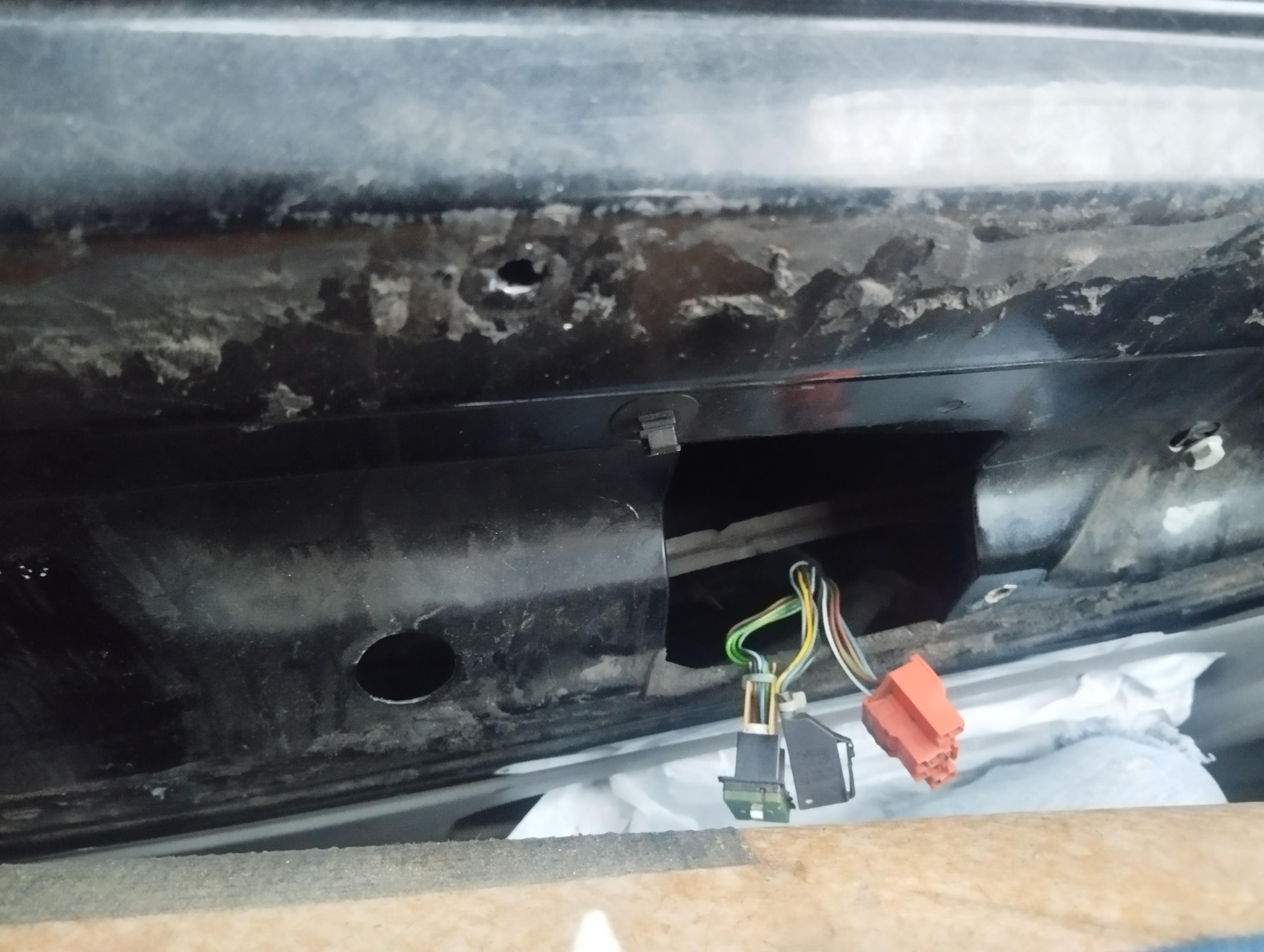

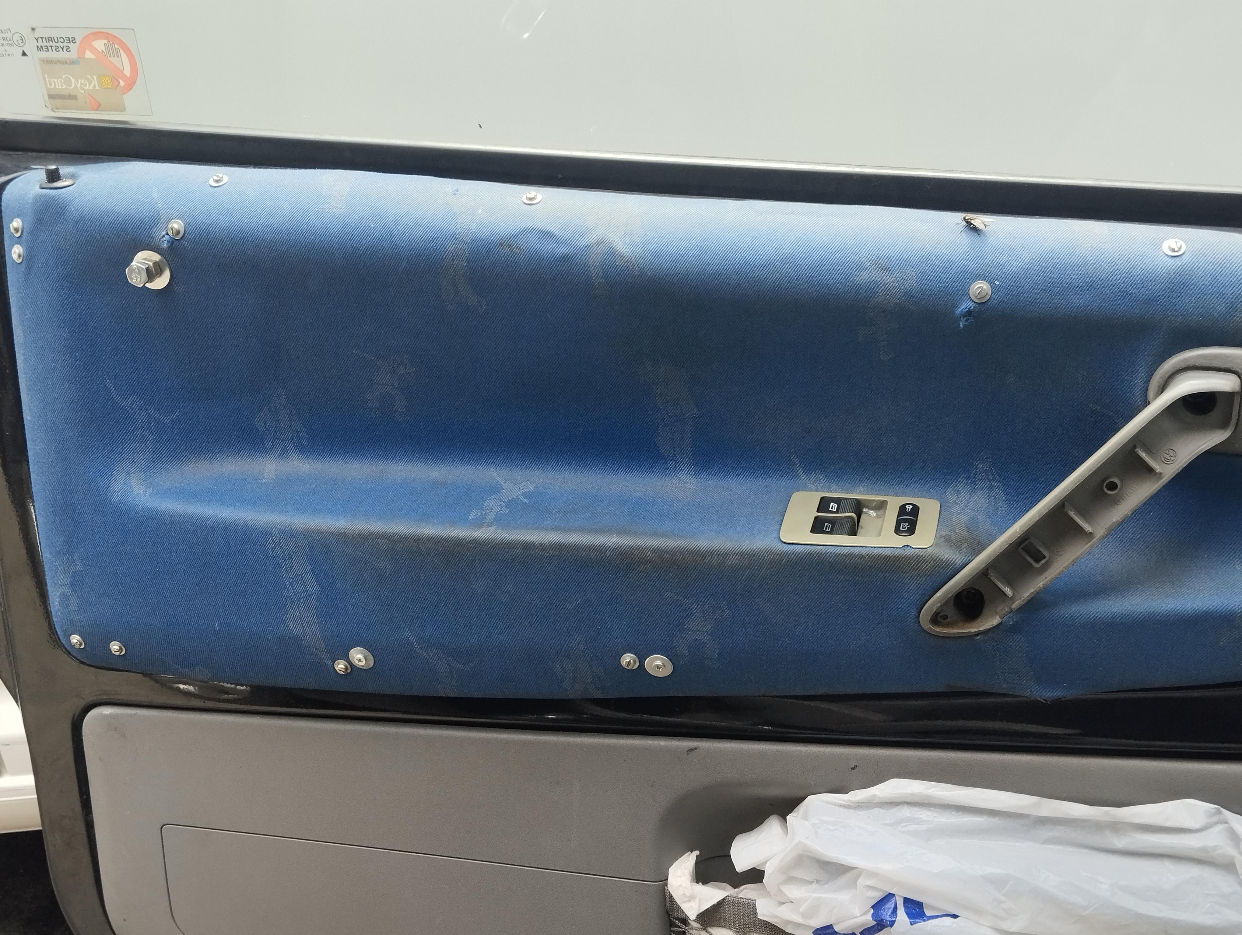

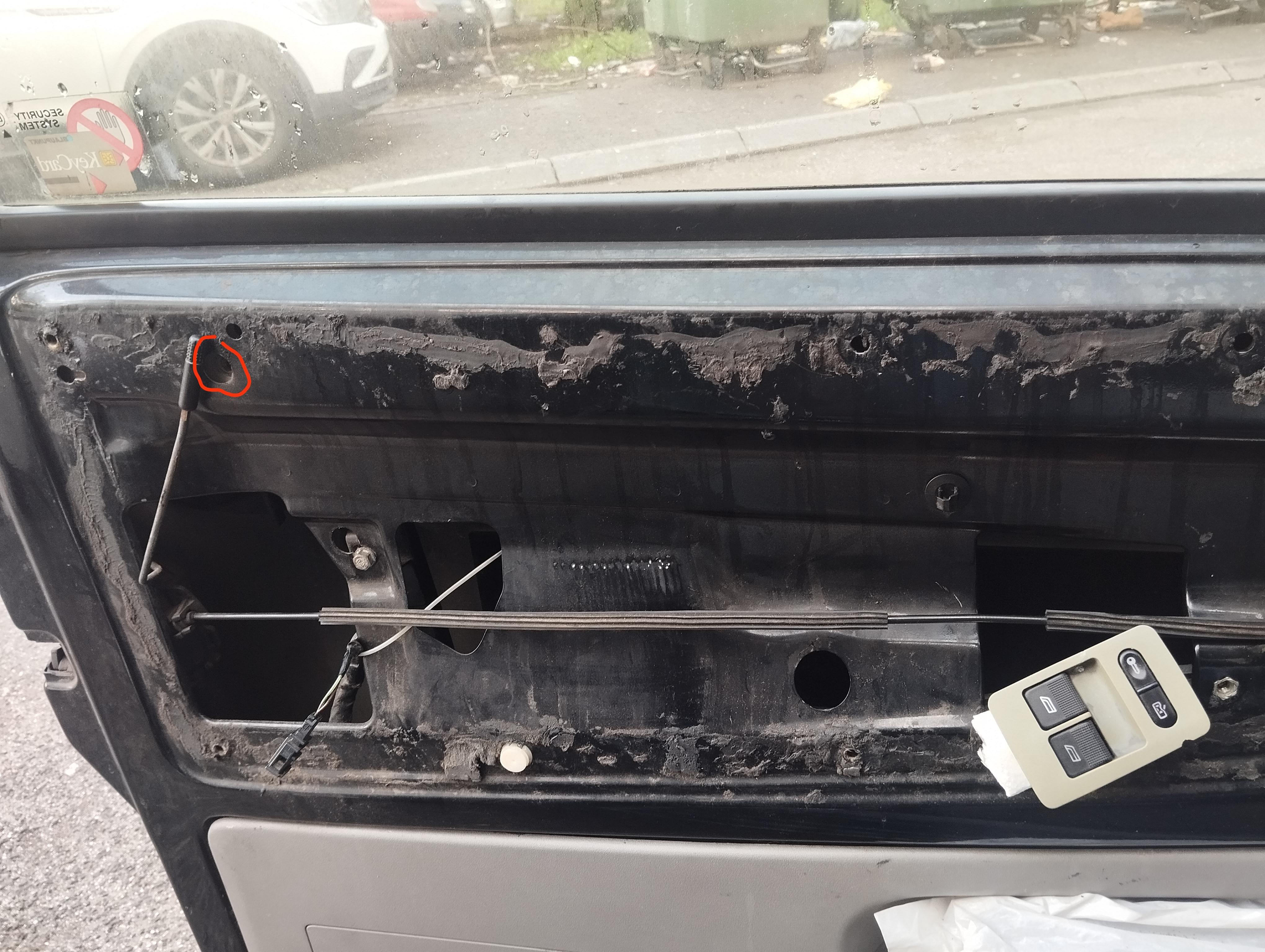

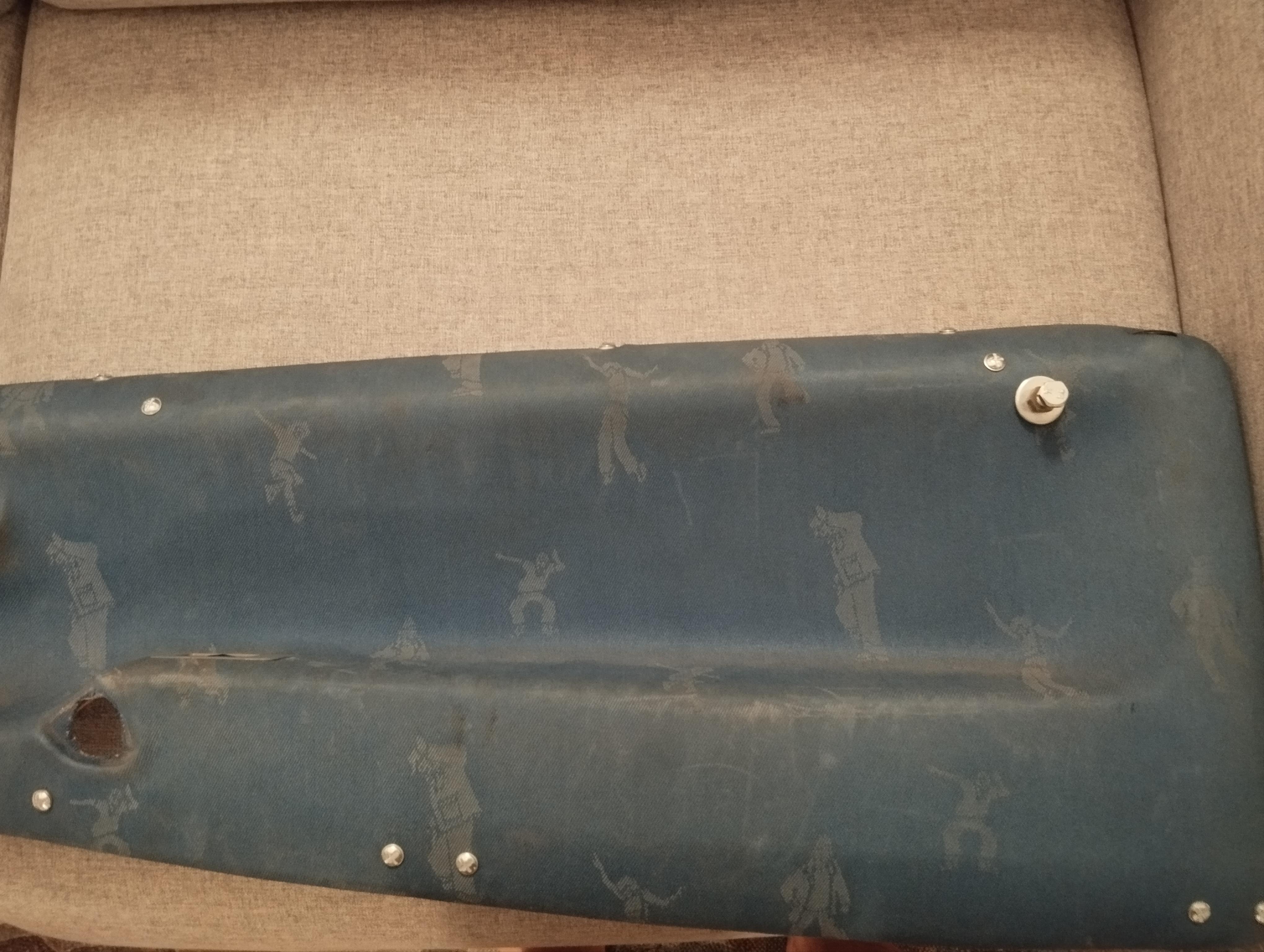

VlatcheLupo Posted April 14, 2025 Author Report Share Posted April 14, 2025 (edited) Still work to do but putting screws to hold the plastic frame on the top works Used glue but it didn't stick at some points But screws and glue together could work Edited April 14, 2025 by VlatcheLupo Quote Link to comment Share on other sites More sharing options...

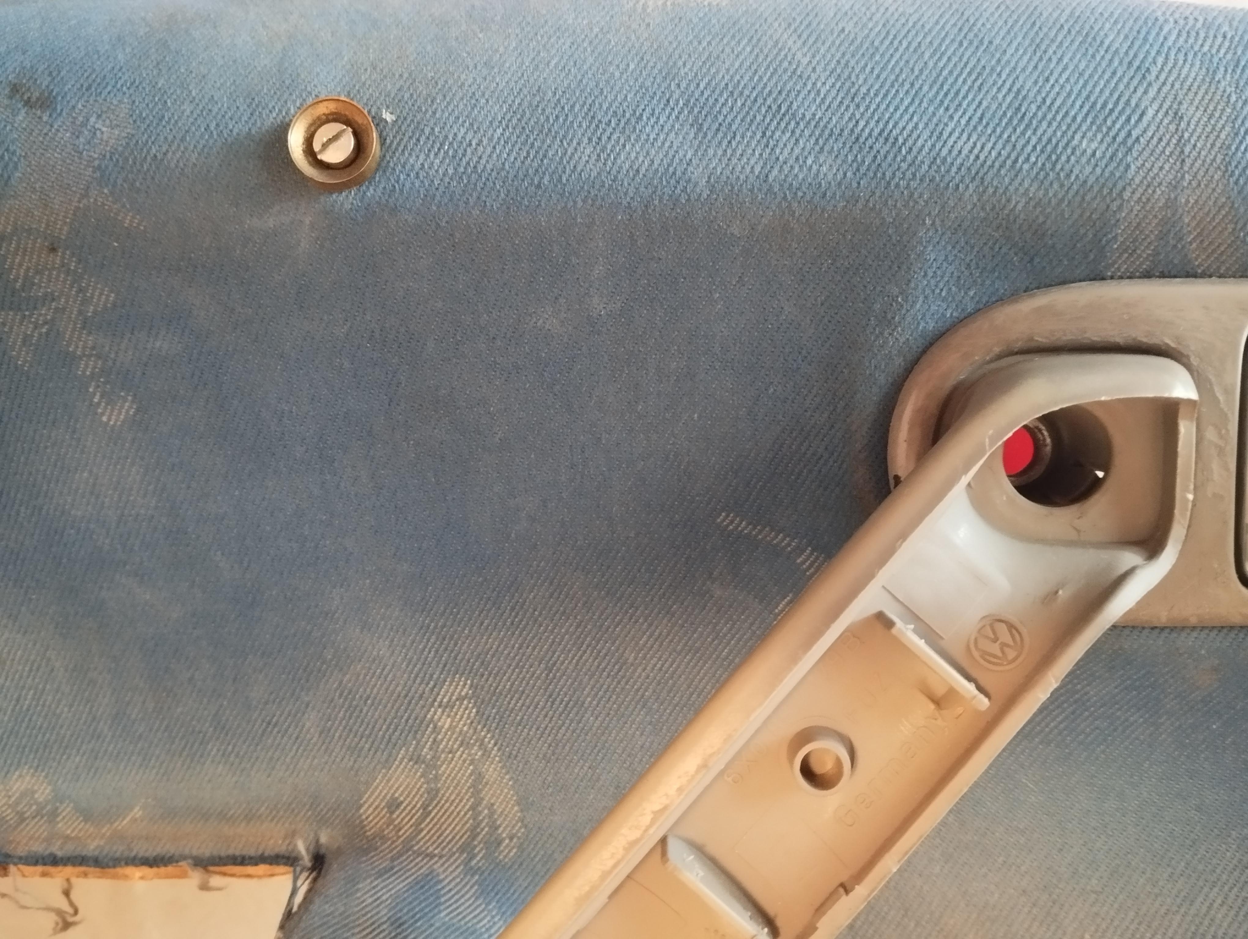

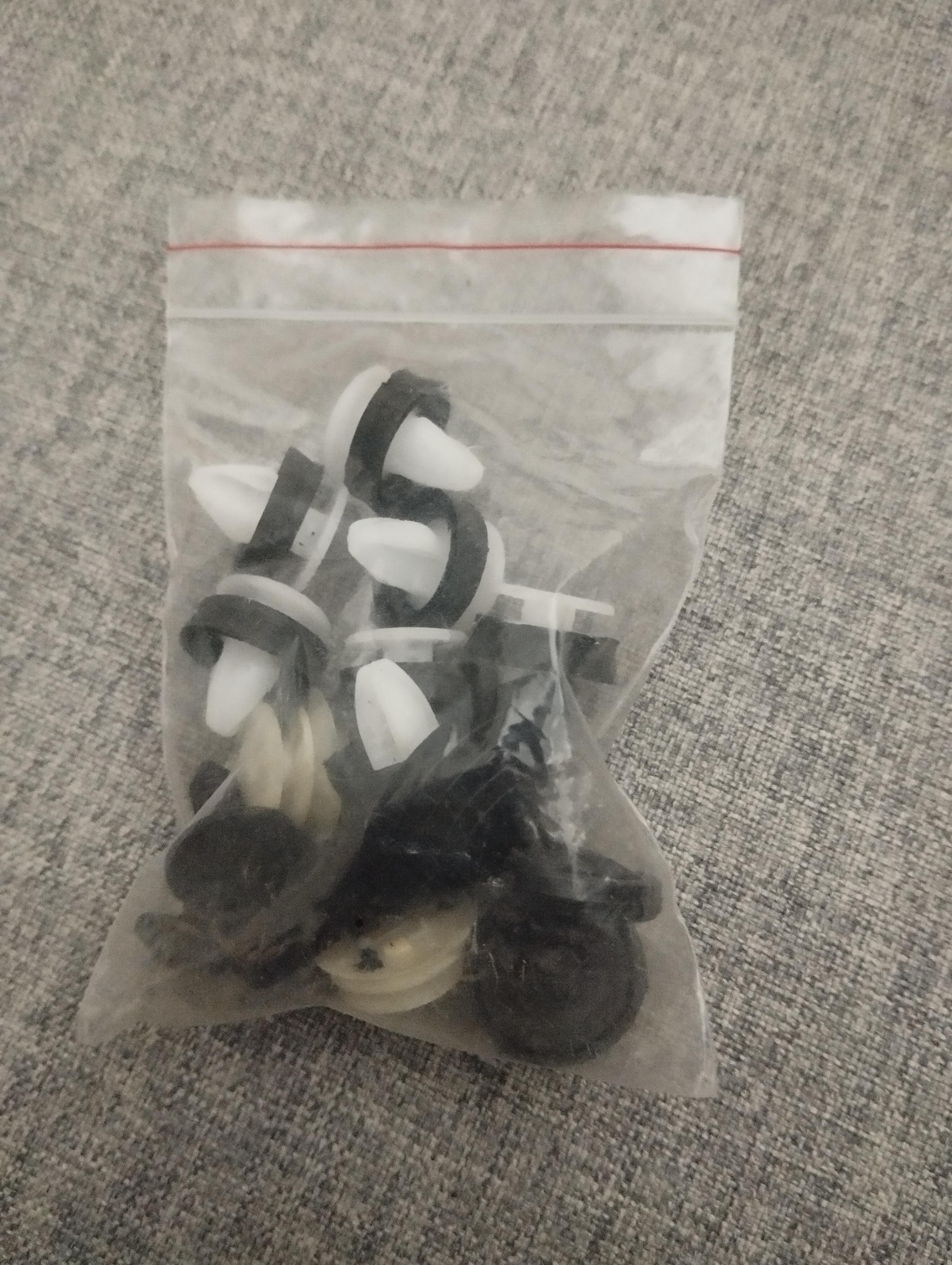

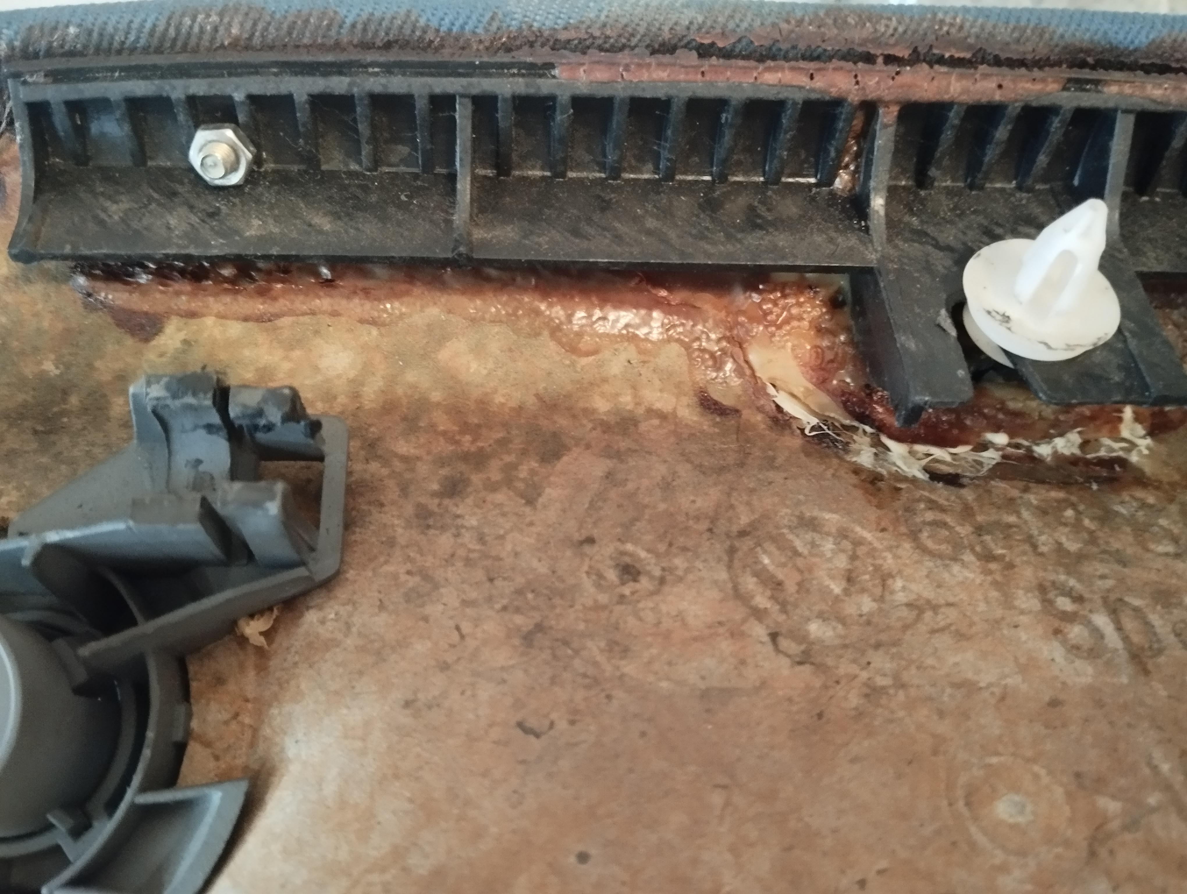

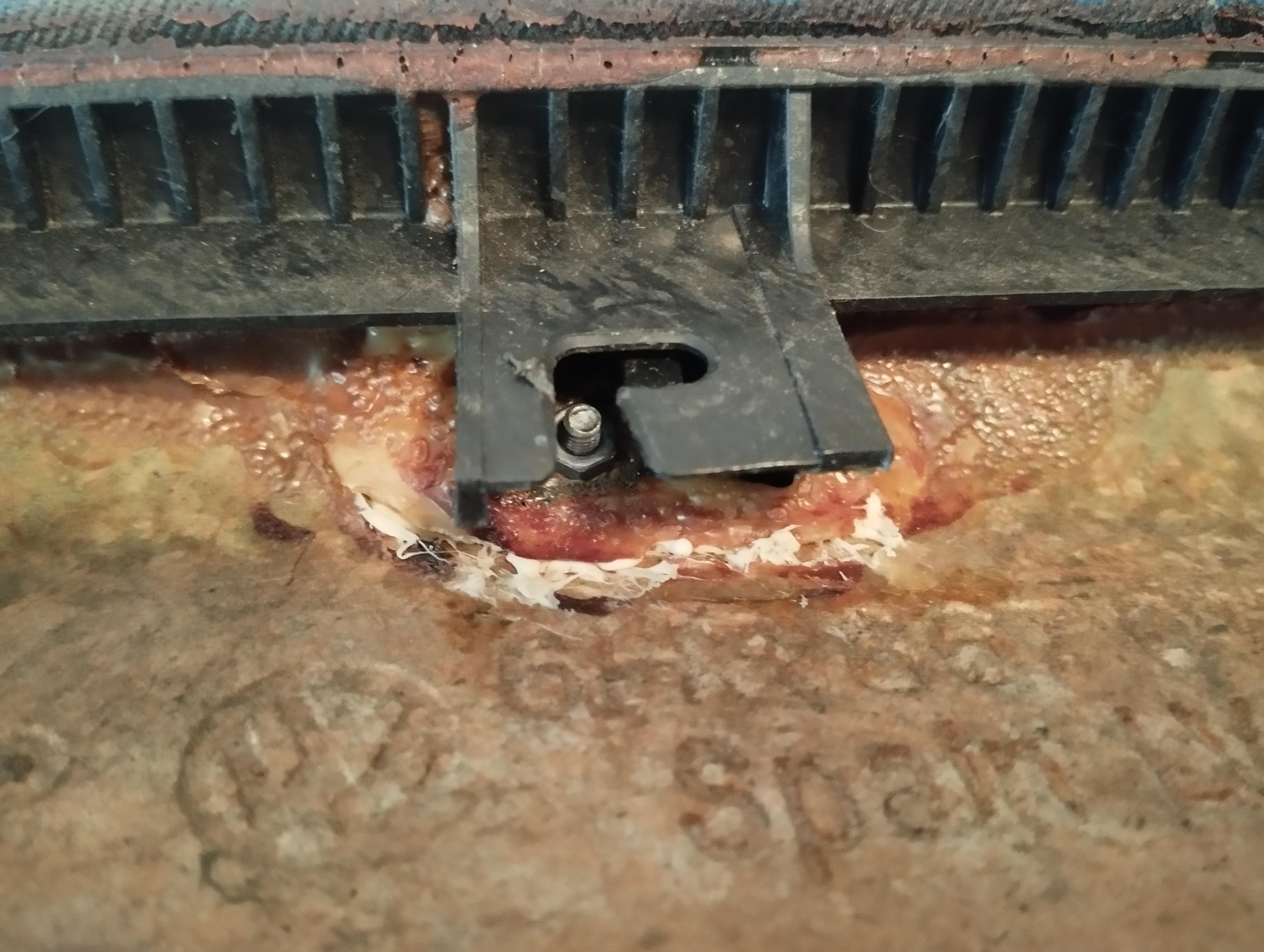

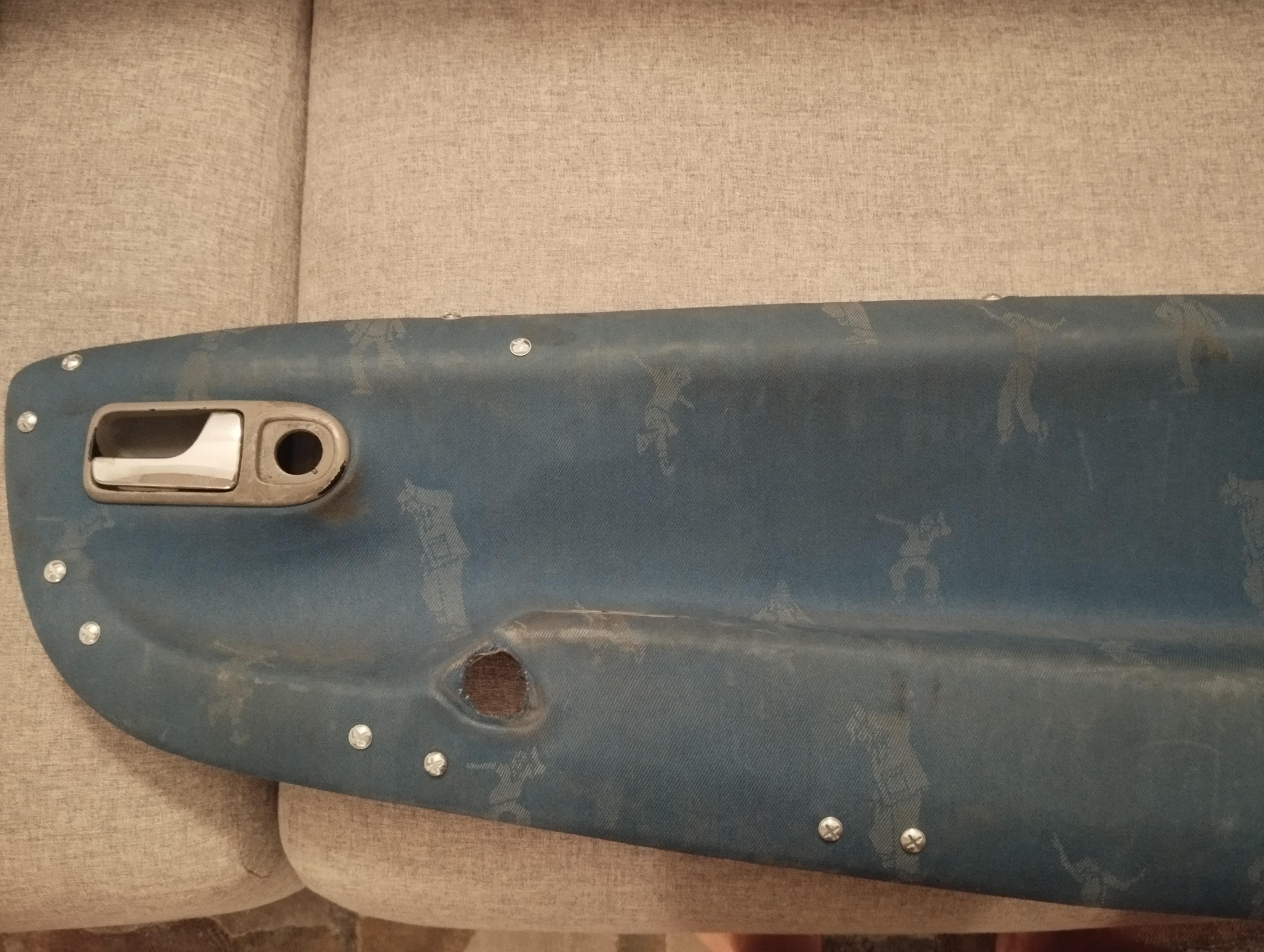

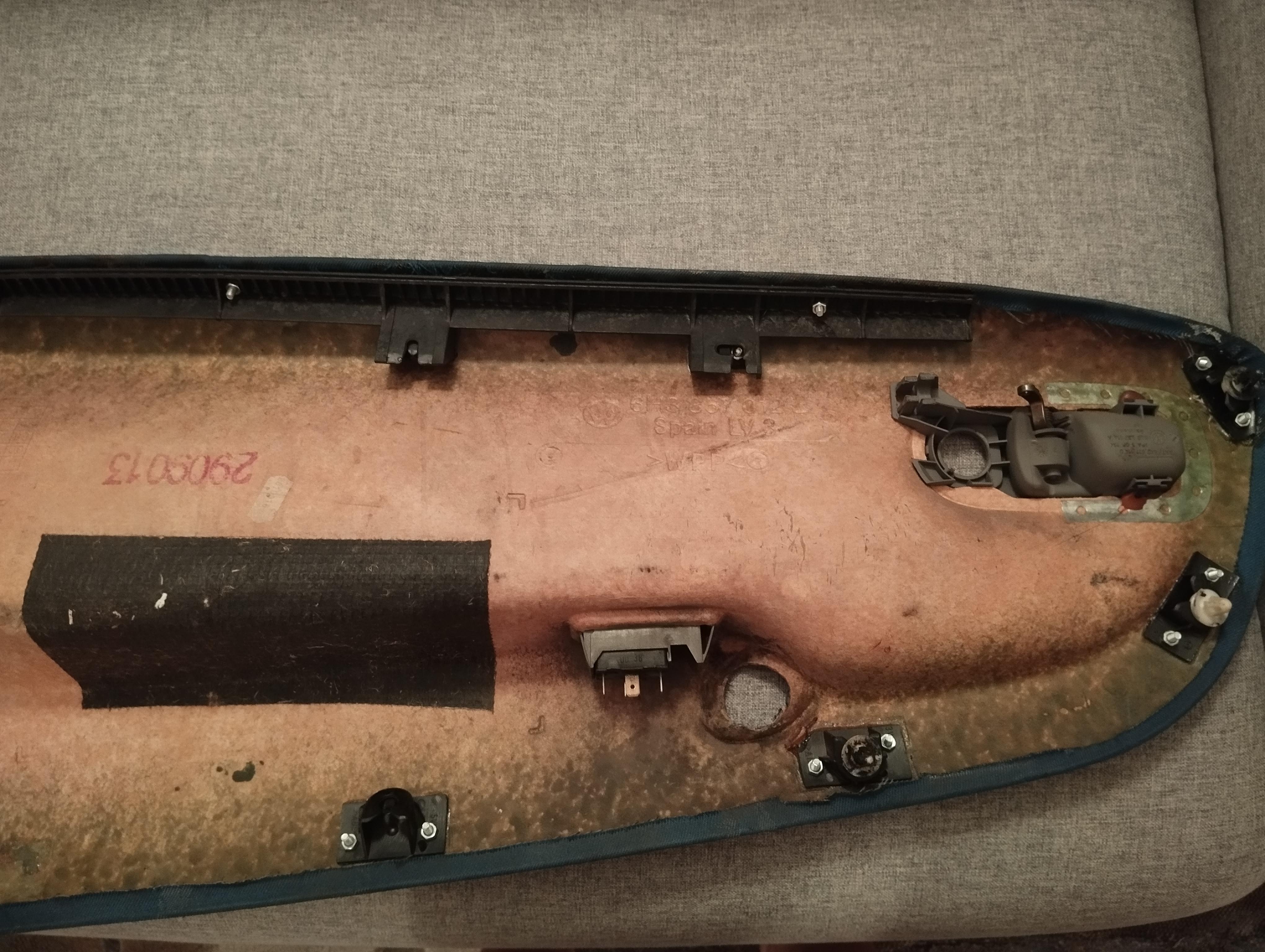

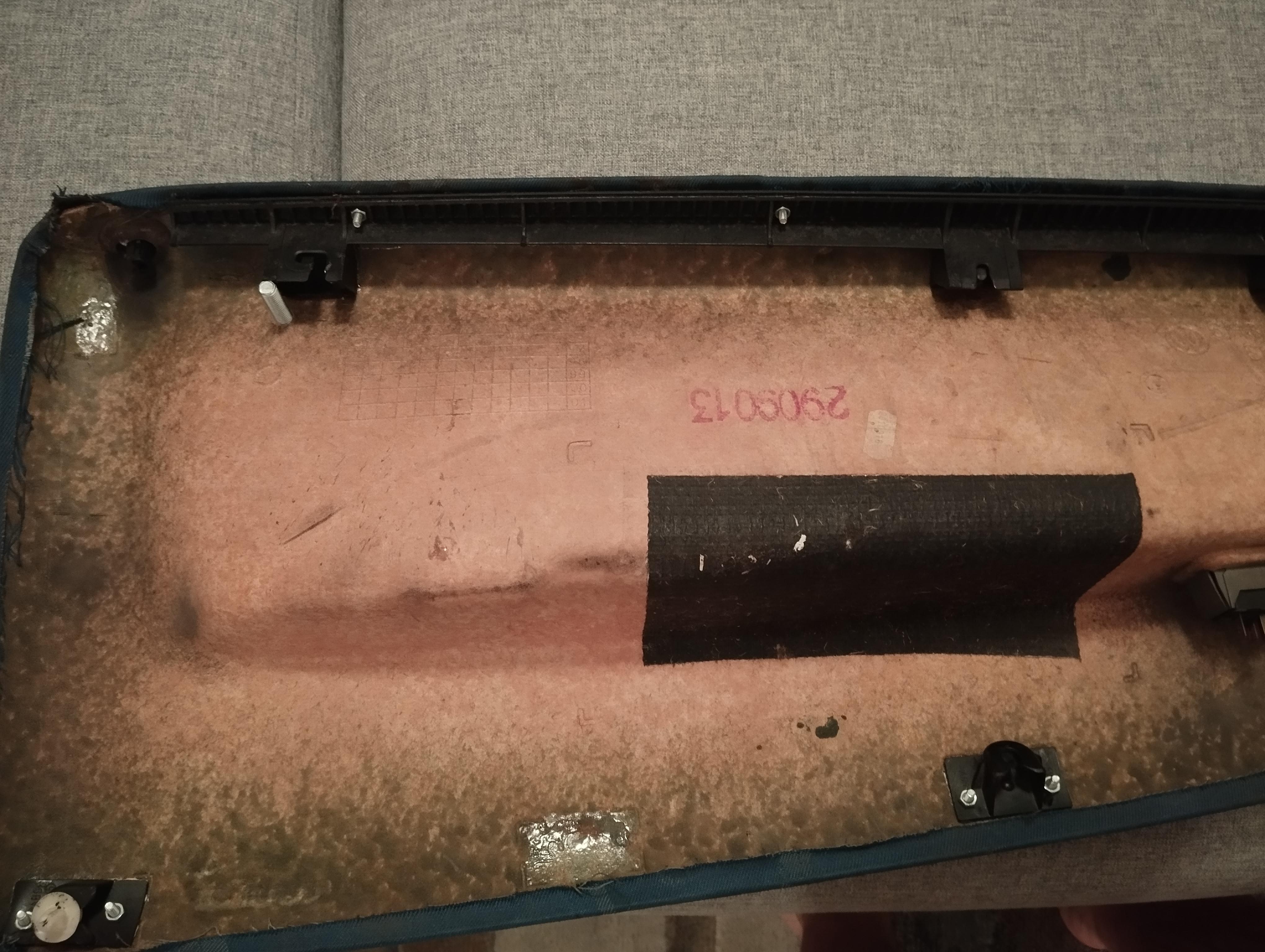

VlatcheLupo Posted April 23, 2025 Author Report Share Posted April 23, 2025 (edited) Actually there was a third place where a bolt can be mounted along with a washer and nut. Just below one of the holes diagonally. Somehow i got the math right and drilled hole in the cardboard at the right place. So a long fat bolt, a nut and a washer and now the cardboard holds on three screws (two at the door holder handle) and it seems strong and not moving. I think it was a triangle of 1.5 cm, 2.1 cm and 1.5 cm if you look at one of the holes. This is how to get where the big hole is and to drill a hole in the cardboard. Haven't made a picture of the final set-up but this hole is here. But yes, rivets and plastic bolts like these can be used as well if you can find them The problem that appeared, if you put one of these in the holes, cannot remove them without cutting them in half because different size than the original ones. Plus it broke one of the plastic holders. So i skipped these for now. This means if you use these plastic bits you will not be able to remove the cardboard from the door without breaking the plastic holders on the inside. Edited April 23, 2025 by VlatcheLupo Quote Link to comment Share on other sites More sharing options...

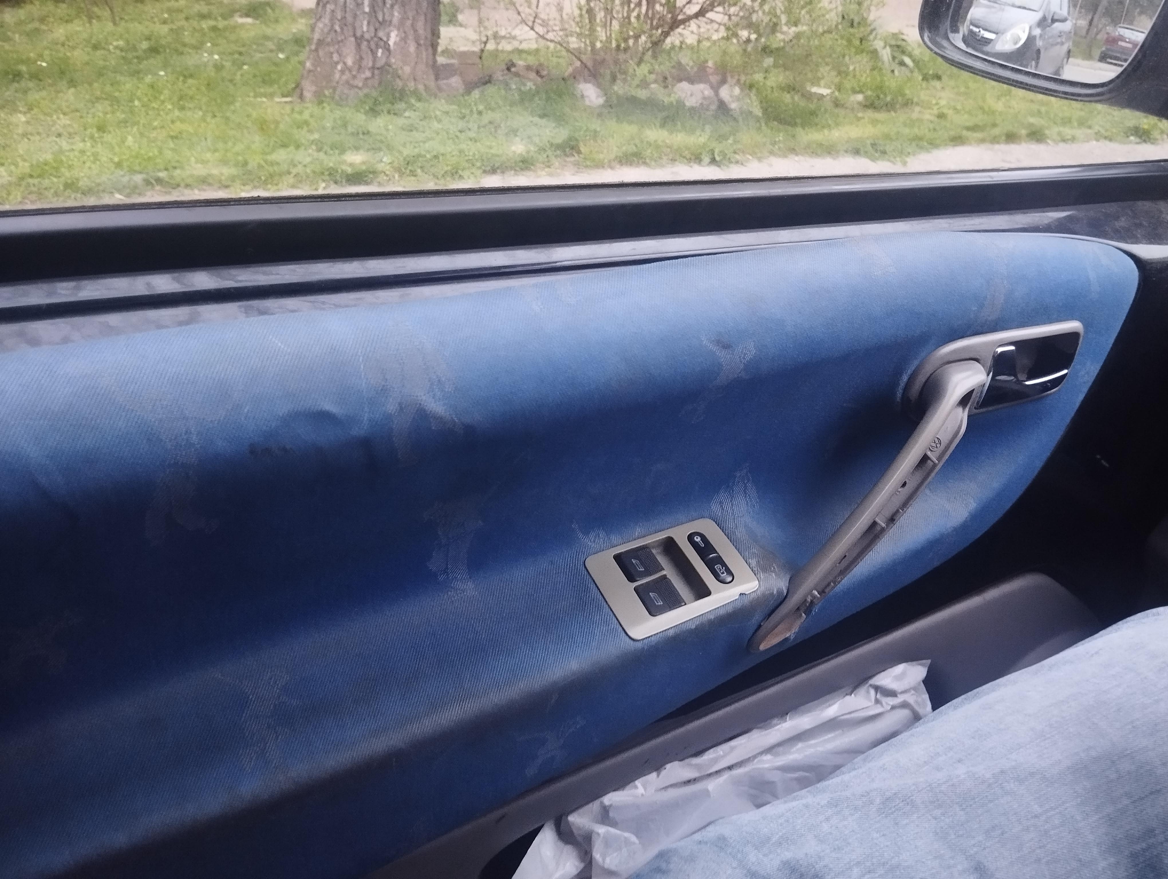

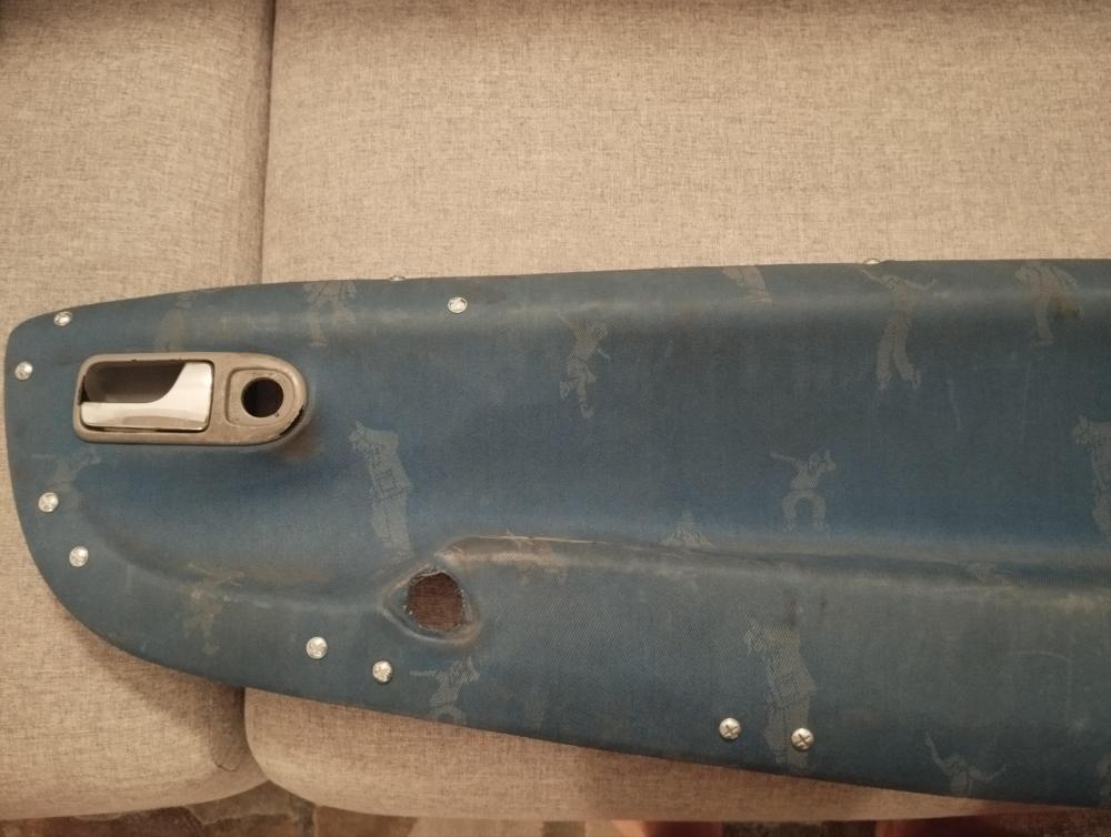

VlatcheLupo Posted April 26, 2025 Author Report Share Posted April 26, 2025 (edited) This is how it looks like now. A bit ugly but it does the job, holding onto three bolts Edited April 26, 2025 by VlatcheLupo Quote Link to comment Share on other sites More sharing options...

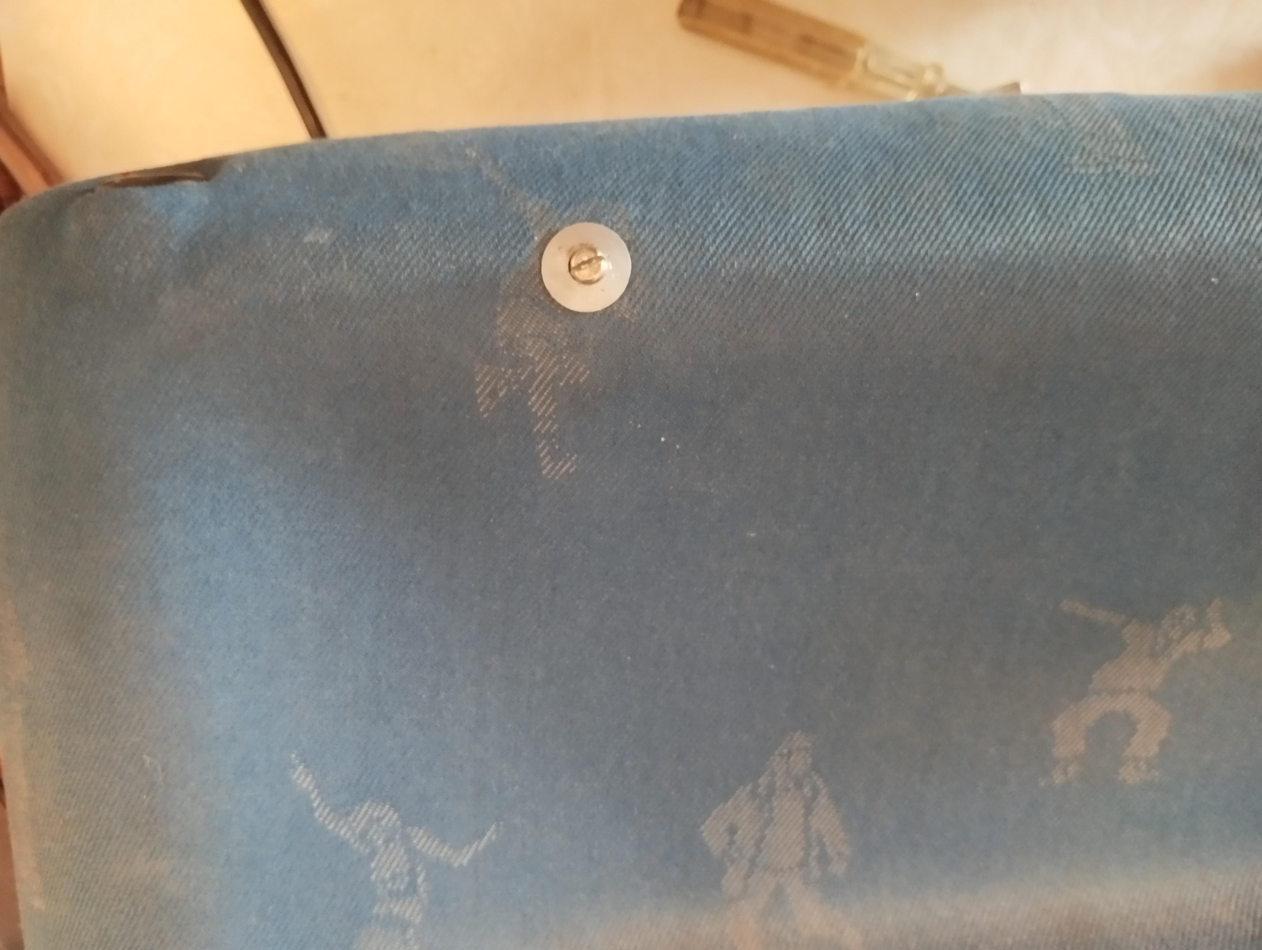

VlatcheLupo Posted May 1, 2025 Author Report Share Posted May 1, 2025 The right side was also loose. Did the same trick with the third bolt. The plastic should i call them bolts just broke in two. 1 Quote Link to comment Share on other sites More sharing options...
