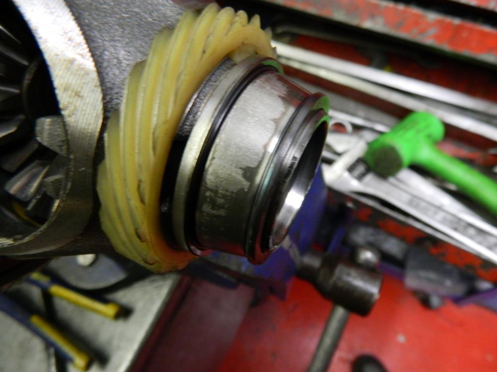

mk2 342 Posted December 14, 2020 Report Share Posted December 14, 2020 Don't drive it one second if it's whining. It's still salvageable. Hopefully. A new set of bearings costs about £100 and takes a good gearbox place about 2h to replace them. Then you'll get another 100k miles out of it. I'll see if I can find pics of what happens inside it. I've had two of my lupo gearboxes rebuilt for the same reason. Where are you? There are a few well known Lupo gearbox places in the UK that members have recommended. It cost me £50 and a tin of chockies to get mine done. I watched and took pics while he was working. Quote Link to post Share on other sites
mk2 342 Posted December 15, 2020 Report Share Posted December 15, 2020 (edited) found some pics showing how the bearings go... This is the diff bearings. Easy enough to replace, but you need a puller to get the 5th gear off first. If you can't select 4th or 5th, it's because the bearing right under the 5th cog is loose, so there's too much slack to select it. puller for 5th: Edited December 15, 2020 by mk2 Quote Link to post Share on other sites
Steve Mo 0 Posted December 16, 2020 Author Report Share Posted December 16, 2020 oh that is very interesting. we are in Folkestone in Kent but would not mind a drive if its a day job so any recommendations would be very welcome and I really appreciate the picturizes. Thanks Steve Quote Link to post Share on other sites
