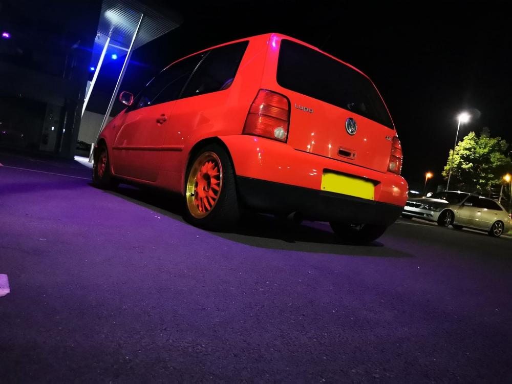

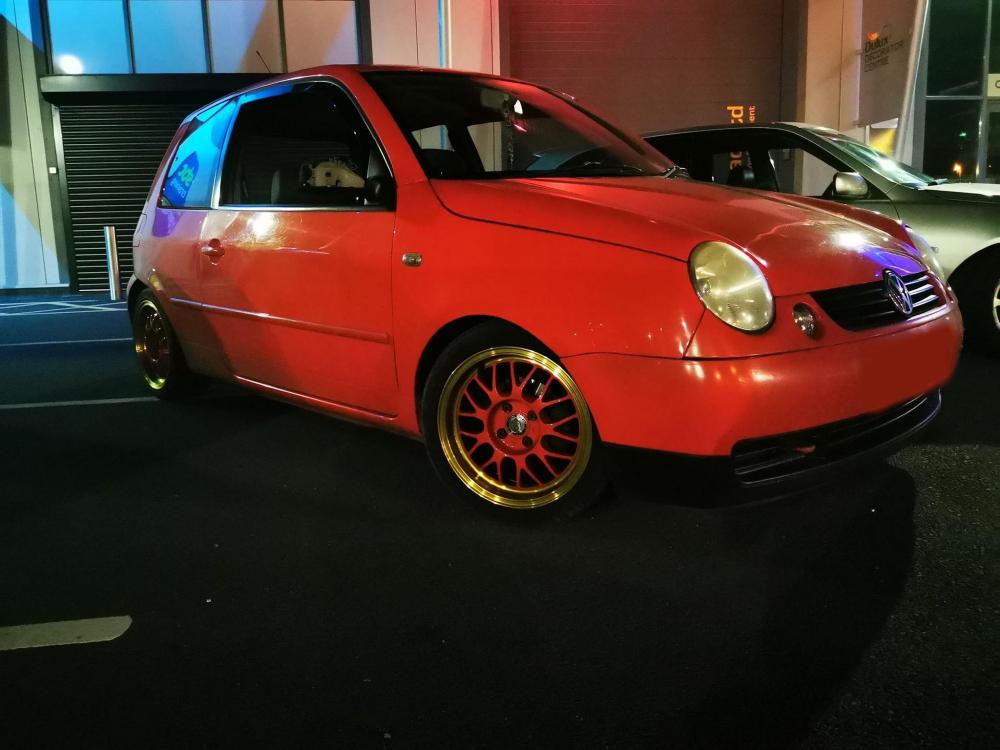

xXBeefyDjXx Posted September 8, 2020 Report Share Posted September 8, 2020 Hi everyone, I needed a reliable daily around a year ago when I blew the engine up in my 350z so a friend sold me his awesome 1.7SDI Lupo, which I named "Blinky". (I always name my cars after pac-man ghosts, colour dependant) I brought the car with a replaced engine ready to be turboed but I still haven't gotten around to it yet. Running Coilies lowered to a reasonable height where she still passes speed bumps (we have some really tall ones here) Some sweet wheels that match the colour of the car, I believe they're 8j, 15" Car handles like it's on rails, or as I like to say it's like a big go-kart. Uprated Injectors (215s from a 90 or 105 I believe, maybe 130 I can't remember) Remapped by myself to improve power output and smoothen engine response and throttle response. (No more sluggish behaviour or tractor sounds) OMP Steering Wheel with Boss kit. (Clone, but nice and firm) Head Unit replaced with a Pioneer DAB Double Din. All door speakers replaced with Pioneer TS-G170c 50W Rear speakers installed with the help of the custom fabricated adapters, again Pioneer TS-G170c 50w. All Speaker Wire replaced with Vibe "Oxygen Free" cables Rear seats removed and replaced with a huge single 12" sub box ported to 30hz for some nice back massages (36 inches wide) Ground Zero 12" GZRW 30-P2 600w RMS Subwoofer on a Pioneer GM-D9701 1200w RMS amp Amp runs on 4 gauge Vibe wiring to and from a second 650AH battery in the boot regulated by a Stinger Battery Isolator. Quote Link to comment Share on other sites More sharing options...
