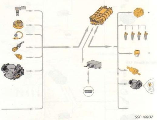

Its an AER. Looked at the PDF's of the VW training for the  Bosch Motronic 9.0 and there is no mention of a crank sensor as in the wiring diagrams? Now I am confused as it must have one. Going to take a look tomorrow. Hope it will fix-up as its a great little low millage car in very good condition.

In my view, its between the distributor and the ECU?

Not sure what you are calling the MAP sensor (ref above Motronic 9.0 schematic). This would be the intake manifold pressure I assume a there is nothing else unless part of the throttle body assembly. I have tried starting the car with the connection to the manifold pressure sensor  undone and it throws up a fault code 00519 -Intake manifold pressure sensor open circuit / short with power intermittent. On re connection this clears. Does not seem to make any difference if it is connected or not, the car still splutters and chugs just the same.

ok, so it has to be related to ignition. Or a power rail fault, maybe via a relay? And intermittant at that.
Not throttle body. Nope. You can always check the TPS output by watching the throttle % demand from the pedal as you move it on the laptop (I think it's a cable, not drive by wire in that model?). If powered throttle body, it usually goes into limp mode, which allows it ti start and only gives you a fast idle. More air than a regular idle... so will always start.
This is nuts. You have practically rebuilt the damn thing. Respect. And you haven't completely lost it.... yet.
I wonder... Can you measure 5v at the sensors? Oh, and check the earth (continuity) bus while you're at it. The behaviour is like a coil pack or plug lead/dizzy is failing. But from all the stuff you've changed, I'm pretty sure it can't be. But you 'can' get very similar symptoms when a relay is iffy. Like the engine loom power bus isn't quite right.
