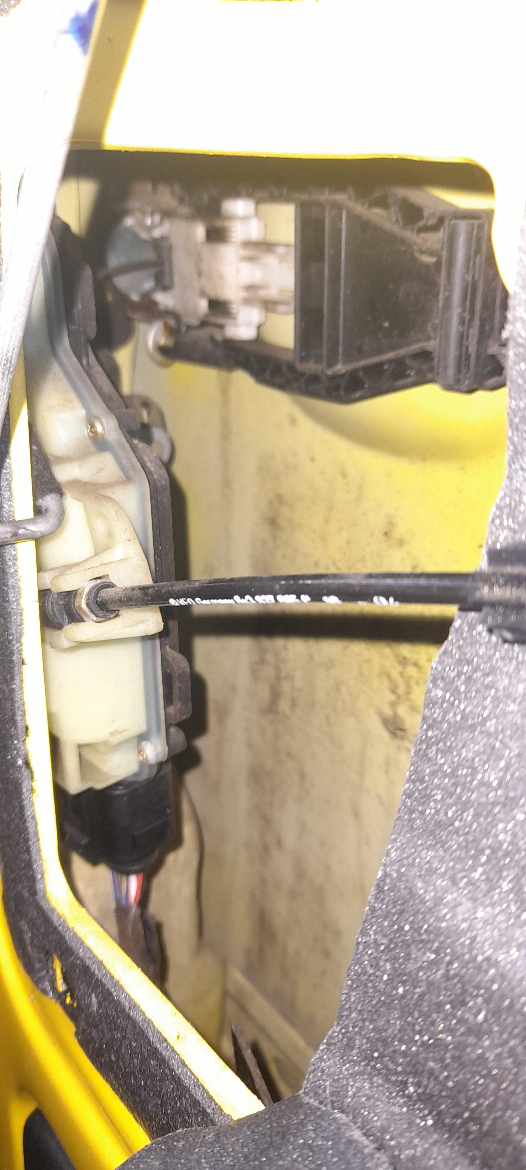

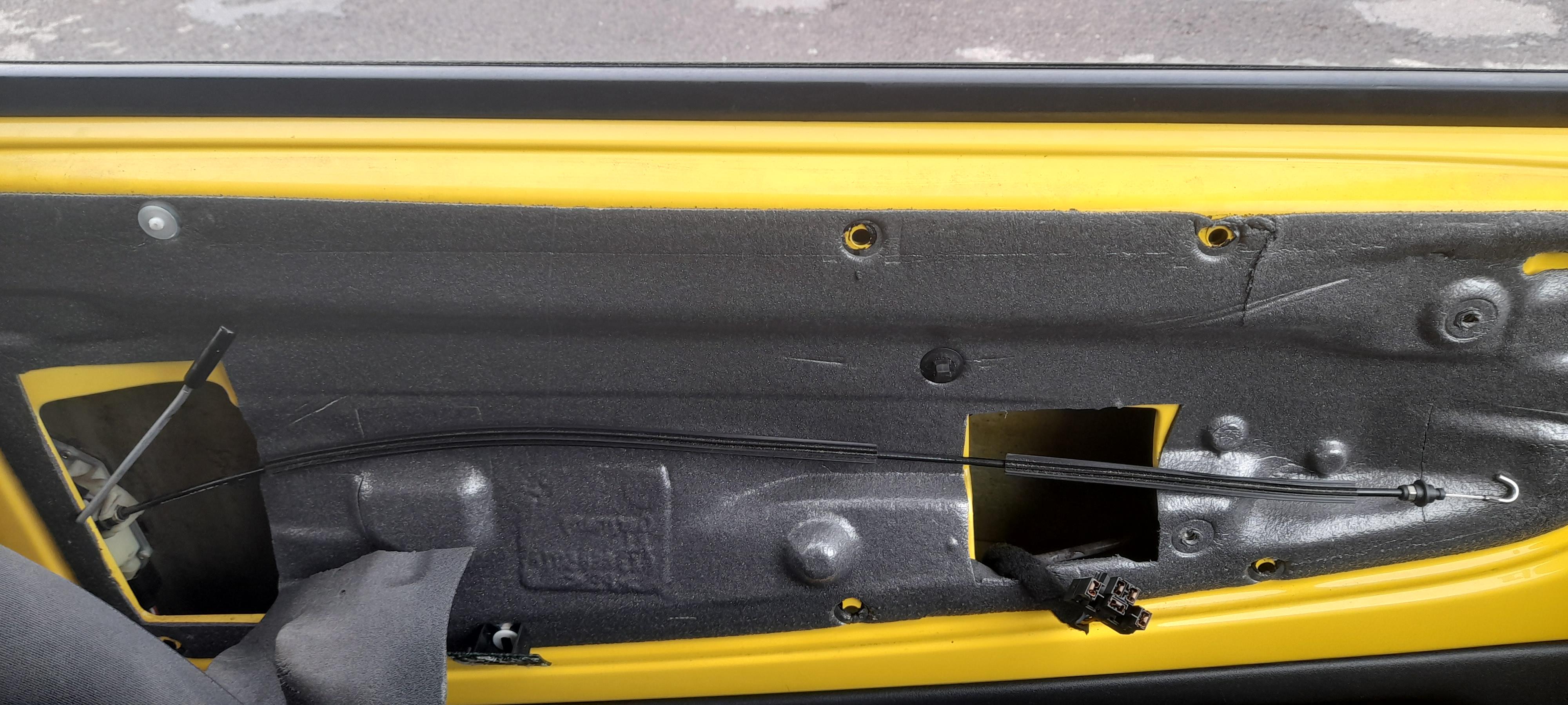

Trinity Posted March 22 Author Report Share Posted March 22 Update- took the door card off again to have a look at how to actually take off the lock mechanism. Decided to clean up the connectors from the window switch with some electrical contact cleaner and that seams to have fixed the problem!? Not sure why that connection would effect the lock but it's been working okay for a day now. Locks and unlocks perfectly but I've kept the door card off just incase it stops working again... Quote Link to comment Share on other sites More sharing options...
