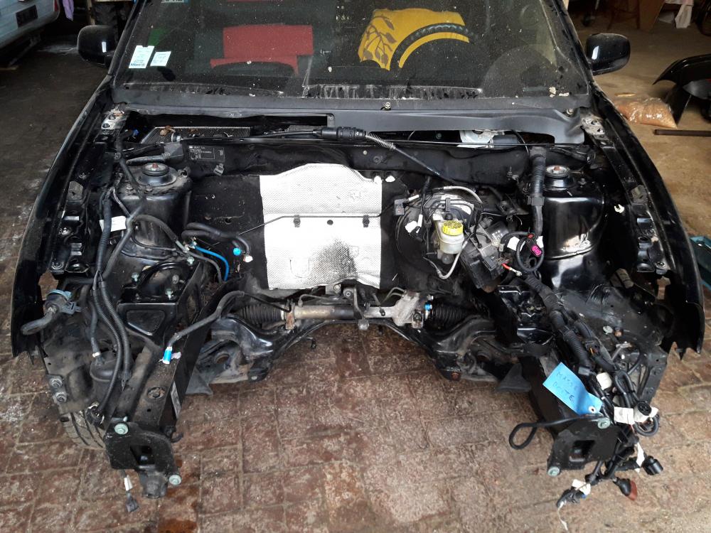

To begin with, I discovered that she had a shock on the right side, door alignment problem, a lot of welding, and a deformation of the horn. :rant:
I started by disassembling the gearbox but I would come back later. Then I disassembled the engine. The timing belt was offset from a tooth. ( It was mounted in a Seat concession...........)

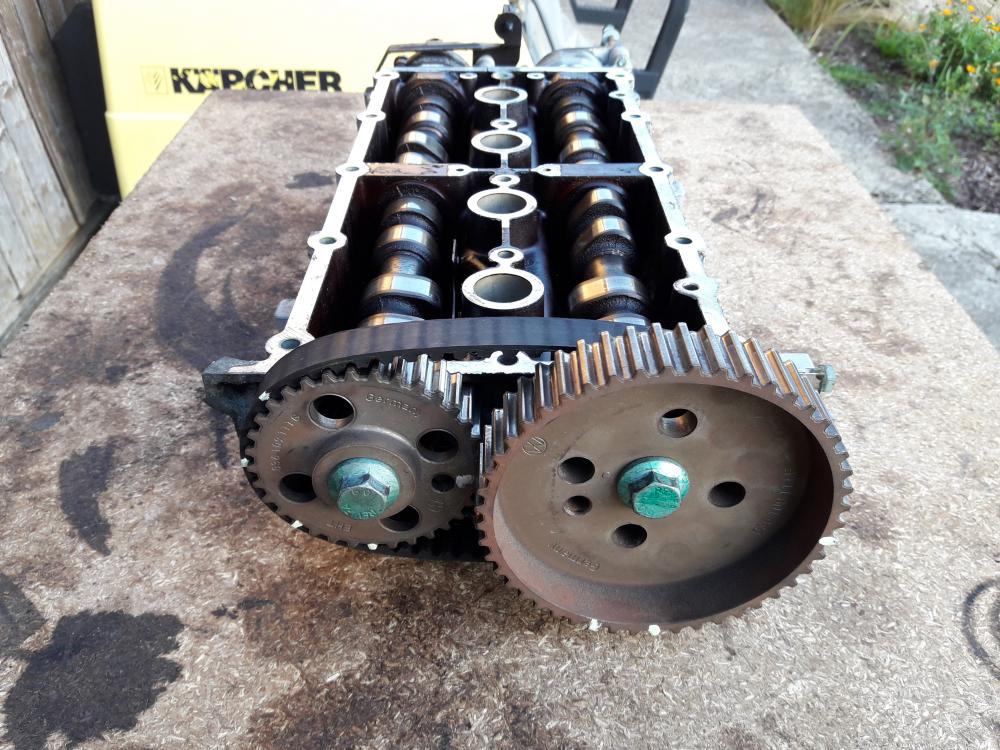

Intake manifold and injectors :
It's very dirty and greasy
Dirty like a TDI. :lol:
The same applies to the camshaft housing.
Edited by Anthony28
This car was stopped for 5 years. It was poorly maintained. Bad Oil (semi synthetic). There are oil (pieces) glued everywhere.

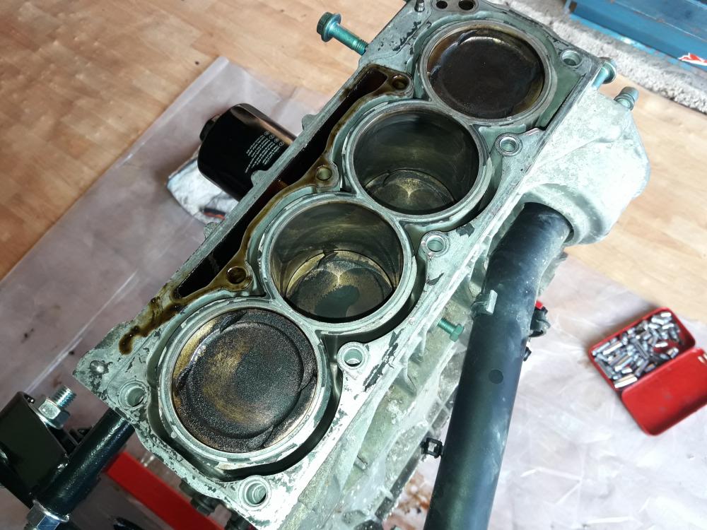

Now is the time to remove the cylinder head :
It's "clean". The head gasket is not damaged.
The piston heads are as dirty as the intake manifold :
But surprise......
Seen like that, it was still fine.

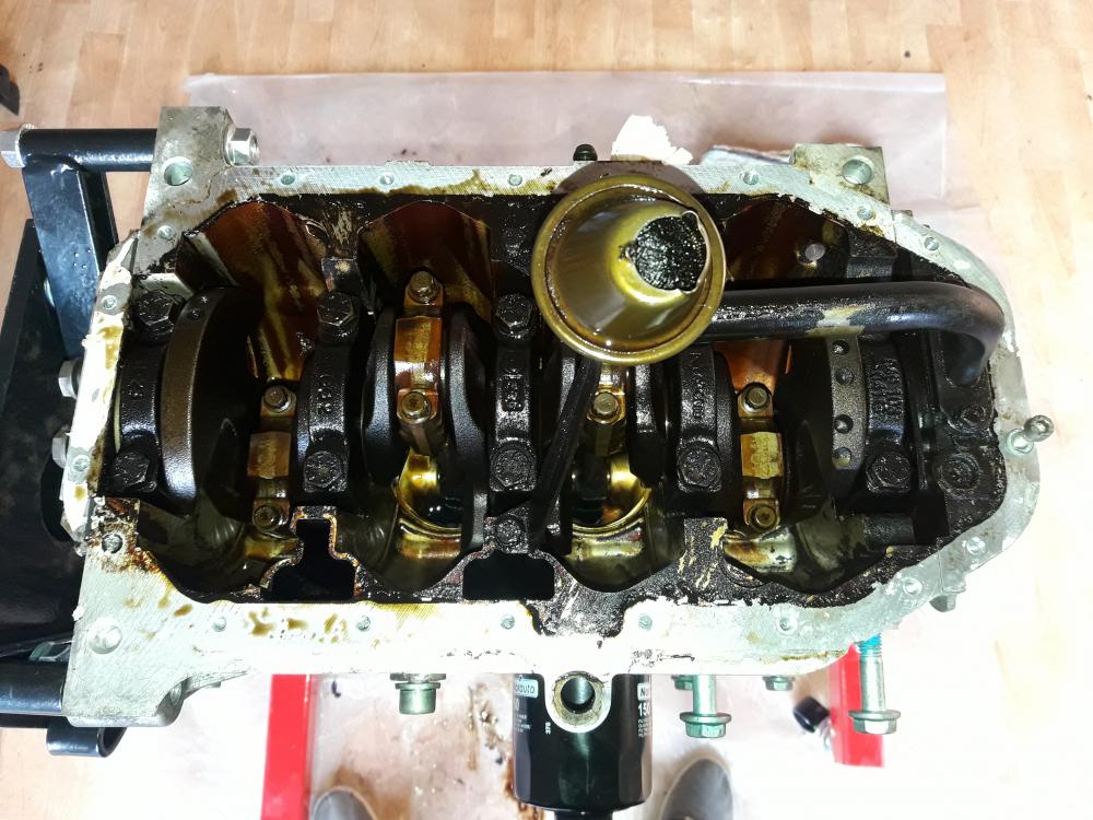

I disassemble the oil pan.
:surprised:
Oil pomp strainer is dirty for engine less than 100,000kms.
So came the time to disassemble the pistons and the connecting rods...
SURPRISE!!
The 4 are like that. :furious::furious::furious::furious:

I wanted to do rebore (?), but that is not possible. It is an aluminium block, the crankshaft must not be disassembled. So the tool for rebore does not pass entirely.
So I'm looking for a 1.6 GTi engine.

The honing looks fine. The oil strainer gauze is only partly clogged, so I guess that the main and big end bearings will be fine. The cams look ok too- which is usually a first place to look for lack of oil flow. Check the roller rockers. The pistons look ok too- only light scuffing. Need new rings though.
I would just clean everything and bolt it all back together again (with the right timing!).
