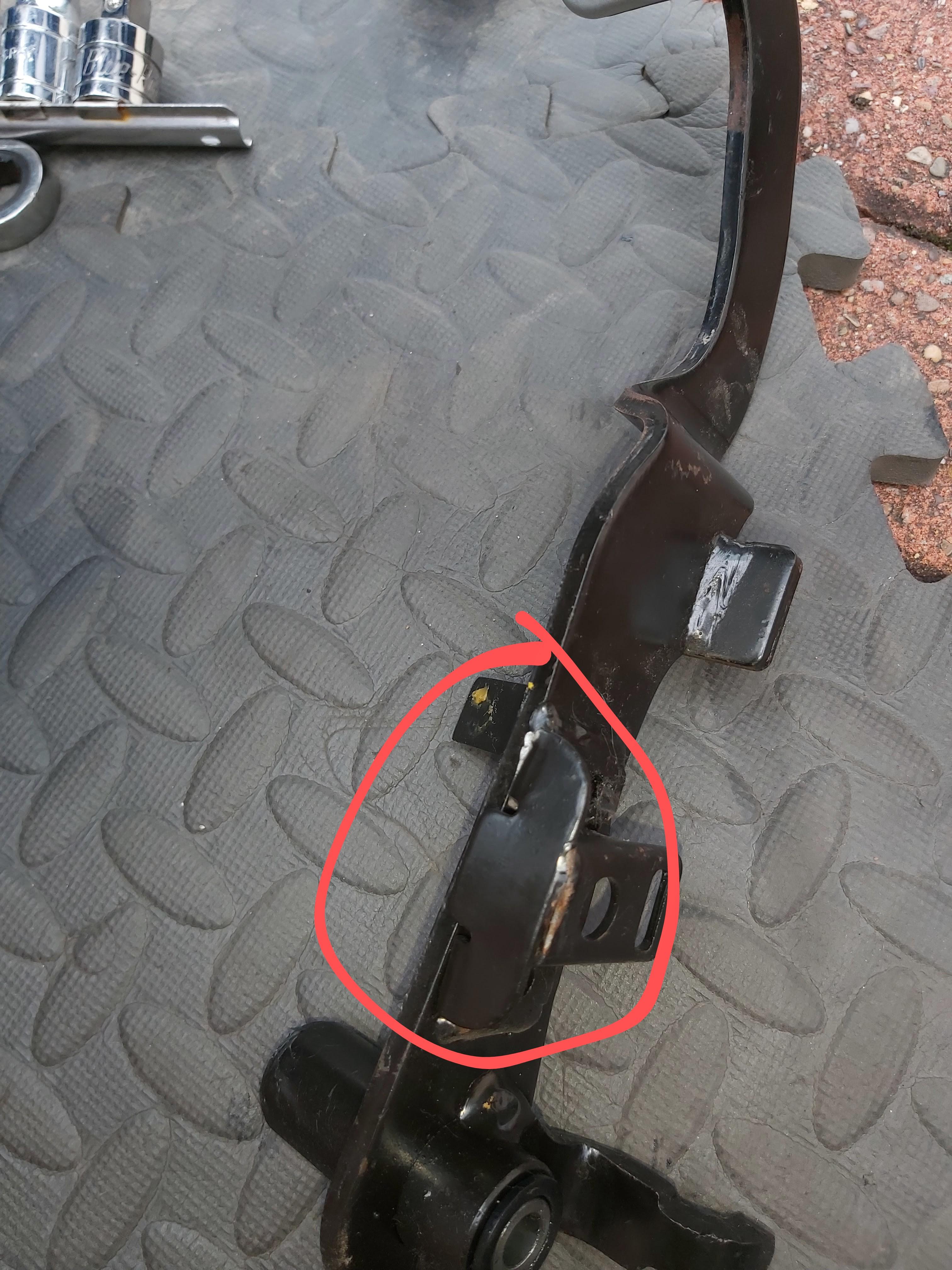

Nope, tried the zip tie trick but slipped. Found the spring and 1 plastic half (which is cracked) and the other is somewhere in the garage never to be found... lol
Might look at getting the special vw tool (3317) to help get it back in.
The reason it is out is because I had to weld up the pedal, common vw fault apparantly

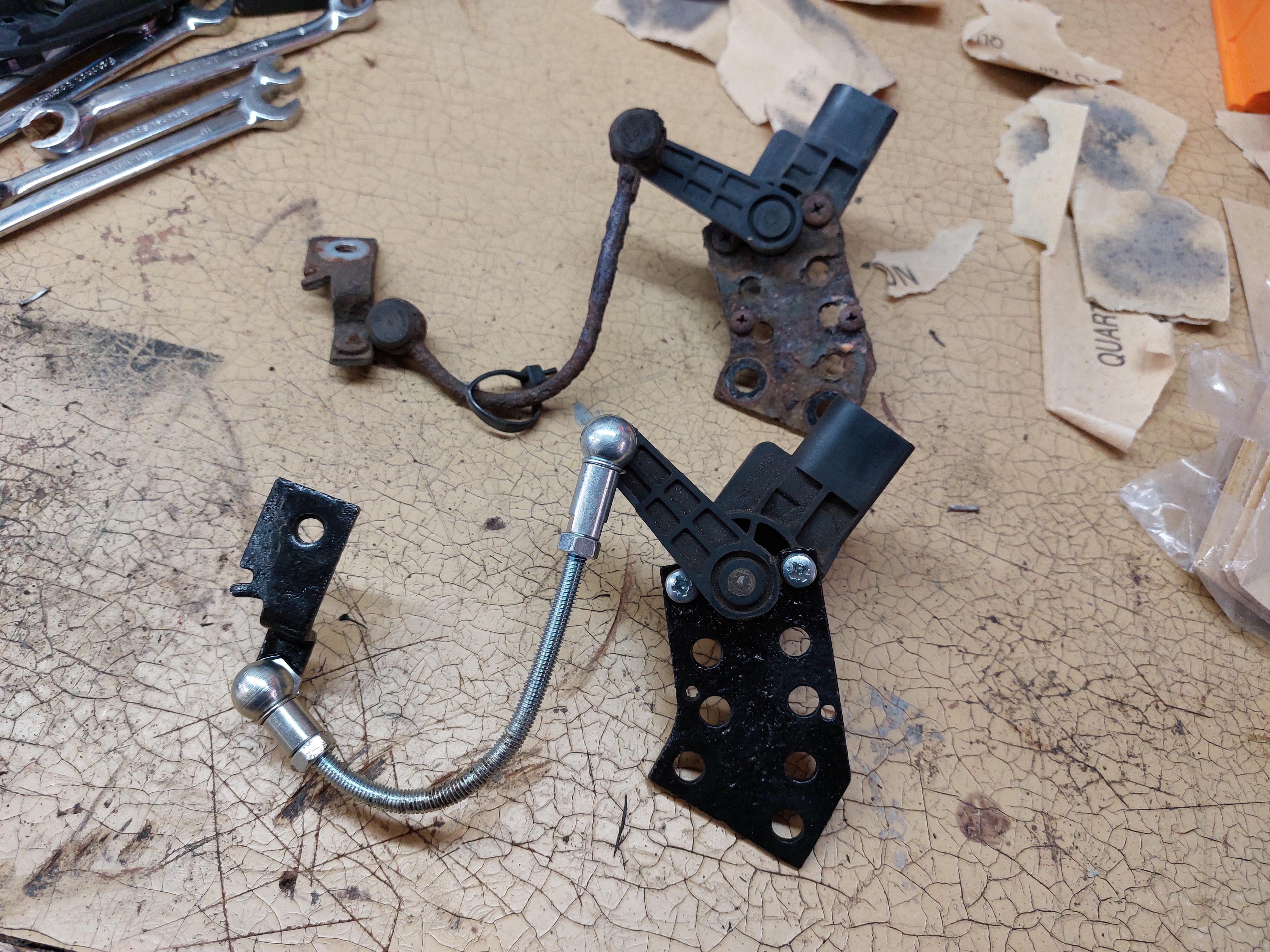

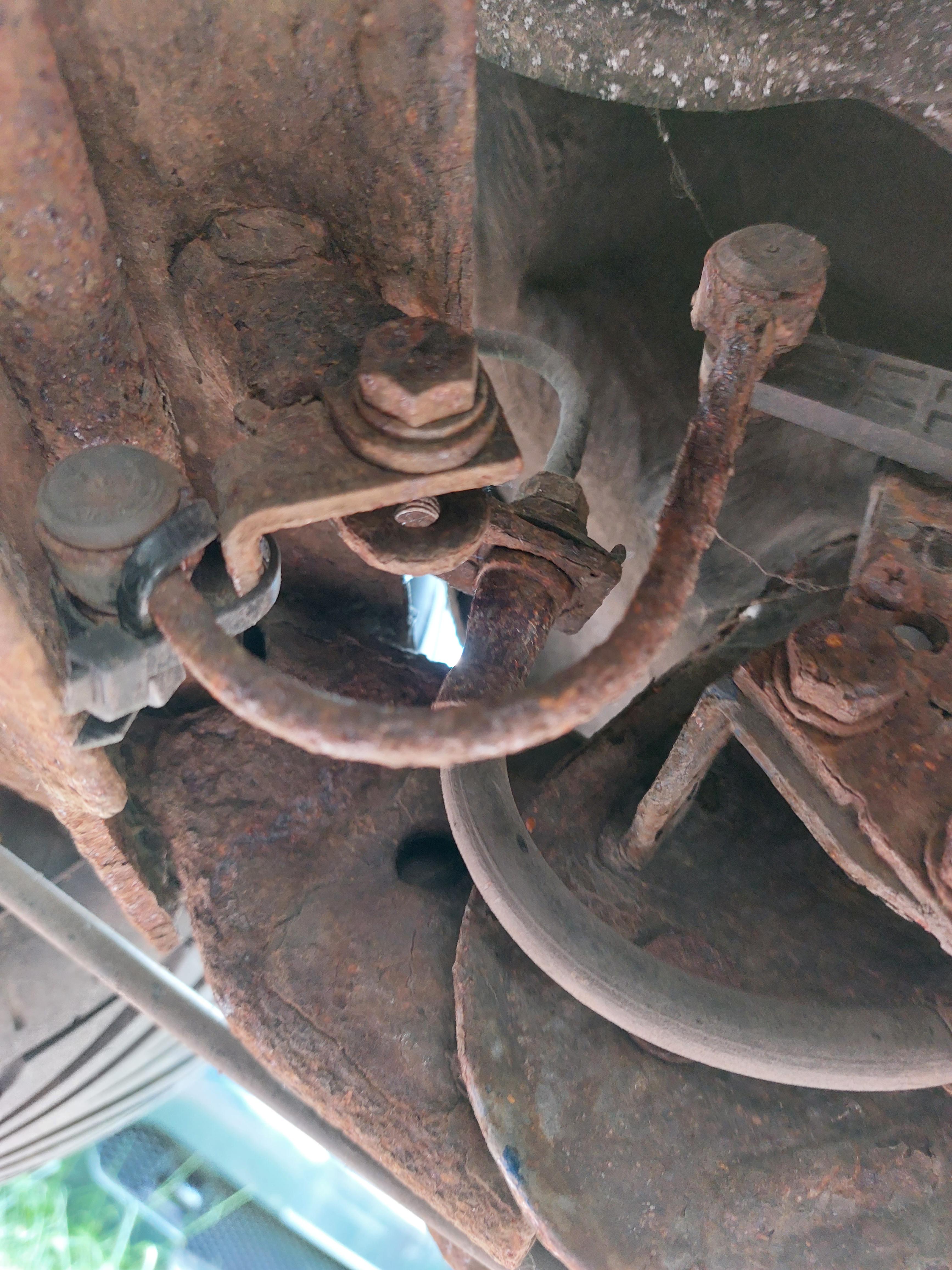

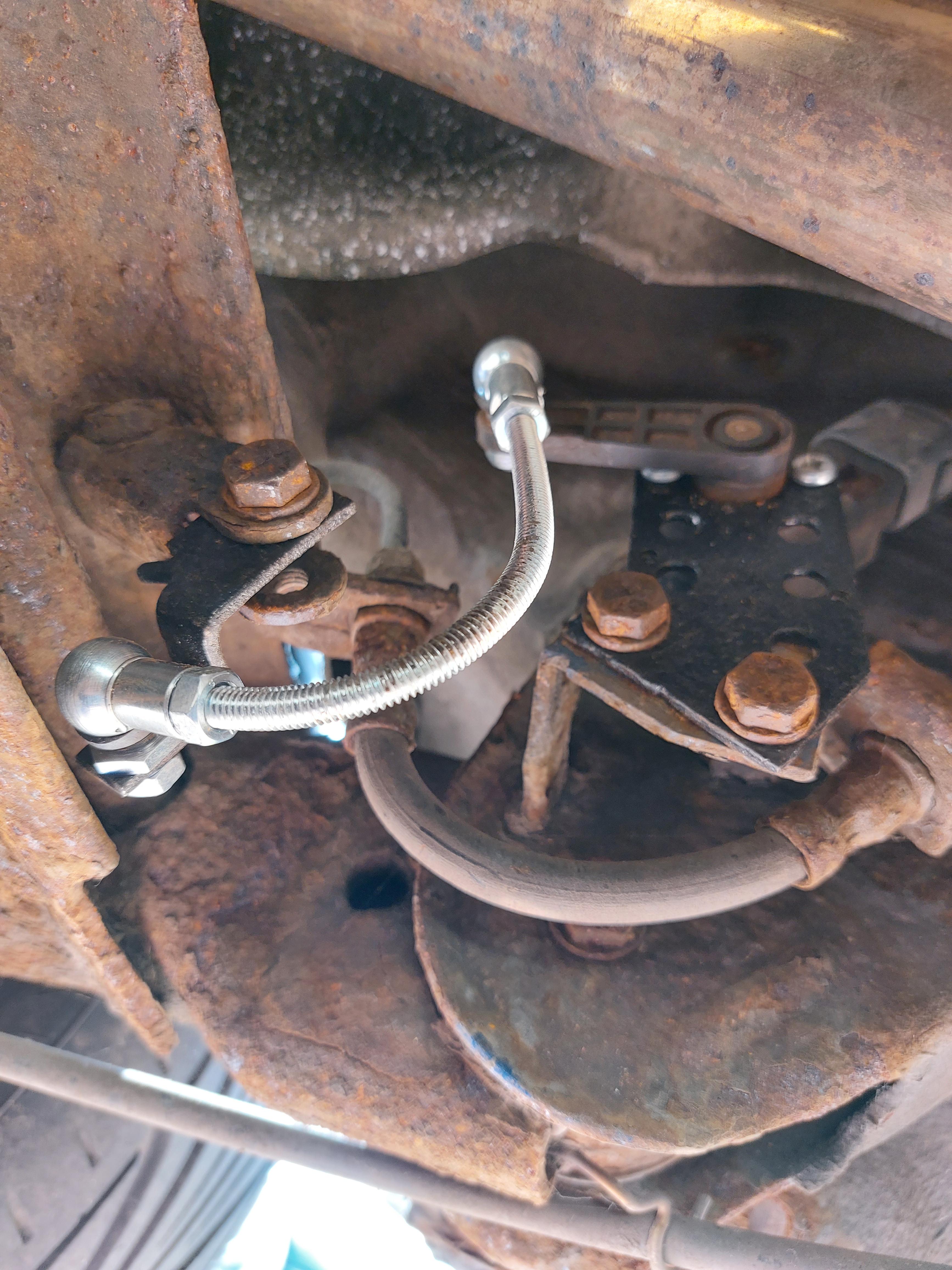

Xenon headlight levelling linkage rebuild
in Volkswagen Lupo
Posted
Aliexpress "M5 right angle ball joint with seal" and compatible threaded rod/bar 👍
iirc i wrapped the rod/bar around a socket and eyed it up. Maybe a brake line bending tool would also work. Also think I had to drill either end to allow the ball joint to be attatched.
