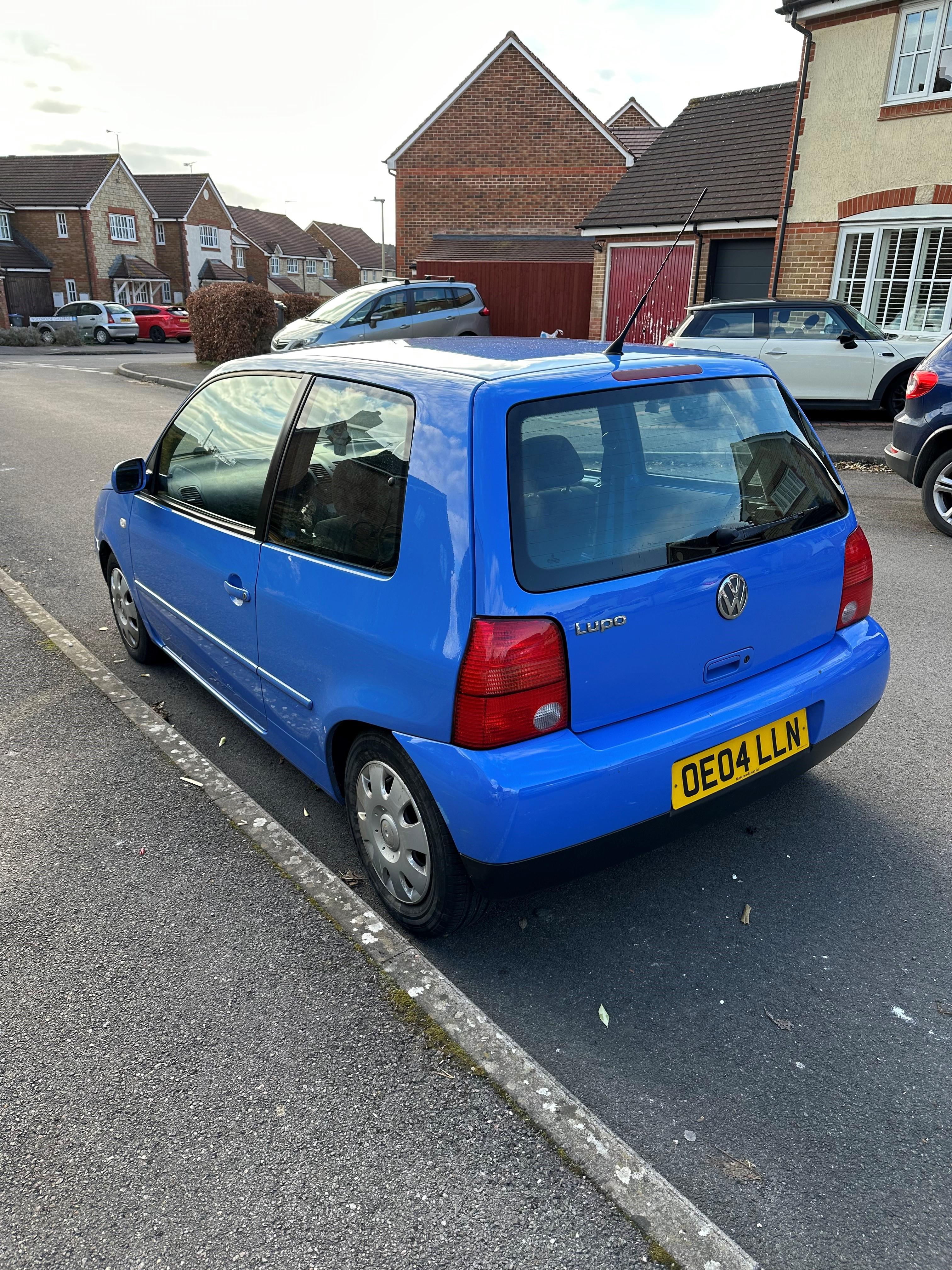

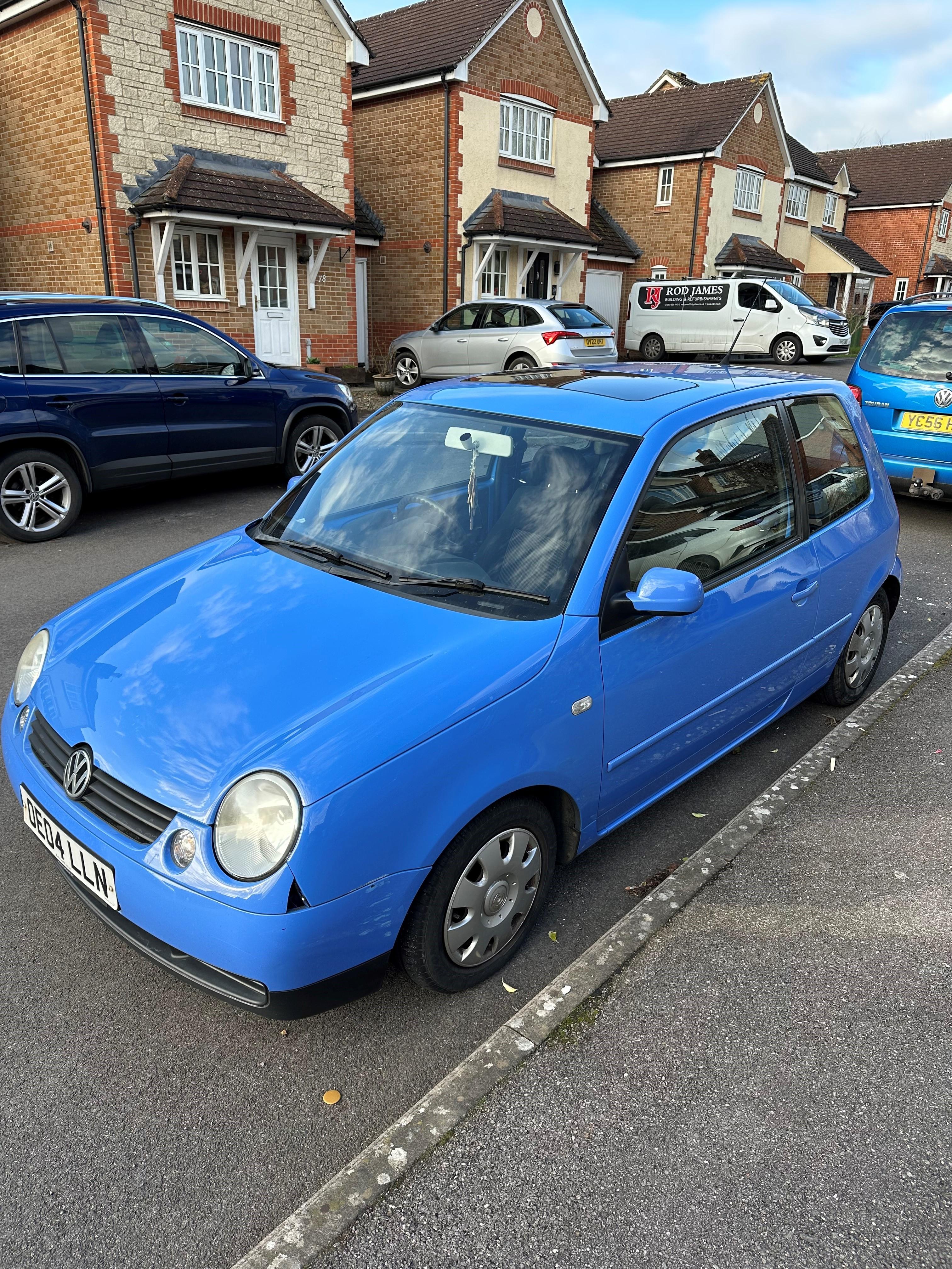

  5. The time has come to sell the lupo - a growing family means the car will not get used anymore. A replacement VW touran has been bought so this one is up for sale
    Will get a post up on facebook soon but the particulars are below in case anyone wants to send me a message.
    2004 Volkswagen Lupo 1.7 SDI
    Pros:
    4 Previous Owners
    2 keys
    Full Service History

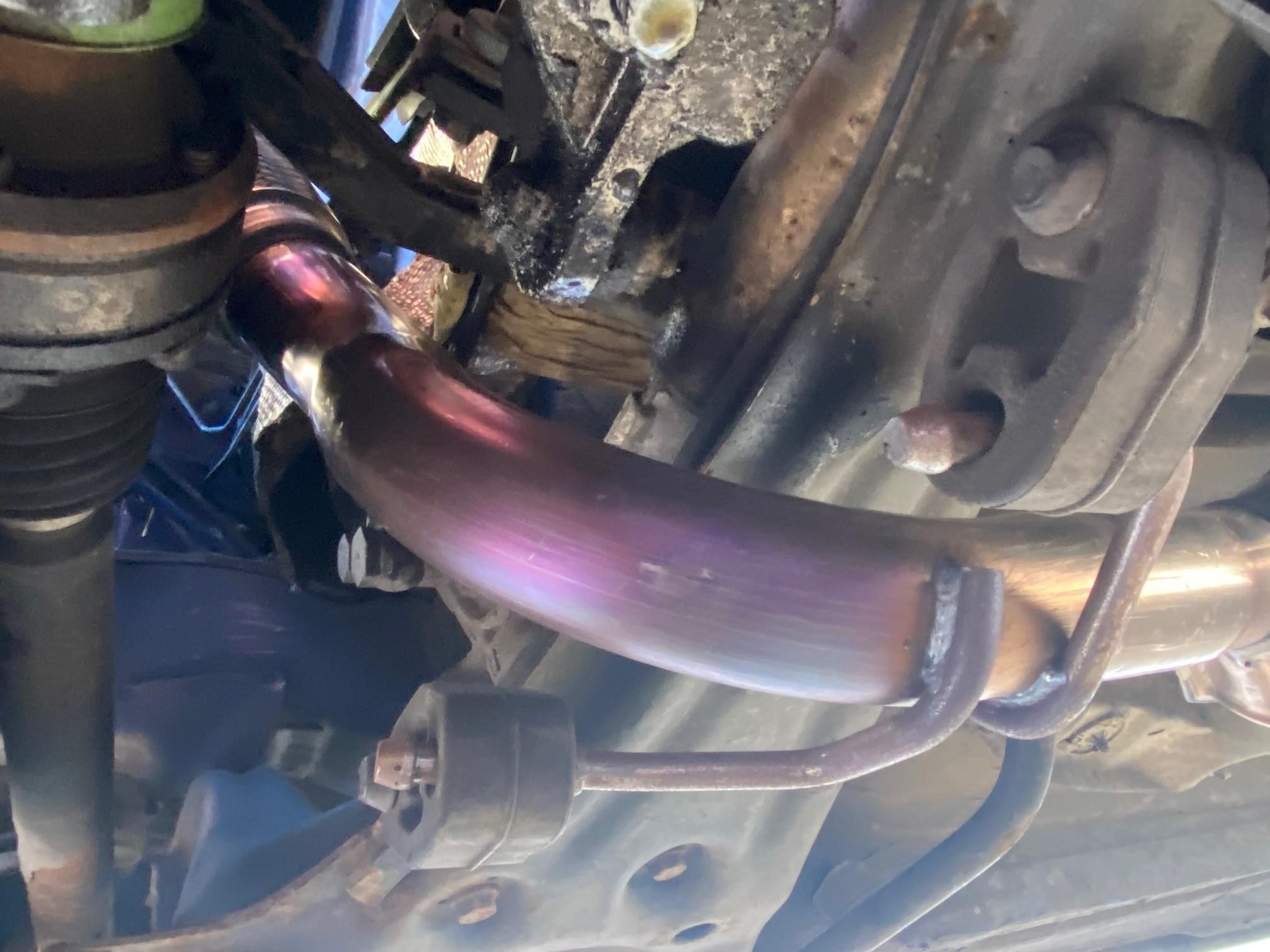

    New standard full exhaust system
    All brake hoses changed @ 130k
    Cambelt changed @ 150k
    Clutch changed @ 137k
    New glow plugs @ 146K
    Various new parts (Drop links, lower arms, arb bushes, ball joints)
    New brakes all around
    Potential new pedal box (common issue)
    Original handbook
    All tyres have great tread
    Spare soft blue front bumper
    Spare soft blue front indicator panel
    Spare rear drums
    Cons:
    Looks Tatty - Most panels have scratches
    Offside front wheel arch showing bubbling

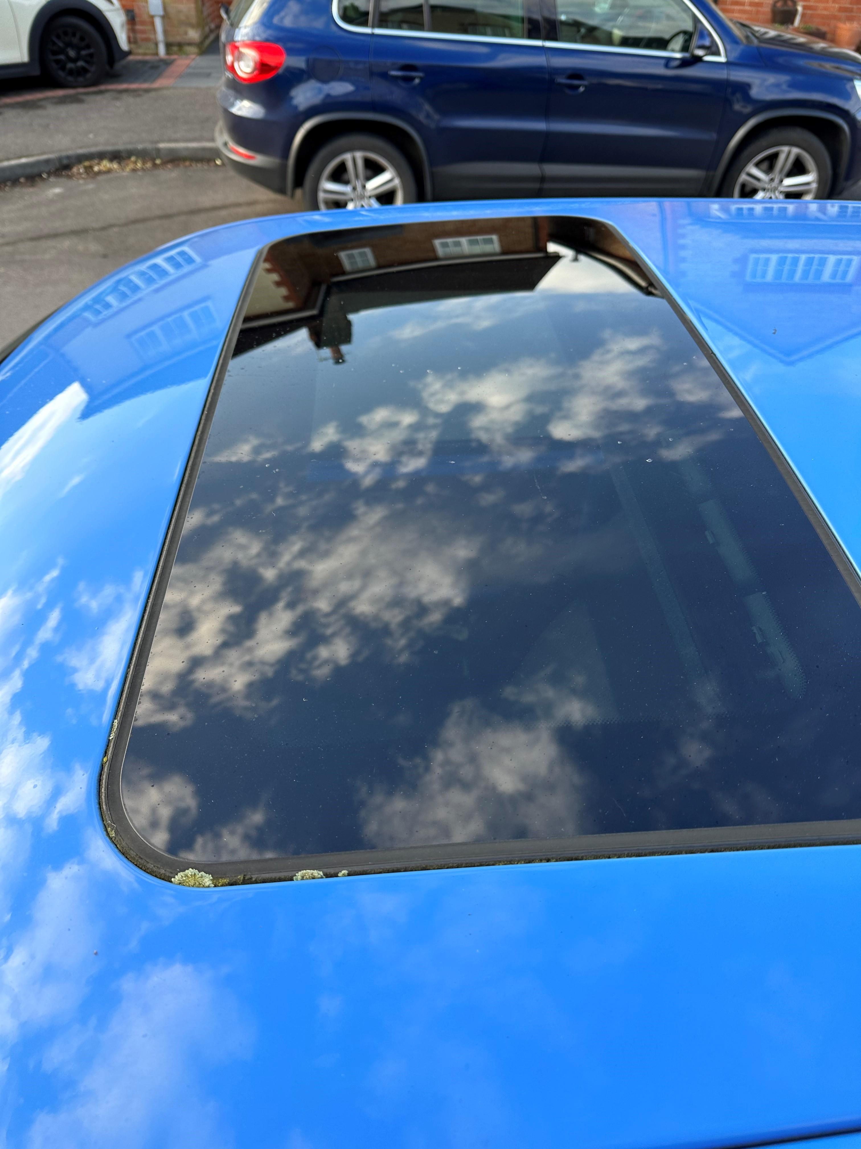

    Rear offside quarter has a ding causing surface rust to appear
    Sunroof only works with engine off

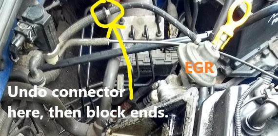

  9. On 8/20/2022 at 1:18 PM, mk2 said:
    Try pulling off the vacuum hose from the EGR valve (and block it so nothing gets sucked in). That's a quick an easy disabler, but if it's jammed open, it'll still bleed exhaust gas back into the clean air inlet.
    I tell ya what though. Found the little air bleed nipple thing.  Poked it with the petrol pump the last time I filled up. Might make it to 400 miles on this tank.  Which is more than I ever have
    Got a pic ?

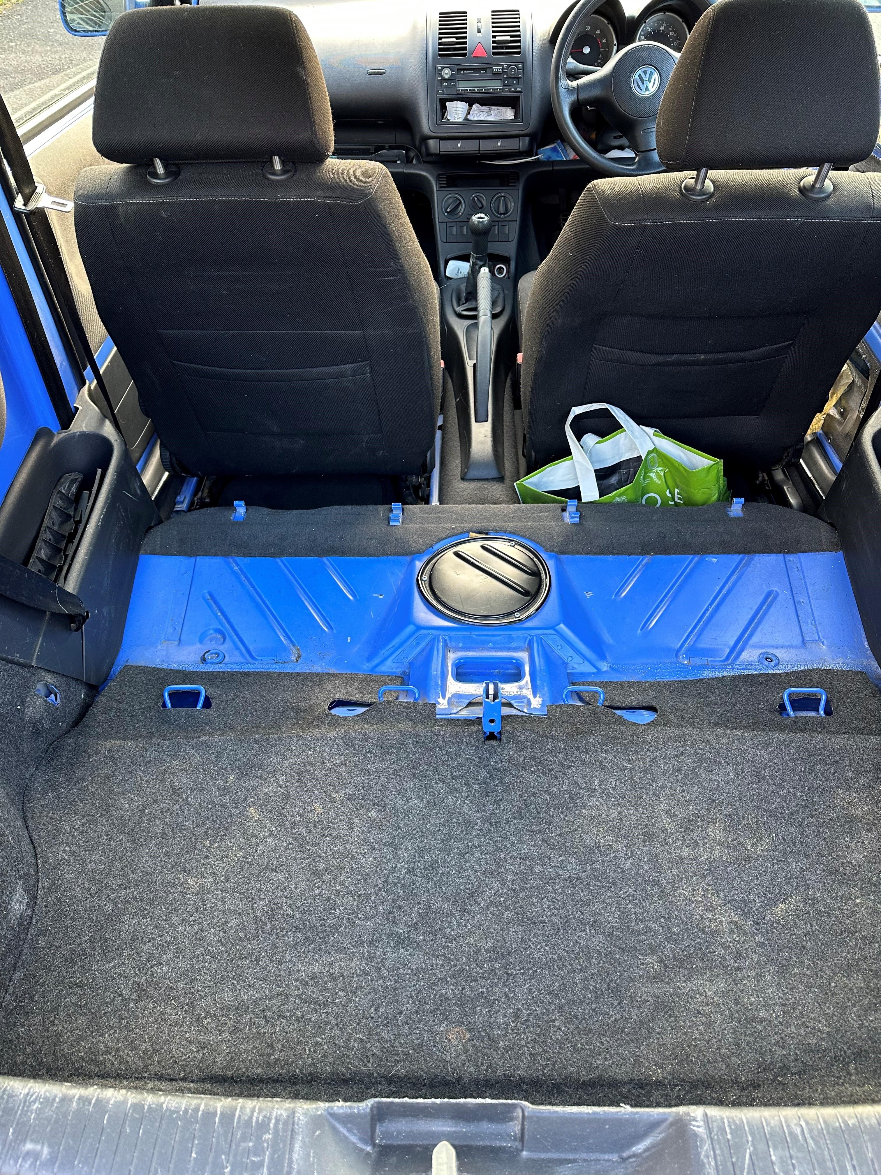

  13. Secondly - i havent used my back seats in years, sometimes they are up for show.. but most of the time they are down. shopping, tip runs etc.

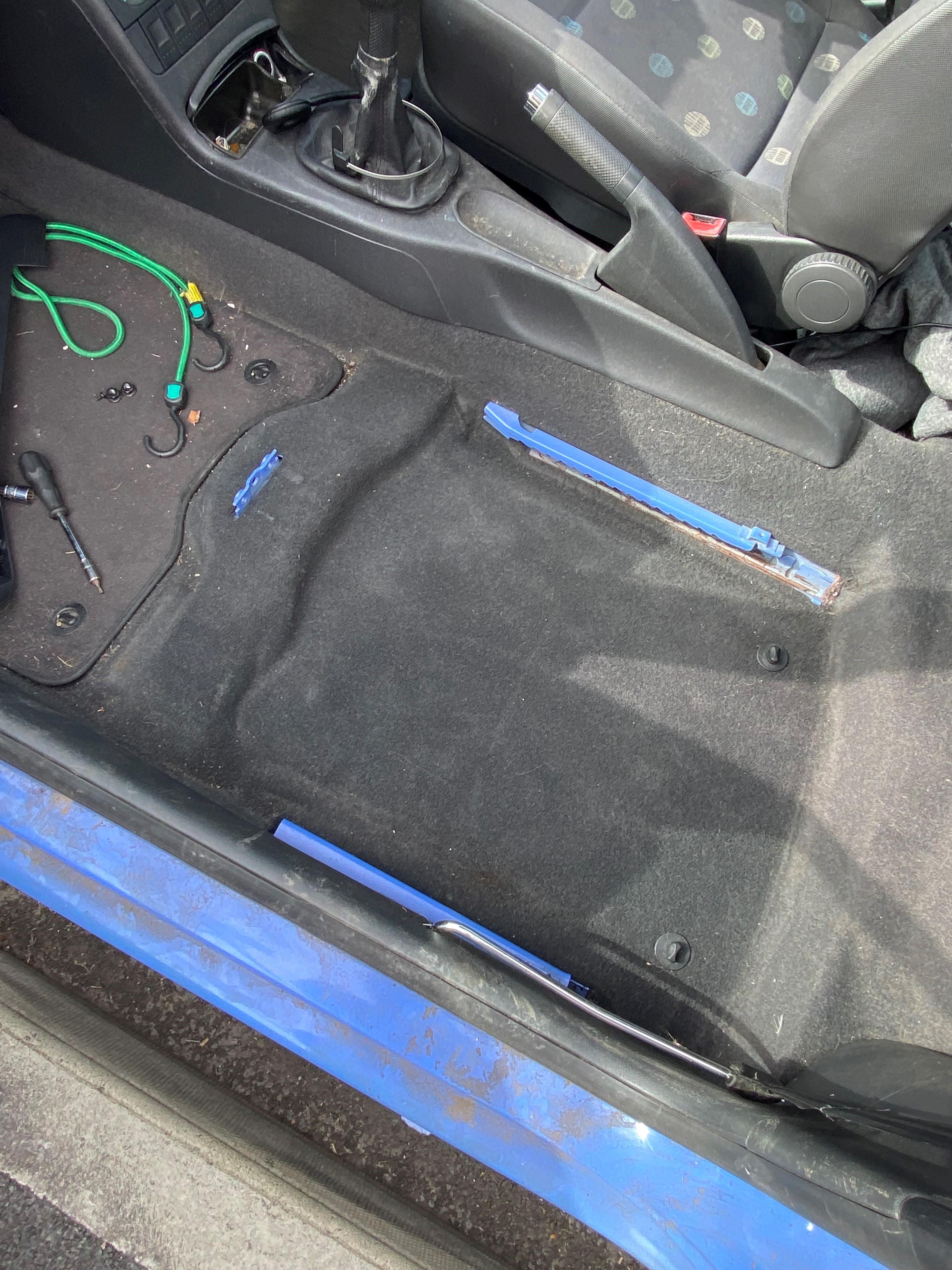

    so saw a guy on facey wanting some back seats so i did a swap and got some front seats from a GOLF
    ! i didnt have much time to give the car a proper clean or the seats a vac but they are in.. and i am loving it. Soooo much more comfy... and actually a lot lower... they can both go up and down, and even have lumbar support adjustment.. so very posh also proper headrests soo i am well chuffed.!
    In the future i will be flat boarding the rear like a van as it suits me, and with a house move and renovations it will become invaluable. In theory i should sell and buy a van but i cant part with this little beauty!
    Couple of pics. once in the new place ill do a proper clean up again as per previous attempts.

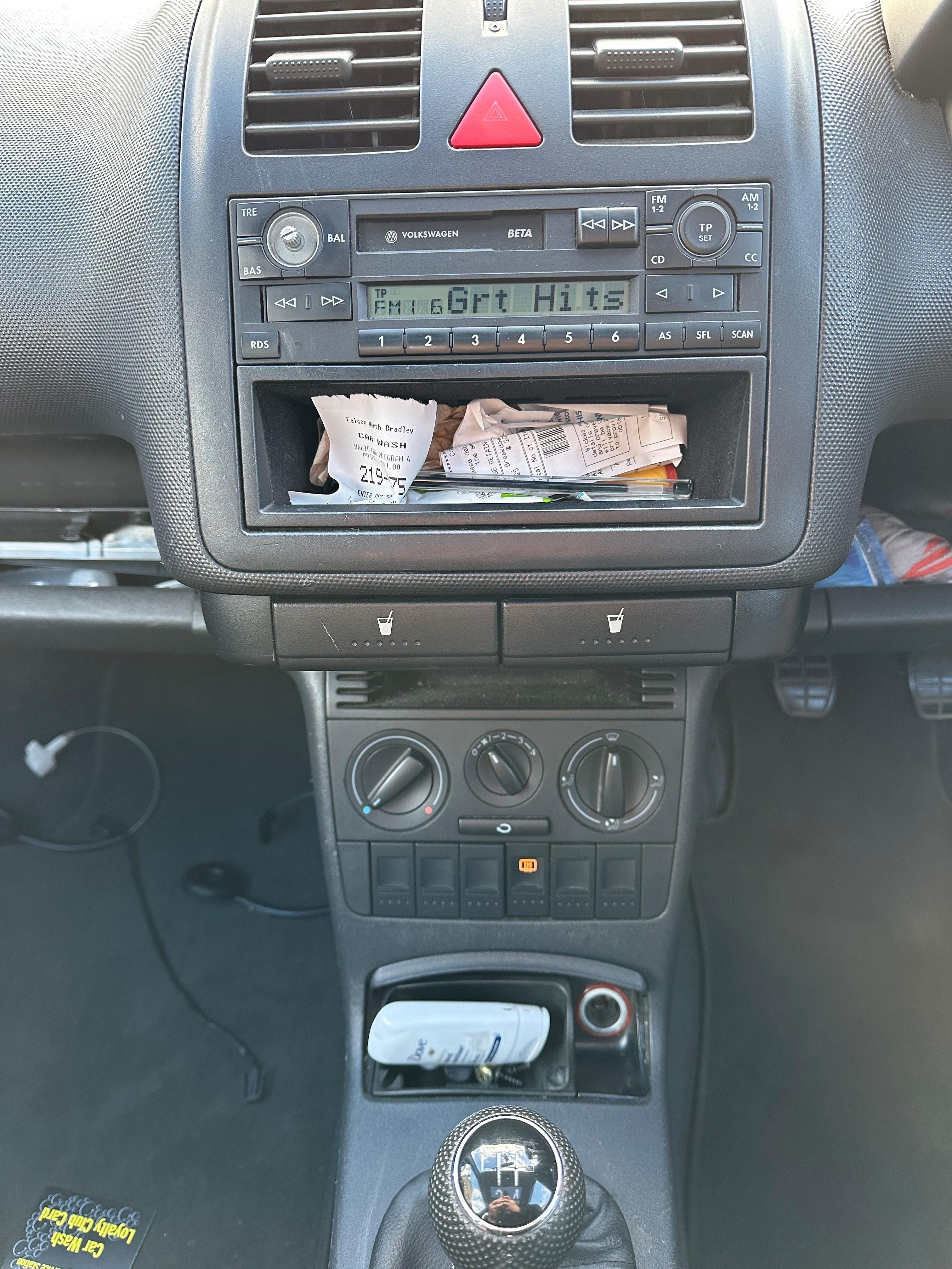

    So managed to achieve a quick few things this weekend which were never planned. Some of you will hate this but it works for me.

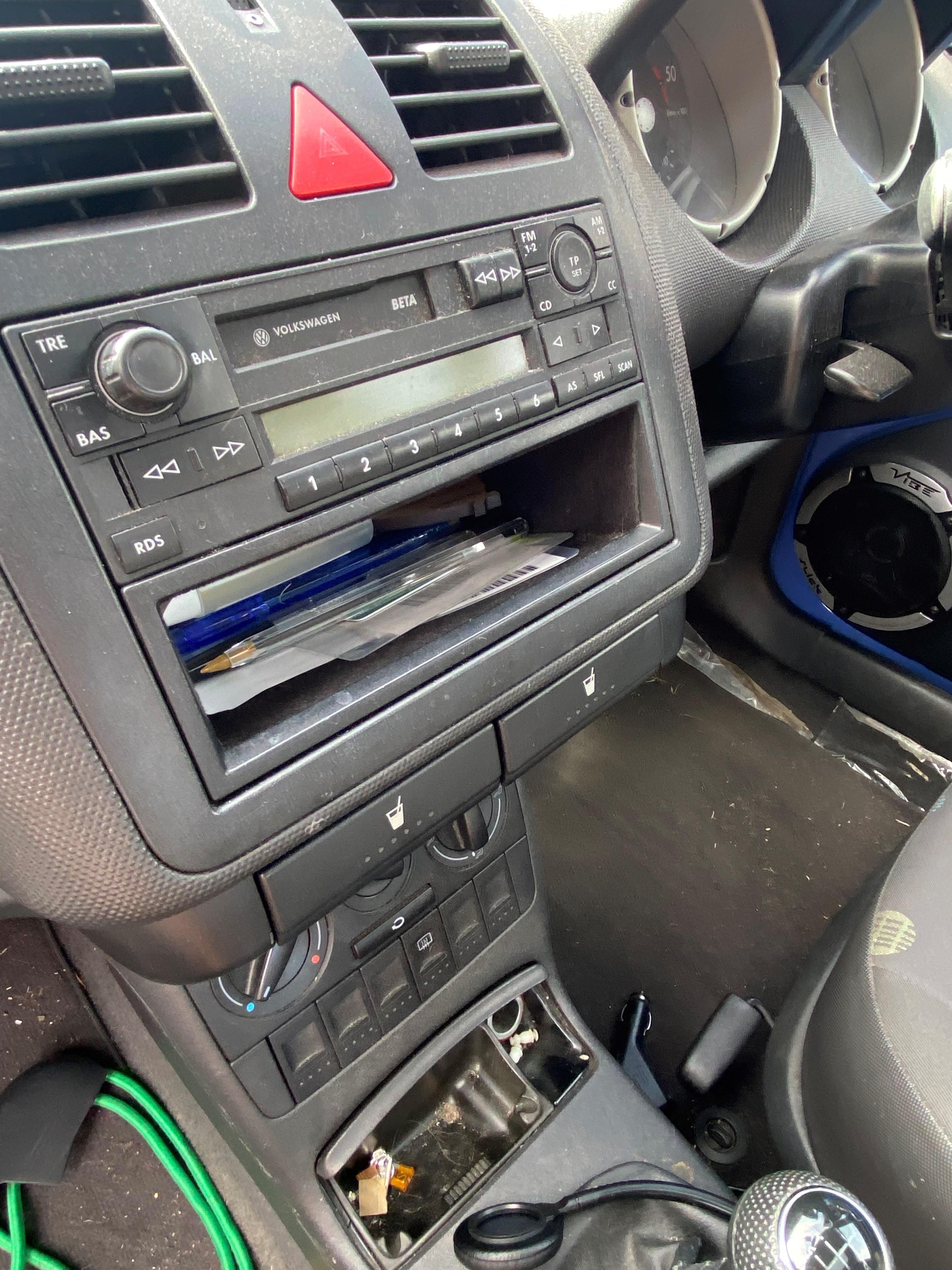

    Start with the good news first... been forever but secured a cheap cup holder so now my wife and i can enjoy a starbucks together haha! Cant believe i didnt sort this years ago!

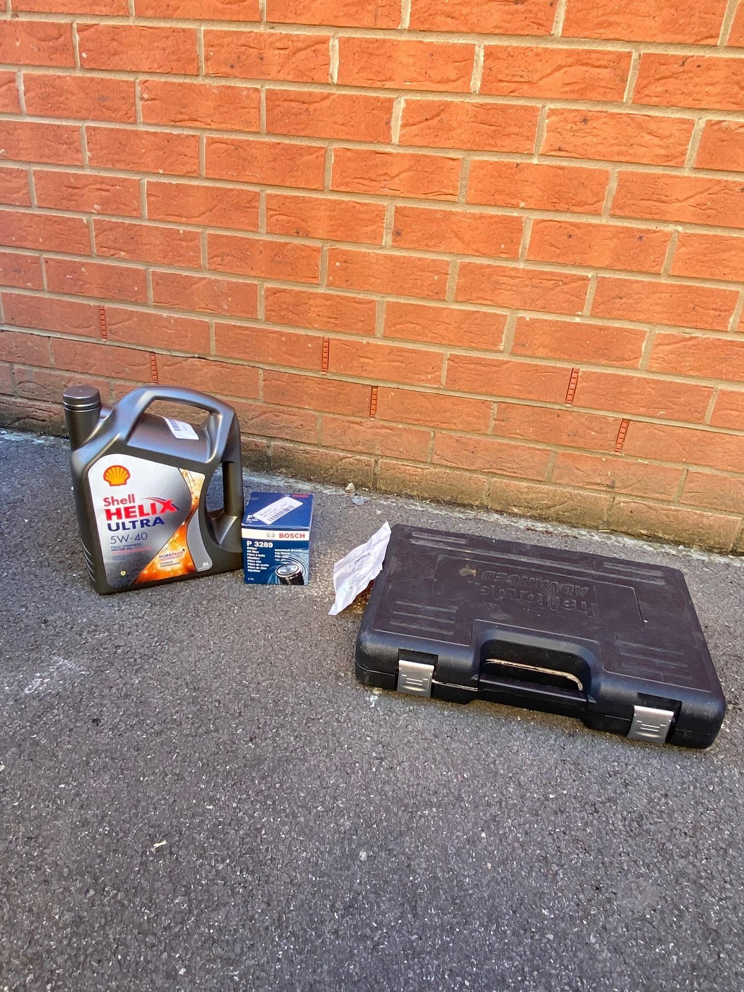

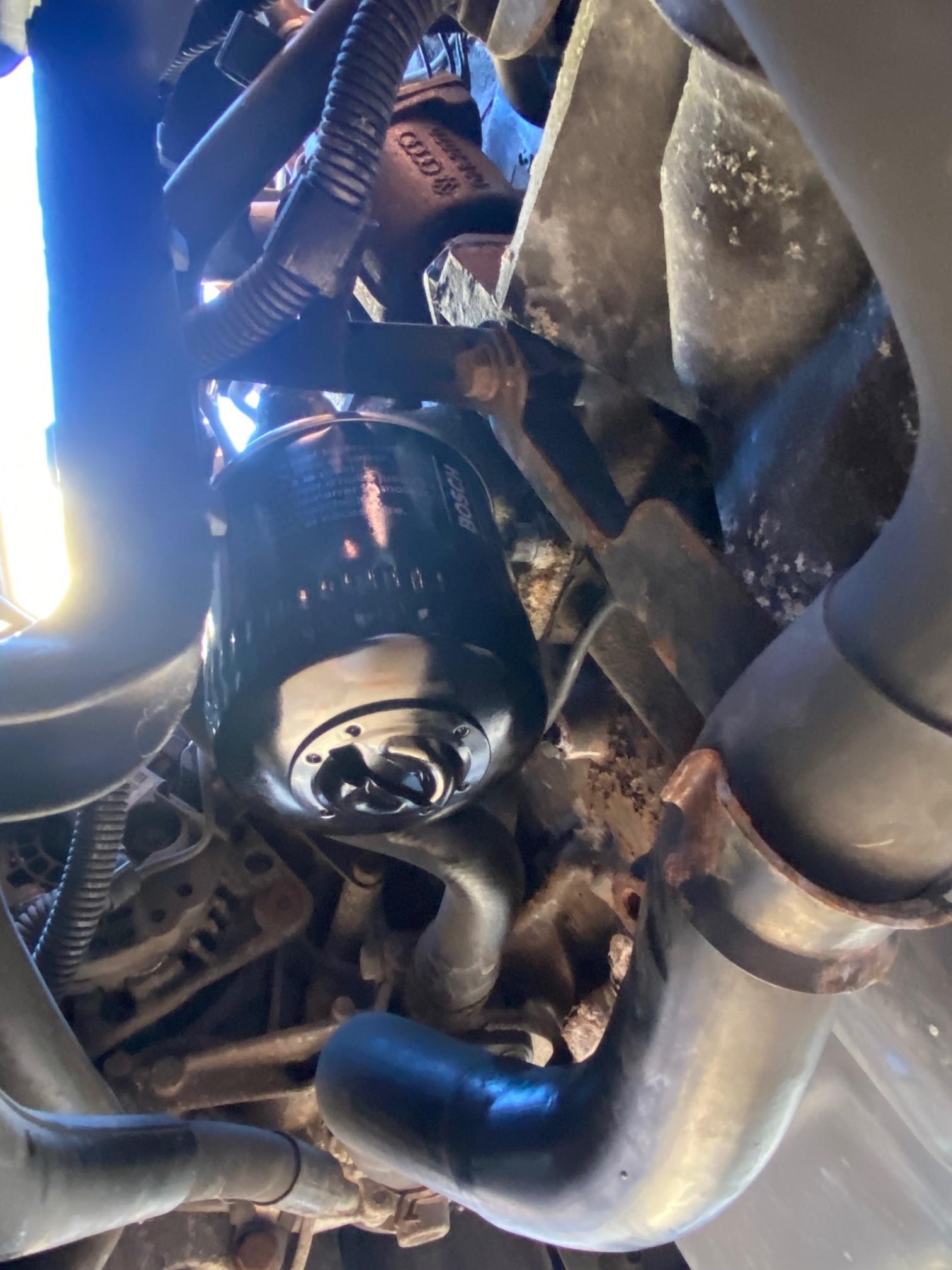

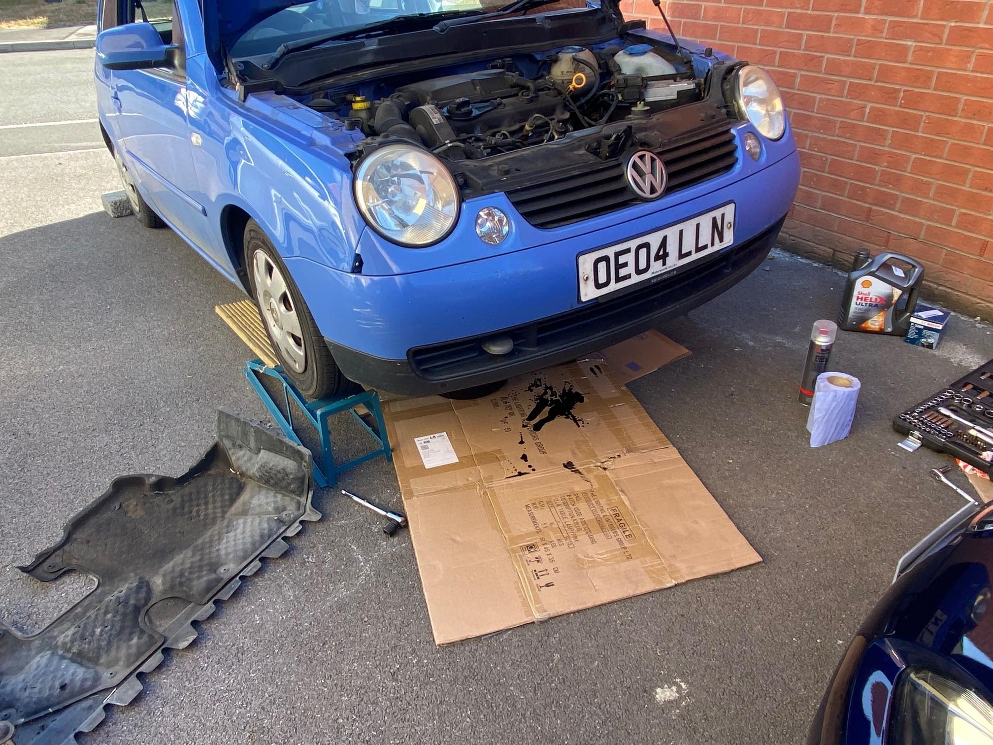

  17. UPDATE:
    Ok so another year another Oil change. Finally got around to doing it. In the process of moving house so timing has been difficult.

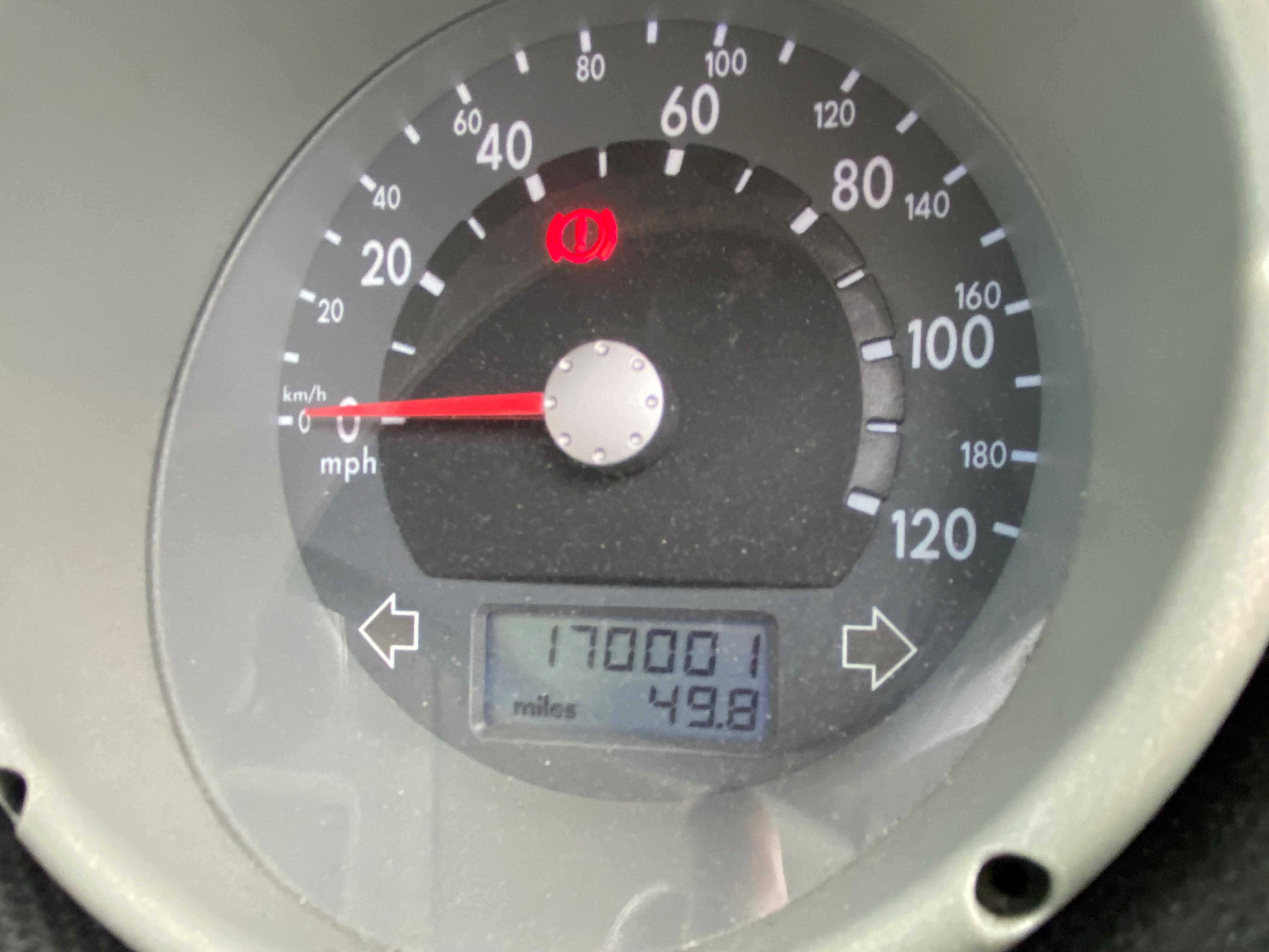

    Mileage 169,100 ish still going strong

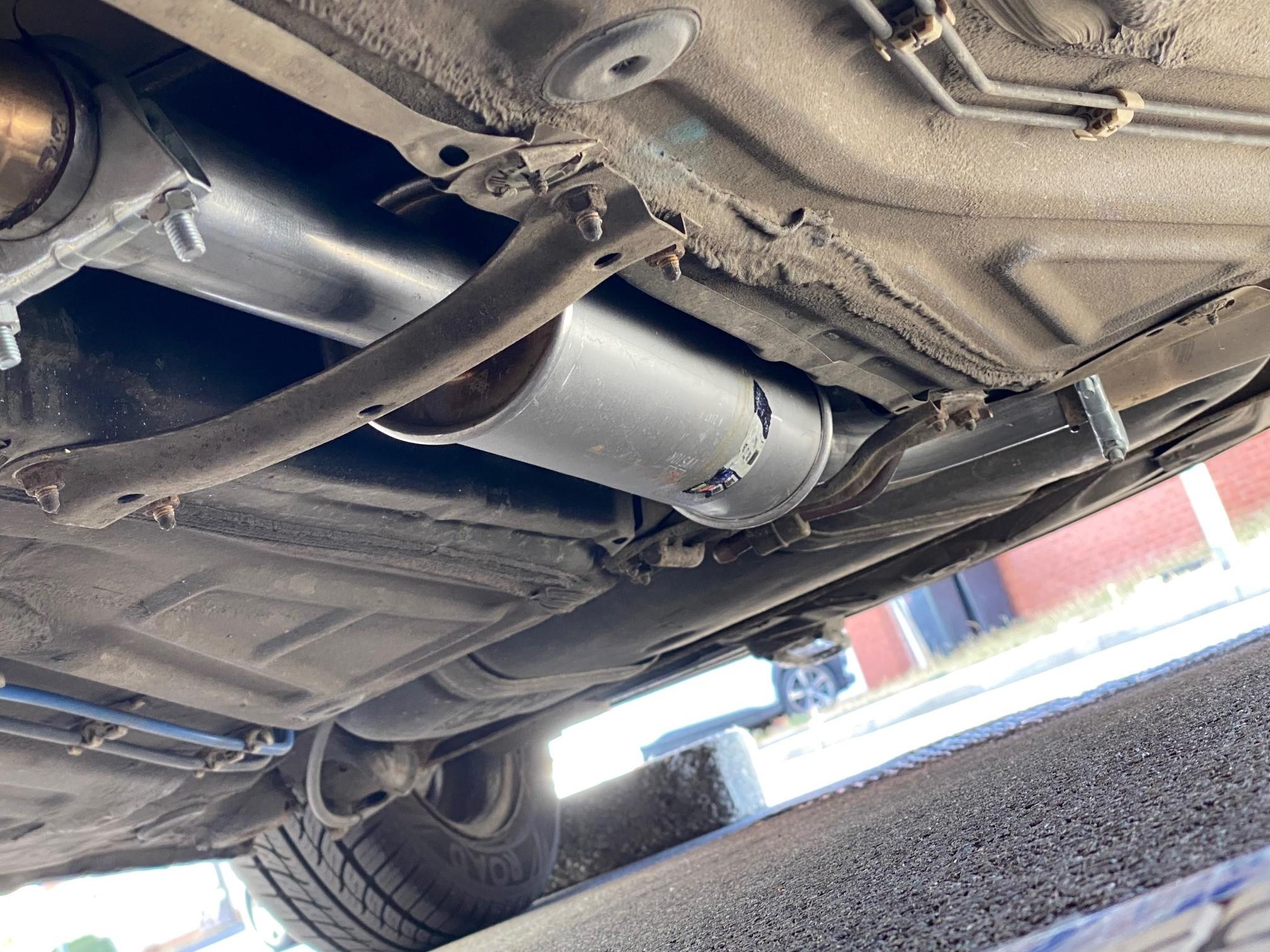

    also got a chance to look over my new exhaust from the MOT
    I did notice my coolant was low so went to top it up and the damn thing was on solid.. not even a hammer and chisel could shift it.. tried so many things to not damage it until the inevitable happened .. so i have ordered a new one and will get this one off without caring about damaging it.
    pictures below of the elite garage set up ha ha even had some new holts brake cleaner

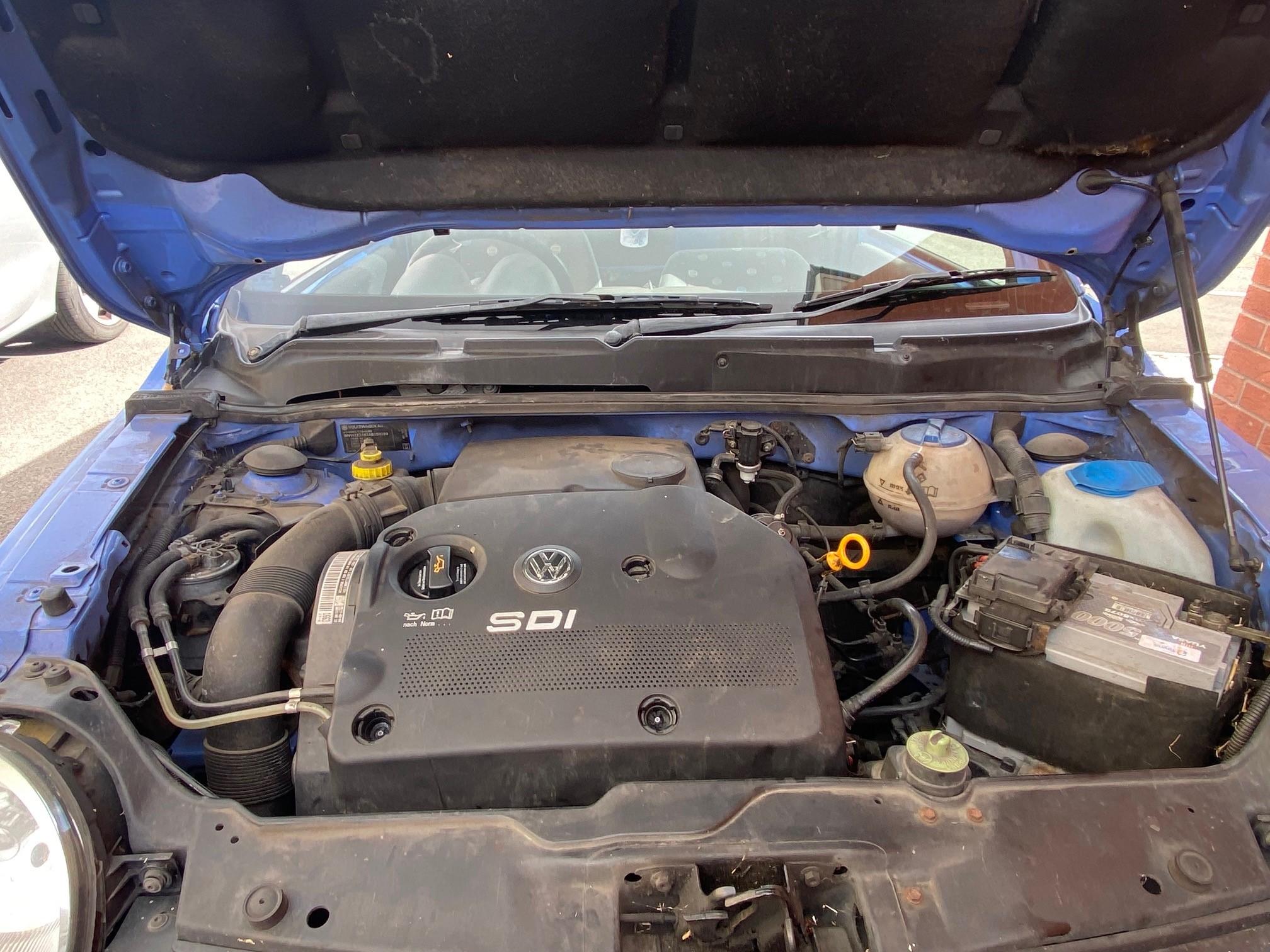

  18. On 8/17/2022 at 8:48 PM, mk2 said:
    I reckon that either your injection timing is out or the EGR is not working right.
    The exhaust "smell" should be slightly sweet, never smokey, acrid or diesel tainted (unburnt fuel). A while back, one of mine was a bit smelly, like an old diesel truck, but still passed emissions. On VCDS everything checked out just fine. But my other SDIs had a much sweeter smelling exhaust aroma. So I messed with everything, and thing that sorted it was advancing the pump "very" slightly- by perhaps only 1/2-1 degree. Now all my SDIs run and smell the same. And quieter and more economical too. Tweaking the cam timing on a TDI (3 bolts) has the exact same effect, but you can measure it on that engine.
    The official way to set up the injection timing on an SDI is by measuring the variable power value (PWM) to the advance solenoid that's mounted on the side of the pump. Use VCDS- Crap method. The old way where you insert a micrometer dial gauge into the distibution pump plunger port is way more accurate. I need to measure all of mine and get an average reading. I'll post on here the mm value at TDC if I ever get round to doing it. :)
    perhaps your right about the EGR - i wouldnt even know how to check.. pretty sure it was new or cleaned a few years back before i got the car
