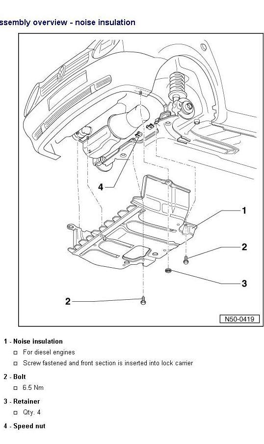

julietdiane Posted August 15 Report Share Posted August 15 (edited) Anyone knows what clips I need for under the engine splash cover. Also how to insert and remove? The plastic ones I have fitted are all mangled and I'm not sure if they are push fit or screw in type. I think, in the past, a garage fitted nonstandard rubbish. If you try to remove (pulling), they crumble. Edited August 15 by julietdiane Extra Info Quote Link to comment Share on other sites More sharing options...
mk2 Posted August 15 Report Share Posted August 15 There are zinc coated captive U nuts which clip/slide onto the subframe and wheel arch liners. The screws screw into them. The two in the centre (10mm self tapping bolts) fit into bigger captive nuts. They cost pennies, so I bought a mixed lot of 100 for my Lupos. Ebay. Quote Link to comment Share on other sites More sharing options...
julietdiane Posted August 15 Author Report Share Posted August 15 Not sure what U nuts and screws you refer to. Could you send a link of the Ebay mixed lot sale? Quote Link to comment Share on other sites More sharing options...

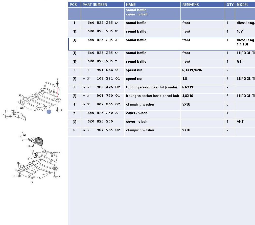

lupo 1.7sdi Posted August 17 Report Share Posted August 17 You need 90796502, 90796502, 90775001, Quote Link to comment Share on other sites More sharing options...
julietdiane Posted August 18 Author Report Share Posted August 18 Thanks. My mix up. The lugs underneath the cover are not for securing the cover to the car, but for securing the noise baffle. So, no need to remove the lugs when I take off the undertray. Quote Link to comment Share on other sites More sharing options...
