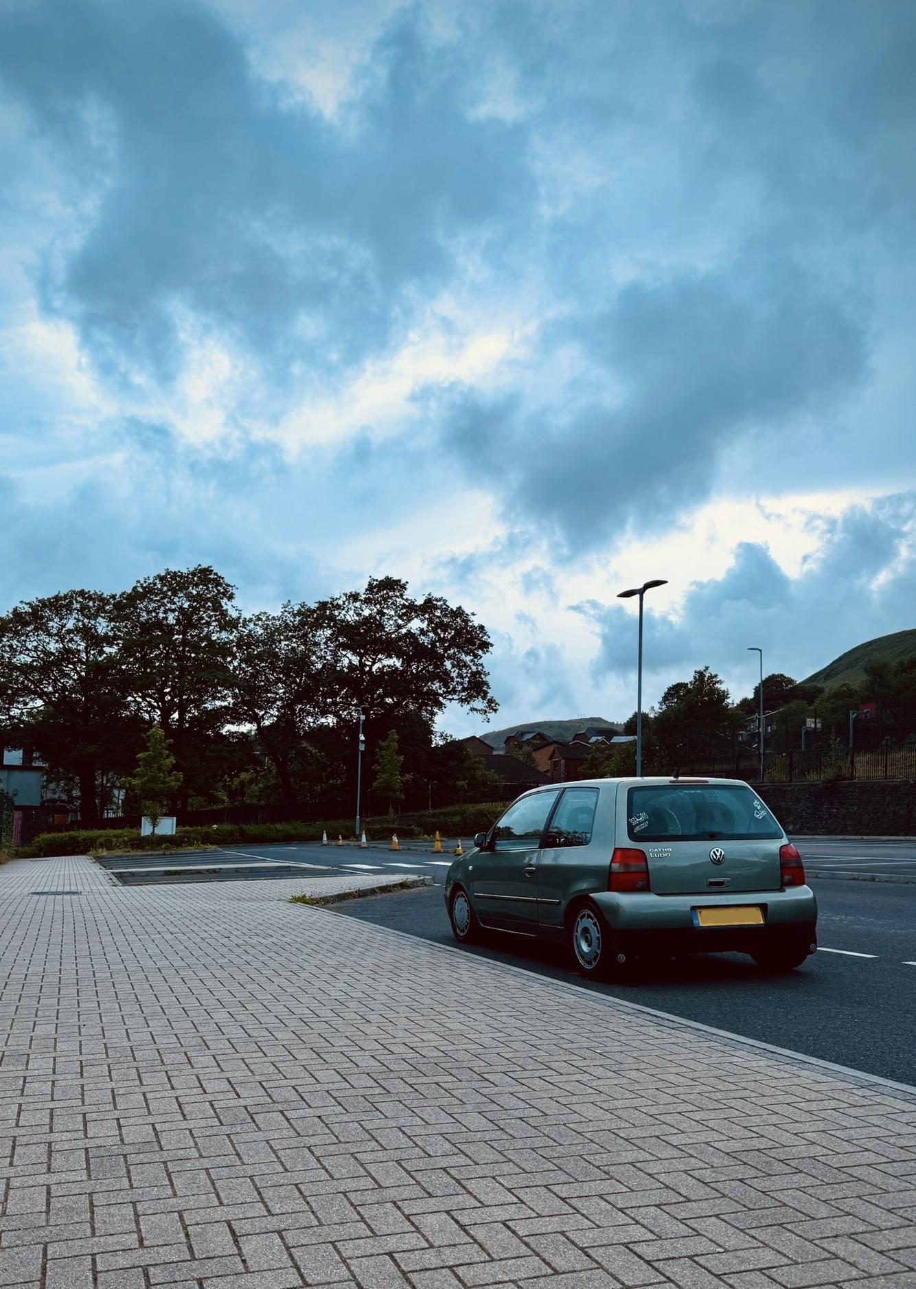

I feel a bit emotional posting this 😢
I just got a new MOT on my 2002 Lupo (only cost me £75, last year it just needed a tyre) however there were quite a few advisories, so I think it's time to sell or sell things like the Pirelli P Slots or JOM coilovers etc.

I don't actually drive much being a remote worker and living somewhere all the supermarkets deliver, so it's been parked up a lot (live in Wales, hence the corrosion from all the rain). I'm guessing it's one of the oldest Lupo's around now, and I have absolutely LOVED it. It's always been so fun to drive and has been incredibly economical over the years, I really am going to miss it.
How did you all cope with losing yours? Do you have any advice? What did you get afterwards? Am I the only one who got emotionally attached to theirs 😅
