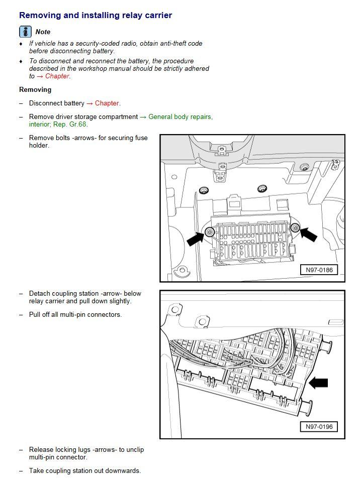

peterstanding Posted August 17 Author Report Share Posted August 17 how is it possible to remove the 410 relay there is not enough room to get my hand in there so i can get it out and get a new one in Quote Link to comment Share on other sites More sharing options...

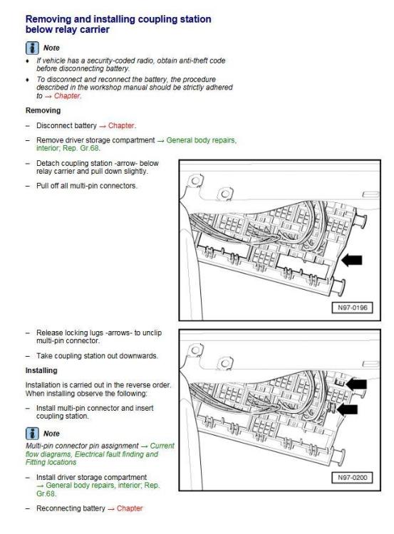

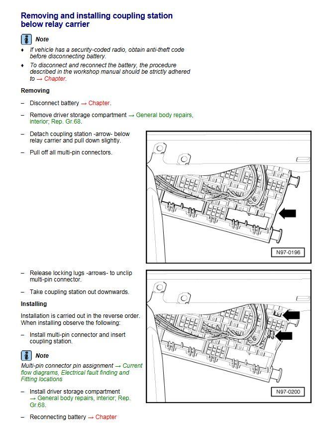

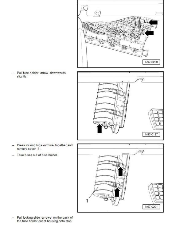

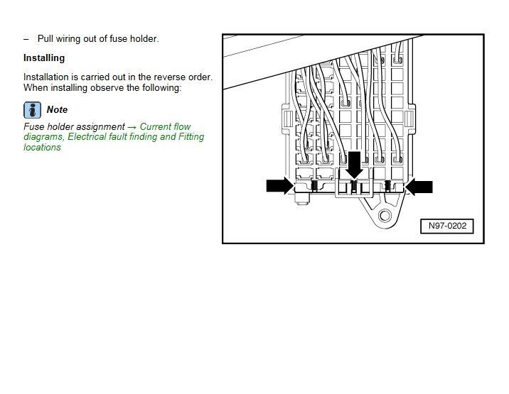

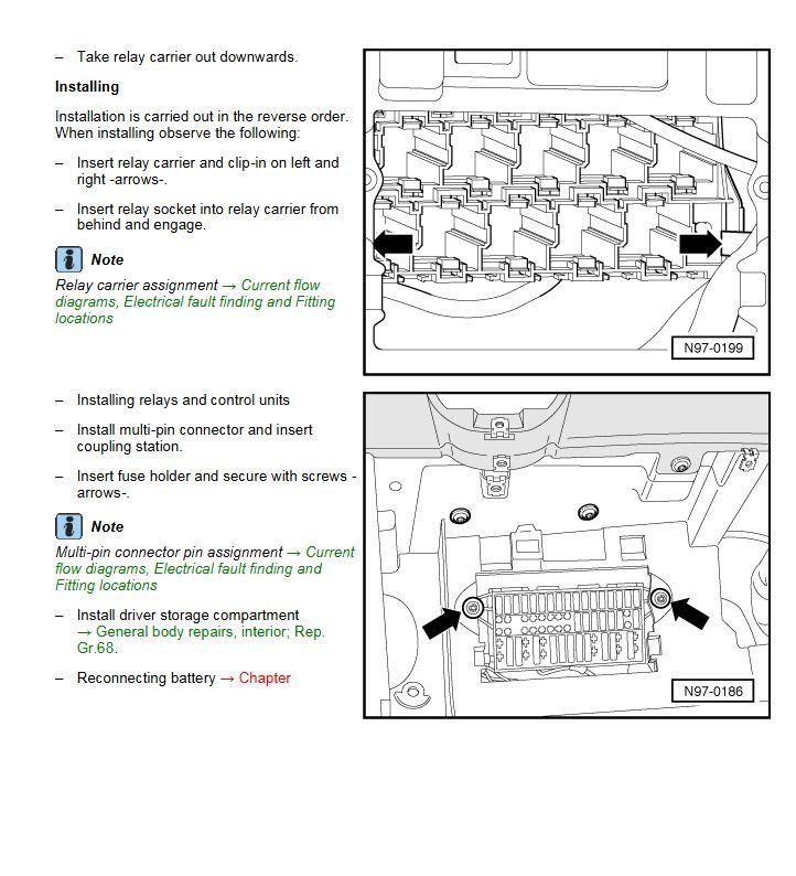

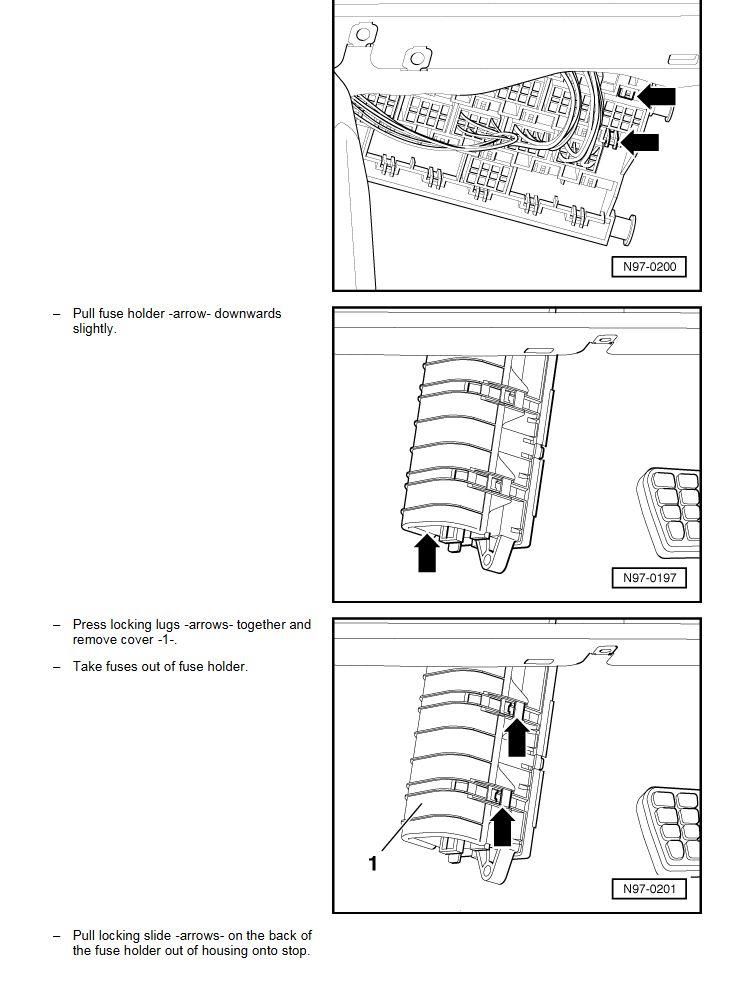

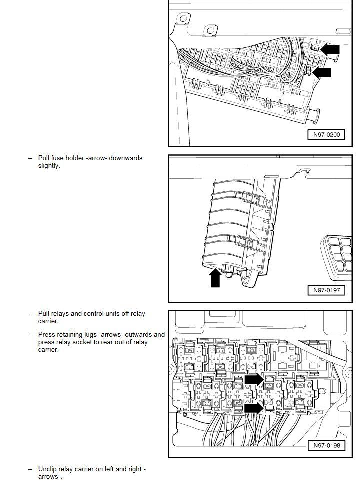

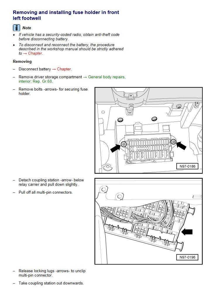

lupo 1.7sdi Posted August 17 Report Share Posted August 17 If you want to change the pump relay below you have some guidelines. You need a pdf reader. It is quite difficult, but not impossible. 3-Removing and installing fuse holder in front left footwell.pdf2-Removing and installing coupling station below relay carrier.pdf1-Removing and installing relay carrier.pdf Quote Link to comment Share on other sites More sharing options...

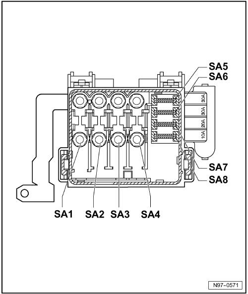

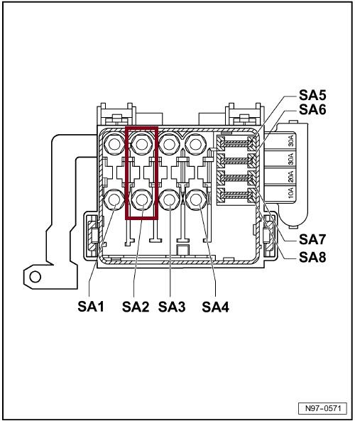

lupo 1.7sdi Posted August 18 Report Share Posted August 18 (edited) There is a small box on the battery at the positive terminal. Under that cover are some fuses in the form of blades. Below you have all the fuses Fuse.pdf Edited August 18 by lupo 1.7sdi Quote Link to comment Share on other sites More sharing options...
peterstanding Posted August 18 Author Report Share Posted August 18 mine has sa1 and sa2 but where is the actual fuse? as it appears to be a nut and wire Quote Link to comment Share on other sites More sharing options...
lupo 1.7sdi Posted August 18 Report Share Posted August 18 The number of fuses depends on the model and features. I have circled the fuse in the picture. In the post above I added a document with all the fuses Fuse.pdf Quote Link to comment Share on other sites More sharing options...
